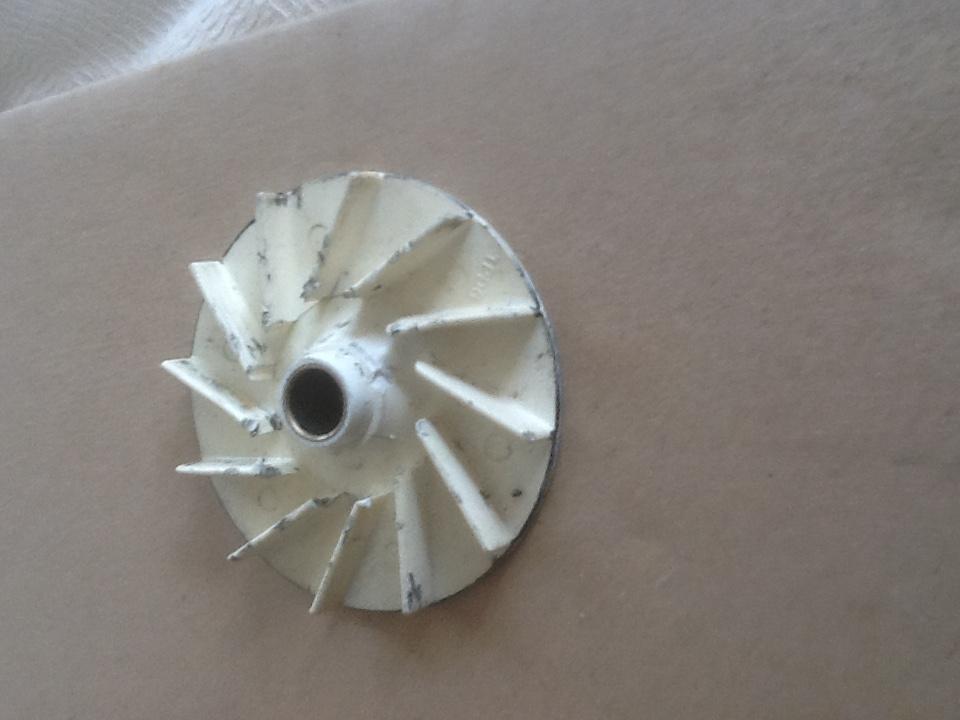

So,
I've attempted several times now to make a replacement cooling fan for my drill that I'm refurbishing....(in fact I have somewhat of a collection now amounting to around 18 of them...different models of course...)
The last effort resulted in me missing an index point on the rt and resulting yet another failure...
So I'm thinking, a metal mold machined frim aluminium, with slots cut and a recess bored for a boss to cast a fan using some form of plastic or fibreglass/resin compound...
I need the process to be repeatable as I need six of these fans..... :scratch:
Any thoughts on a suitable casting material?

« Reply #5 on: June 18, 2016, 11:48:44 AM »
'K  had another go on the mill with one more of me blank disc....
Got all the blades cut nicely, just had to clear out 'bits' in between.....swapped to a smaller cutter (3mm) going nicely when'crack' another one broken....So more scrap perspex...,
I've realised what I'm doing wrong here I think.....
As I approach the edge of the disk, the cutter seems to be forcing the disc down...Now its only supported in the centre on the mandrel I made for it...so I think it needs a disc of the same diameter at least to offer support to the edges.... :scratch:
Is my theory flawed in some way or should I just go back to the nursing home?  :lol:
Anyway here's a foto of what I need to make.....
« Last Edit: June 18, 2016, 12:28:20 PM by John Rudd »

« Reply #7 on: June 18, 2016, 02:34:38 PM »
Make a cut, put in a backer piece.  Continue until all blades are cut.
or
Get a 3d printer  :wave:
  • Posts: 2558
Re: Fan
« Reply #8 on: June 18, 2016, 03:04:00 PM »
Care to elabborate please? Pictures are good :lol:
Offline efrench
  • Posts: 218
Re: Fan
« Reply #9 on: June 18, 2016, 05:15:06 PM »
http://img.photobucket.com/albums/v649/etfrench/Misc/fanMill_zpsghodsu3o.jpgFan

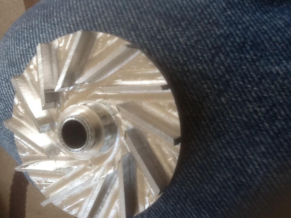

Got a bit more done today....one new fan machined from solid....a lot of hard work.... :doh:
Sadly I'm inclined to discard this one, making them out of metal is just too heavy....
Anyone seen any fibreglass filled resin that I can mix with hardner and mold into a fan?

  • Posts: 9133
Re: Fan
« Reply #13 on: June 20, 2016, 12:34:36 PM »
In the absence of a 3D printer my approach would be to glue up the original, or your best copy, fettle it to a good finish with car bodywork filler, and take an impression in Vynamold :
http://www.mbfg.co.uk/vinamold.html
Release from Vynamold and pour in resin of your choice, no doubt with a filler added.
If you form a decently thick edge to your Vynamold it will hold it's form yet be flexible enough to release the pattern. I still have a few vynamold forms I made over ten years ago and they would be fine for resin casting even now.

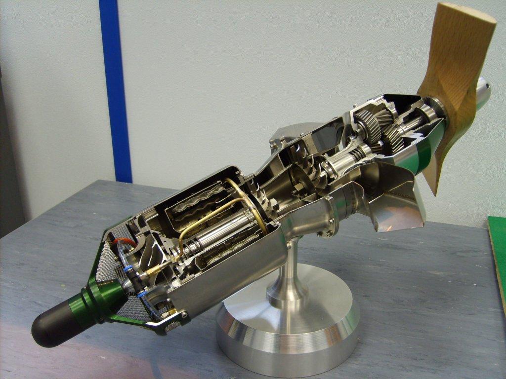

Offline RotarySMP
  • Posts: 464
Re: Fan
« Reply #16 on: June 22, 2016, 09:17:03 AM »
Wow Joules. Do you have a thread somewhere with more info and photos of making that turboprop?
Mark
Mark
  • Posts: 1321
Re: Fan
« Reply #17 on: June 22, 2016, 10:05:26 AM »
Sorry Mark, it was a commercial unit.  I was fortunate enough to have the opportunity to work for the UK outfit that builds miniature gas turbines.  My favourite engines where the gas generators used in the turboprop and helicopter variants.
  • Posts: 2558
Re: Fan
« Reply #18 on: June 22, 2016, 11:46:50 AM »
Joules,
Would that have been Wren Turbines ?
