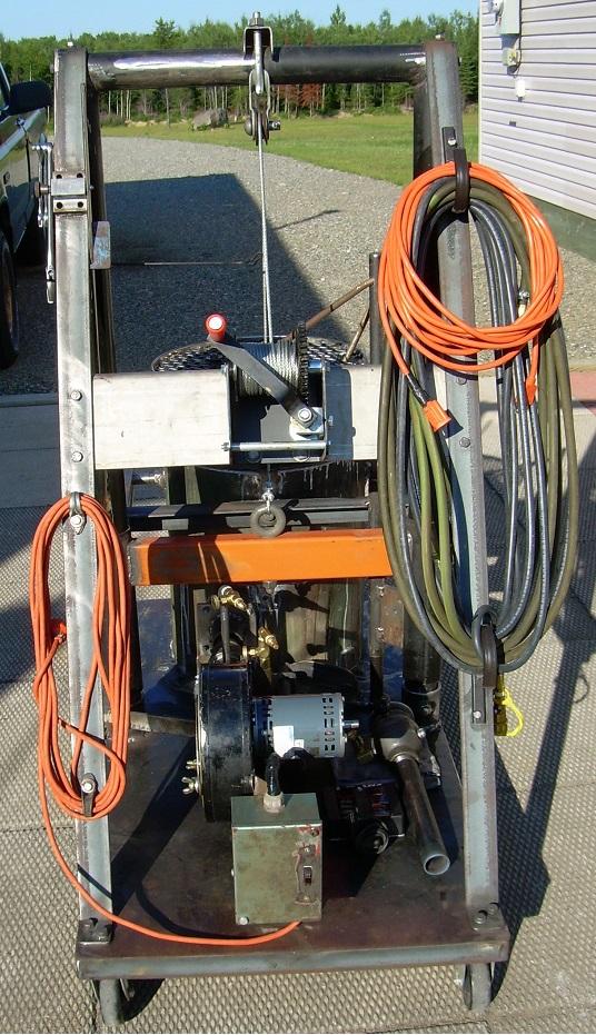

Don't know if I mentioned it before but 30 some odd years ago I built Gingery's Lil-Bertha and did some casting. In the first pic. from left is a sander table I cast some obvious beginner problems but it held up longer than the sander. An unused steel crucible still kicking around, some moulding stuff, a set of screw drivers I cast, not recomended for electrical work but indestructable in the shop, plan on casting some more. The black handled srewdriver is like the one I used for a pattern. And on the end a mold rammer still kicking around.

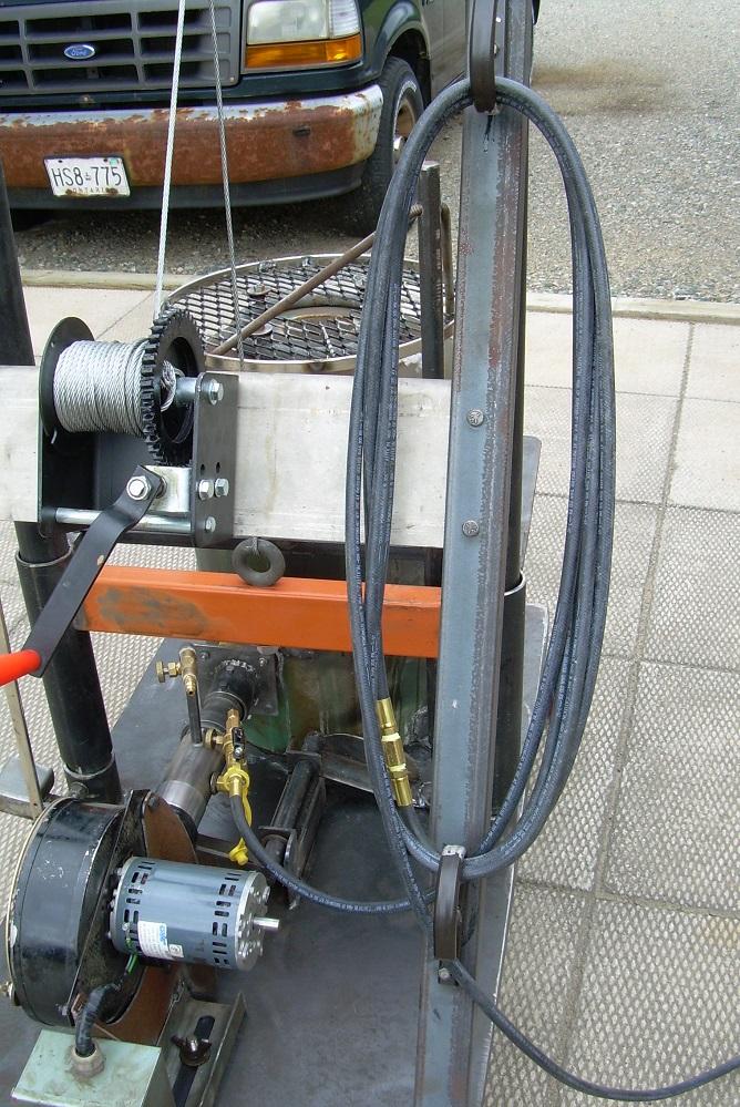

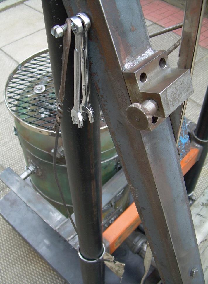

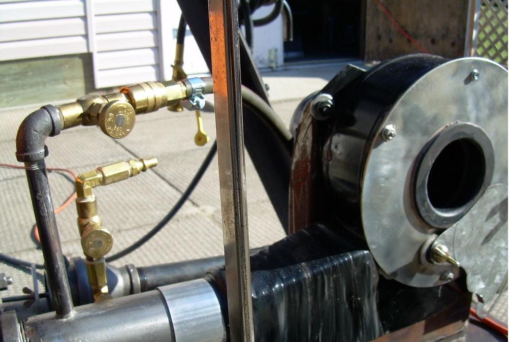

The next 2 pic.'s are a couple conveniences I added to the frame today a peg to hang my burner wrenches and lighting wand and hooks to store propane and oil hose.

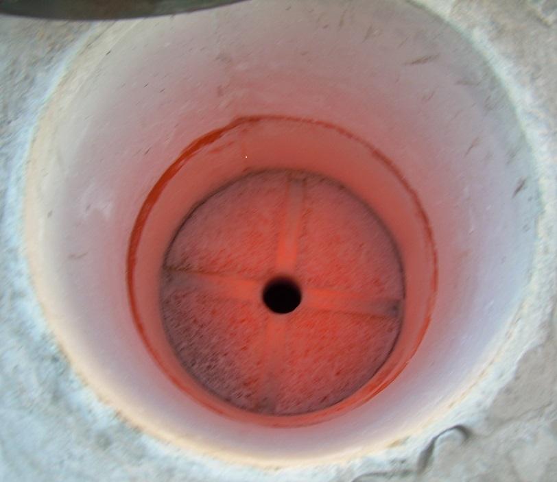

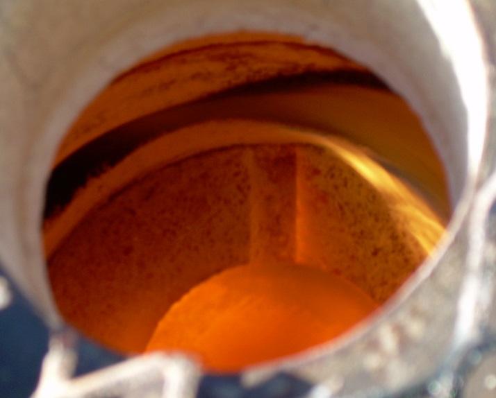

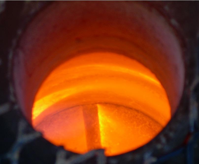

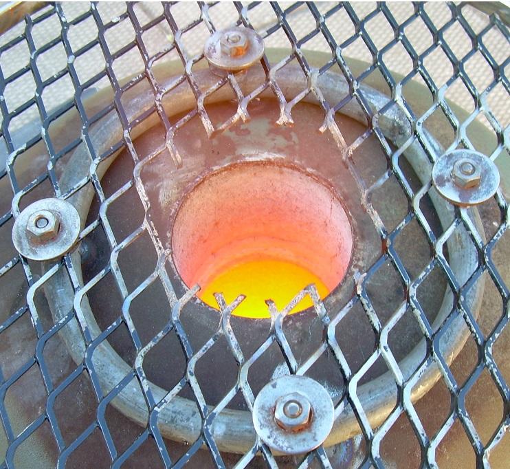

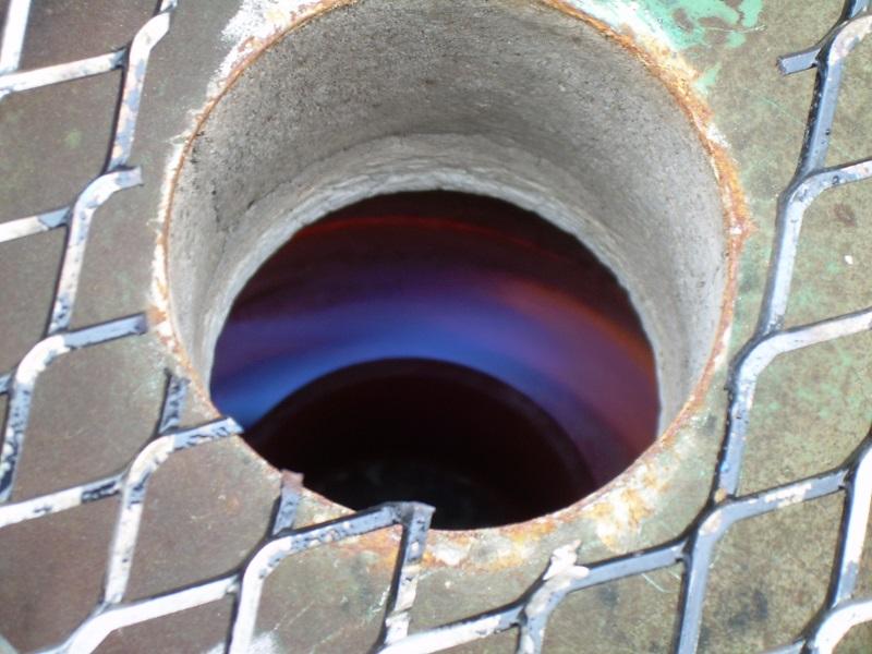

The next 3 pic.'s are the second heat today. Got to less than 1/4 on the fan damper before the crucible reached orange heat. Backed off and held for another 5 minutes before shutting down. I don't think having enough air to burn oil is going to be a problem.  :D Sorry about that last pic. trying to focus on the crucible.

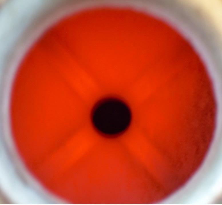

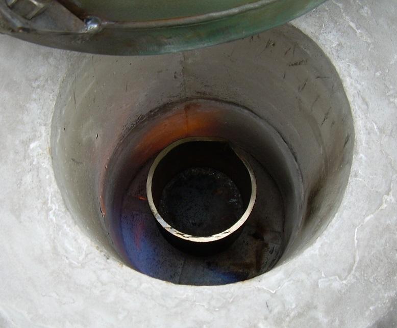

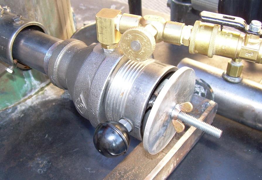

Expected a slow day watching fire in the furnace, not going to happen. Decided to try the atmospheric burner in the morning heat. It lit but insisted on burning well down the pipe. No adjustments I made would get it out of the pipe. Tried it on the vise, good there. Removed Asian welded burner pipe and filed down the weld ridge down the middle of the pipe, tried in furnace, no go :bang:.Because of furnace back pressure the venturi effect of the reducer was not generating enough velocity to overcome the flame advance. My jet was 3/4" from pipe inlet, Rupert Wenig's was 5/8" but some of R. Reil's were as much as the full length of the reducer 1 3/4" :coffee:. I removed the T and jet and went with a straight pipe with a #53 jet drilled in it. After some fiddling to center it down the burner pipe, distance to burner pipe now 1 1/4". Lit on first try and did not retreat into the pipe as I ramped it up. :D

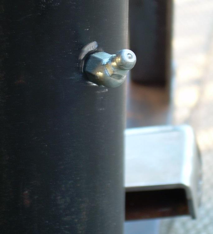

Installed 2 grease fittings on the main lift slides.
The rest of the pictures are my evening heat with the atmospheric burner. Moisture is all gone, developed a few small cracks. If or as they get worse an occasional application of vesuvious should keep it in repair. Included the second last pic. just for the rich color. This was just before I shut it down.
CB

« Reply #78 on: July 30, 2016, 08:51:21 AM »
I'd just like to point out that you will almost inevitably have cracking, it's the nature of the beast, a rigid material heated unevenly is probably going to crack, hopefully fine hairline cracks! i wouldn't worry about it!

Yes Matthew have to look close to find few hairlines in hotface. More obvious in fireclay mix in lid. The support installed in the lid should hold things together and the occasional morter application will hopefully prevent any crumbling.

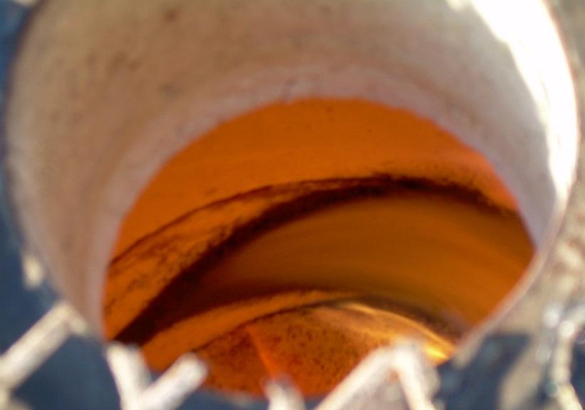

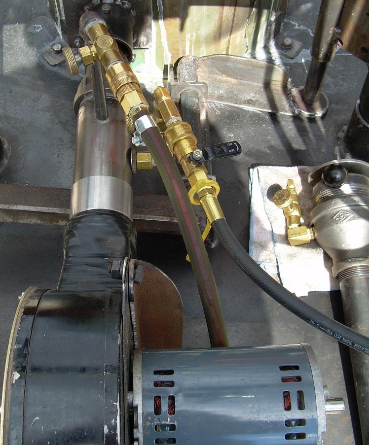

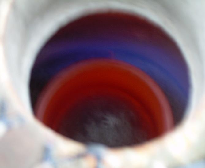

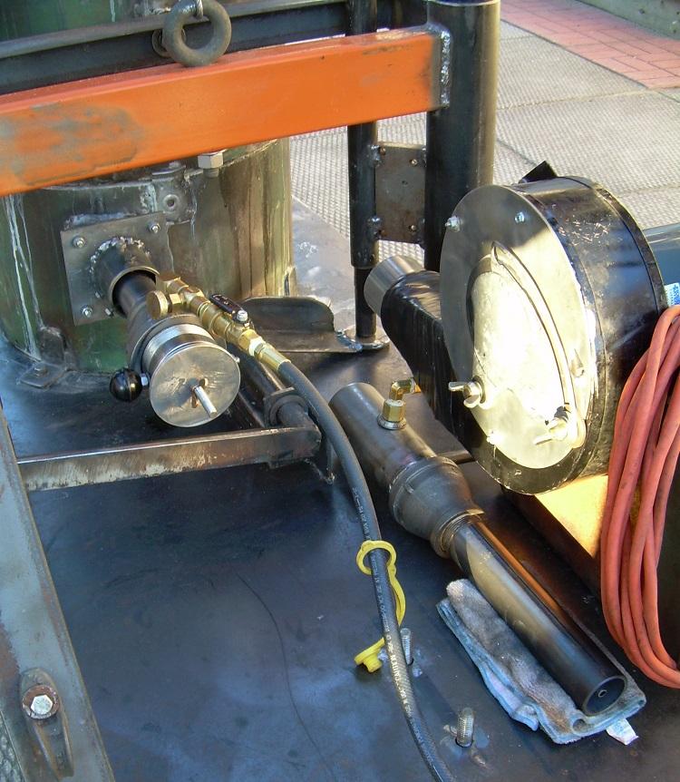

Decided to try oil before the paint goes on. Filled oil tank and hung with hose and heater installed, temp. increased from 82* to 104* in about 1 1/2 hrs. Second picture is the burner set-up. Fired up on gas to preheat, when the plith started to glow I cracked open the oil and gave it more air. Over the course of 20 minutes slowly increased oil, reduced gas and increased air. In the third picture the oil is wide open the gas is disconnected and the fan damper is wide open.
The next 3 pictures are with the burner on just oil. Hard to get good pic's the heat exiting the top is tremendous. You can see the oil spray hitting along the wall vapourizing and burning. Burned clean except for a little smoke between the bottom 2 sections. The gasket I talked about earlier and an adjustment of the gun in the burner port should cure this. The last picture is the furnace packed up and ready to move indoors for the night.
Quite happy with the results, with a little more use I should be able to fine tune air-oil ratios and bring it up on oil quicker.

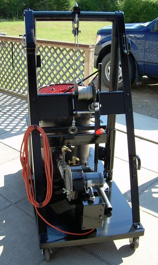

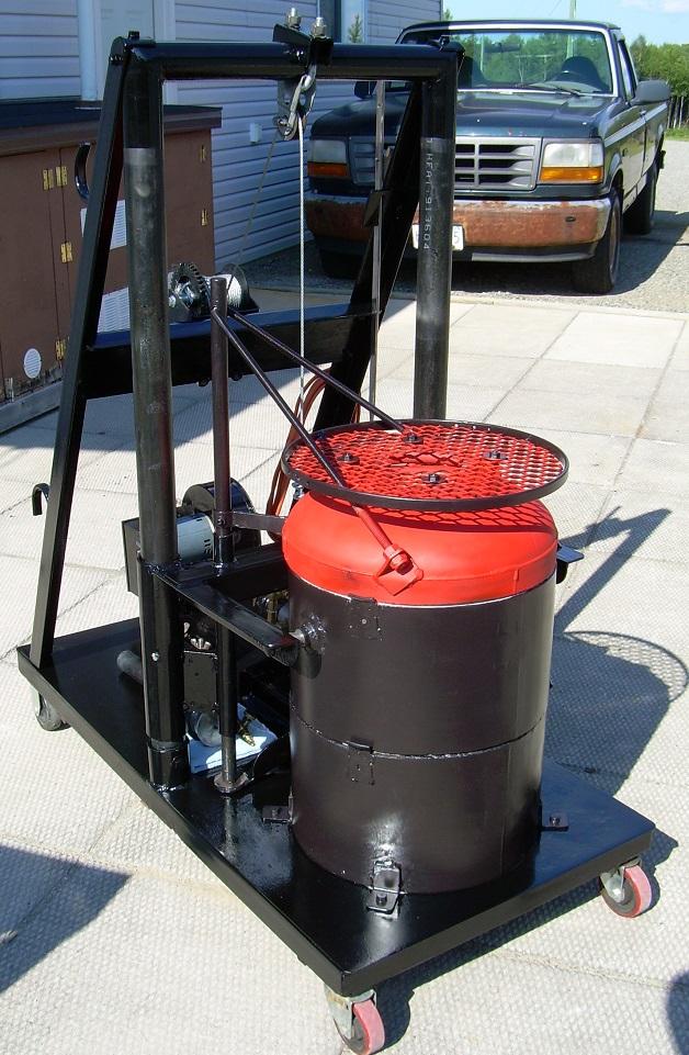

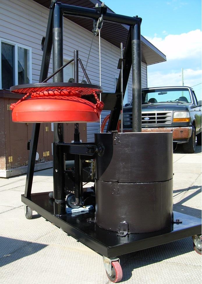

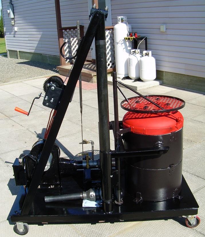

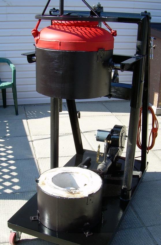

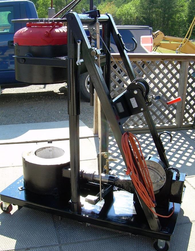

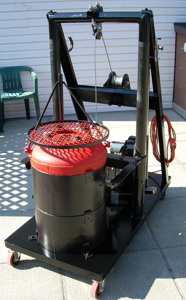

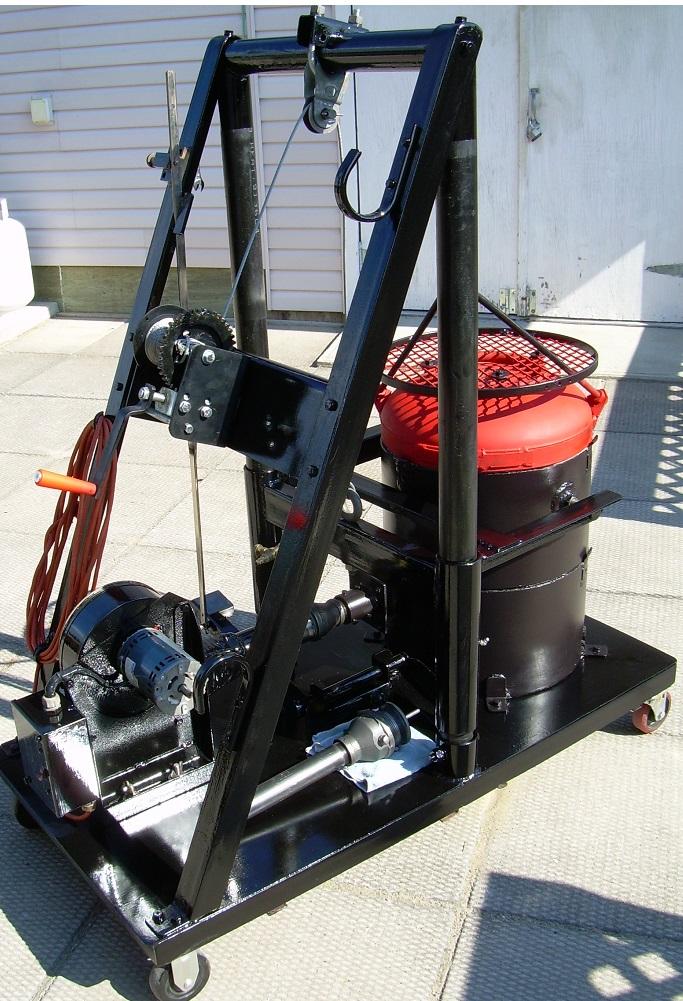

Guess it's time for the centerfold pictures. Don't see any further changes so I painted the furnace assembly. The frame assembly is Armour Coat gloss rust paint, the furnace shell is Tremclad high heat flat black and the lid is half a spray can of flame resistant paint I had kicking around. If it's actually flame resistant I'll get another can and give it another coat.
Cheers :beer:

Wonderful,CB, just wonderful  :clap: :clap: A really nicely documented method of making a very professional home furnace. Look forward to seeing some melts come out of her.
Coincidently I was watching John 'Doubleboost's' channel last night on casting brass name plates and his use of sodium silicate sand to ensure the detail being preserved in the mold.This led me to a couple of other videos showing how to make your own sodium silicate from sodium hydroxide and silica gel.
All really interesting and useful stuff to know......OZ.

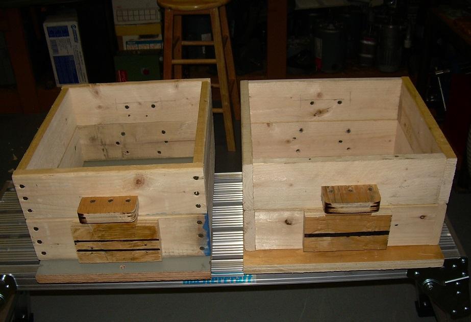

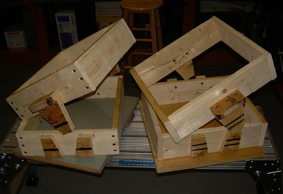

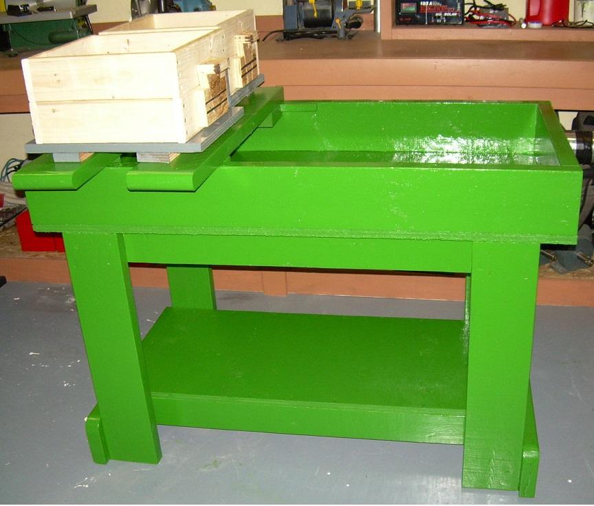

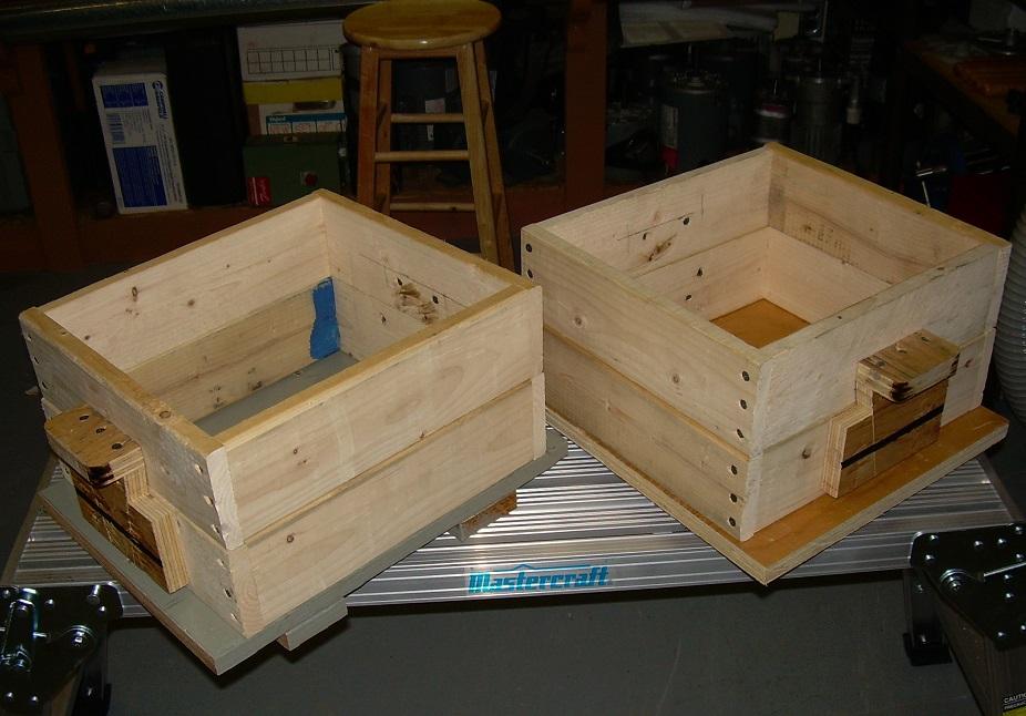

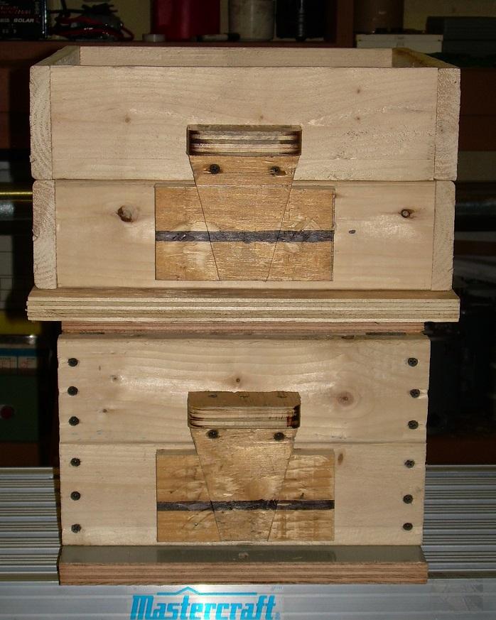

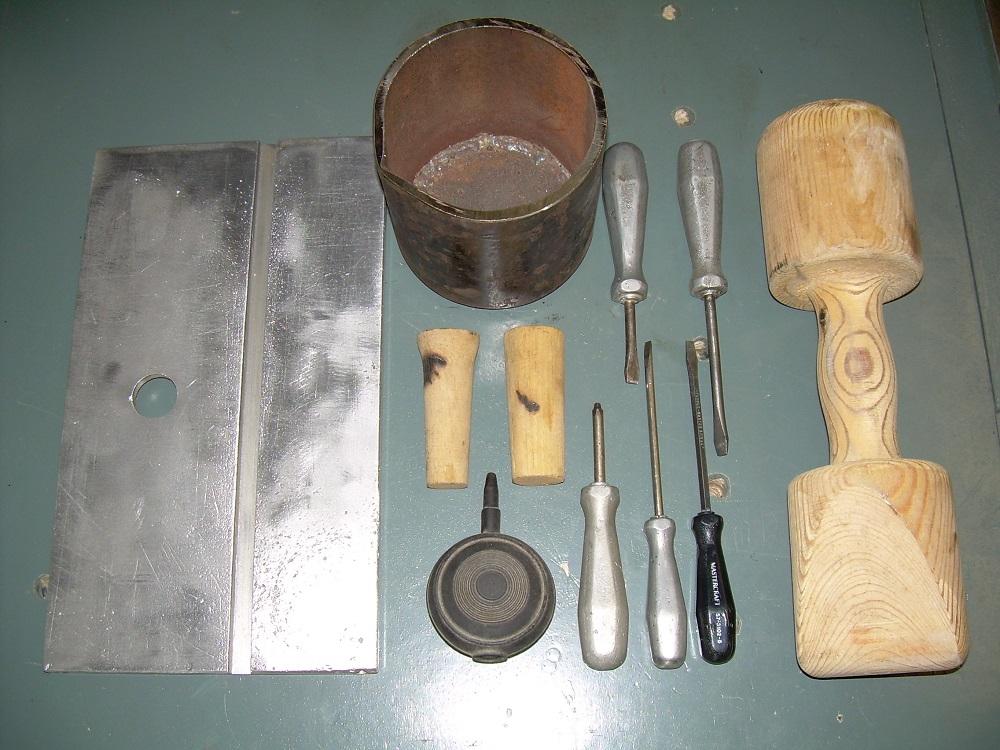

Made a couple of molding flasks and bottom boards today. Nothing special just 2 light wieght 12" x 13" flasks to get me started.
CB

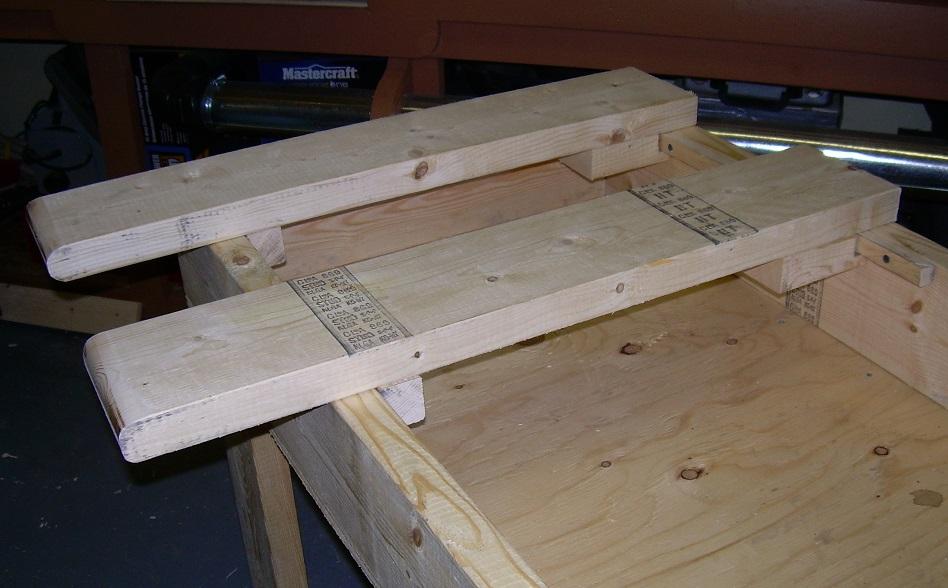

Hello Tom, Yes when I built my garage/workshop I completed the shell and exterior I purchased OSB board and insulation to complete the interior. The OSB board got used on an extention to store firewood and materials and the insulation is still waiting to be installed. Oh well maybe next summer.

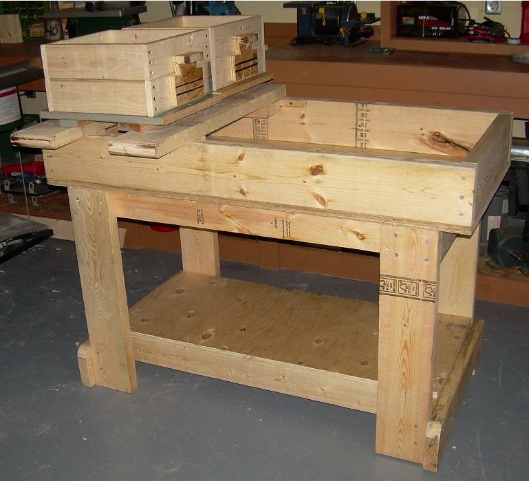

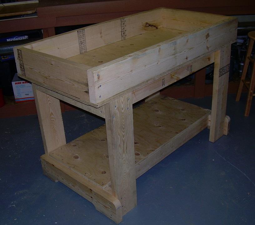

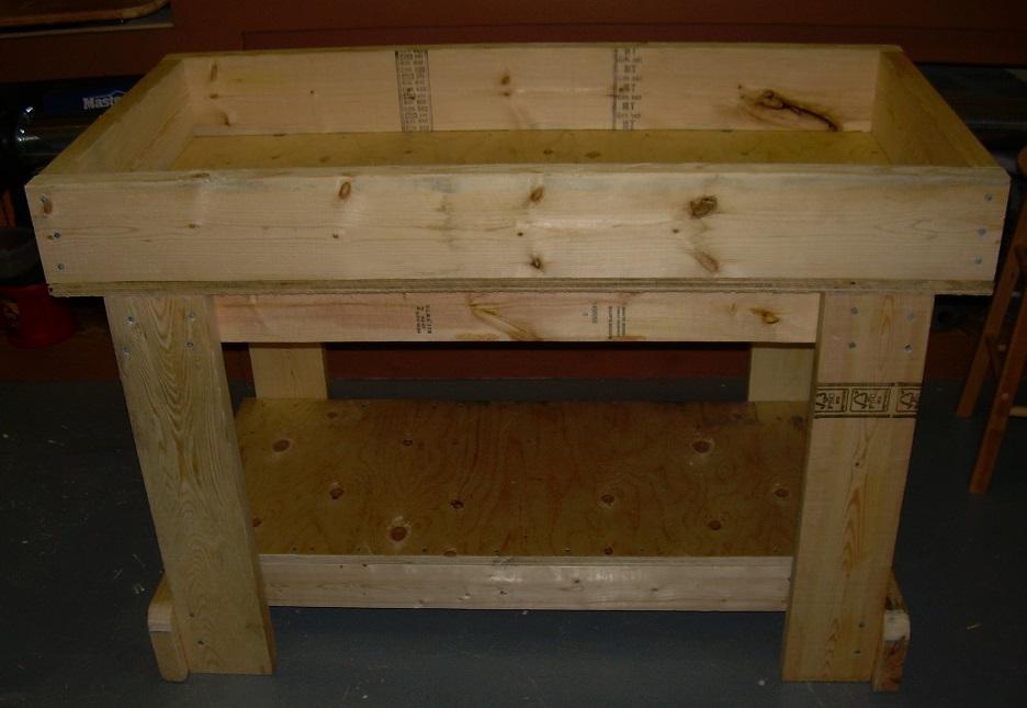

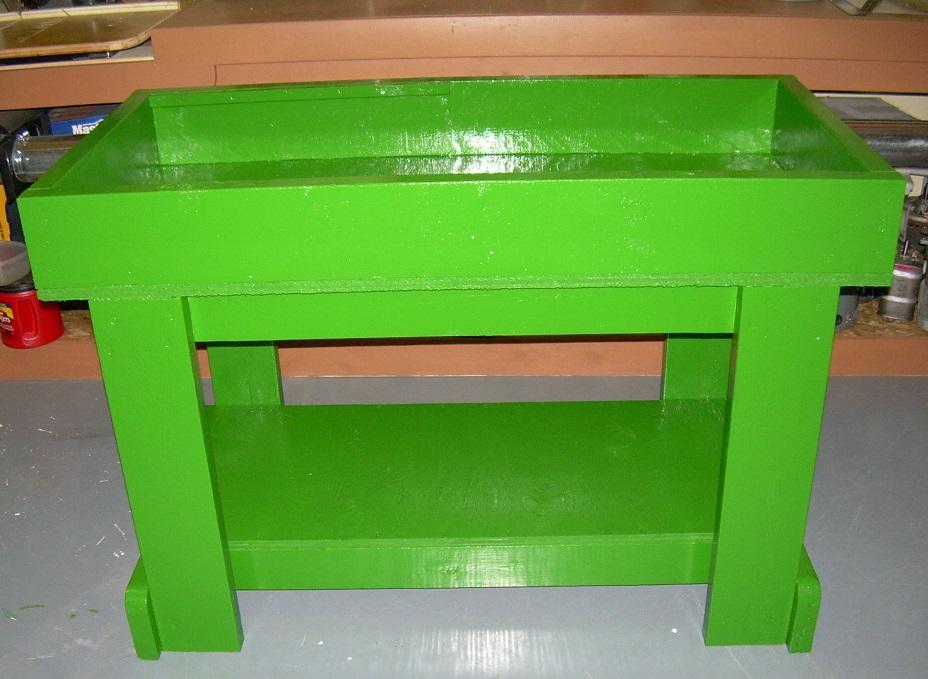

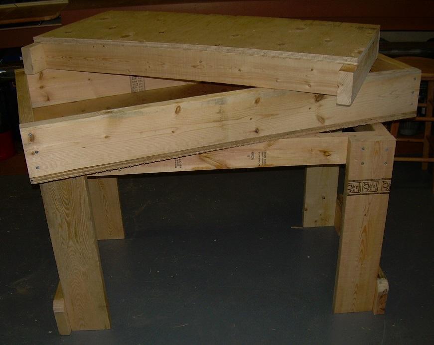

Well you can't make molds without a molding bench, Ha Ha well you can but its a pain. Not alot of finess here its made from constuction grade lumber but its very heavy and very sturdy. The bin will hold over 200 lbs of molding sand and the shelf can store 7, 5 gallon pails for another 300+ lbs. The roll bars slide out for access to the whole bin. 2 coats of Tremclad enamel and its ready for use.
CB

I'm planning on osb for the interior as well.
Your going all out do you mix the sand by hand or is their a muller in the works? I like the bench one that Tubalcain has on his molding bench or Ironmans its bigger but done in one shot!

I will be mixing my sand by hand for now, if I find I am casting enough for it to be a chore then a muller would be in the works. I have 3 or 4 plans  somewhere in my files, I haven't decided Yet. I have a lot of Tubalcain's stuff so I may have that somewhere, Ironman likes his videos so I haven't seen much of his work. The polititions have all promised affordible high speed internet to rural areas but I'm still waiting :(.

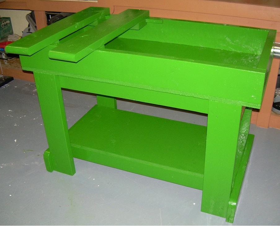

Crazy hot and humid today, it was all I could do to paint yesterday's work. Amazing what a couple coats of paint can do to less than great lumber.
CB

Golly CB, that looks too good to bung sand n stuff in.
  Great job and as for using construction lumber, Hey man, it is a work bench after all.

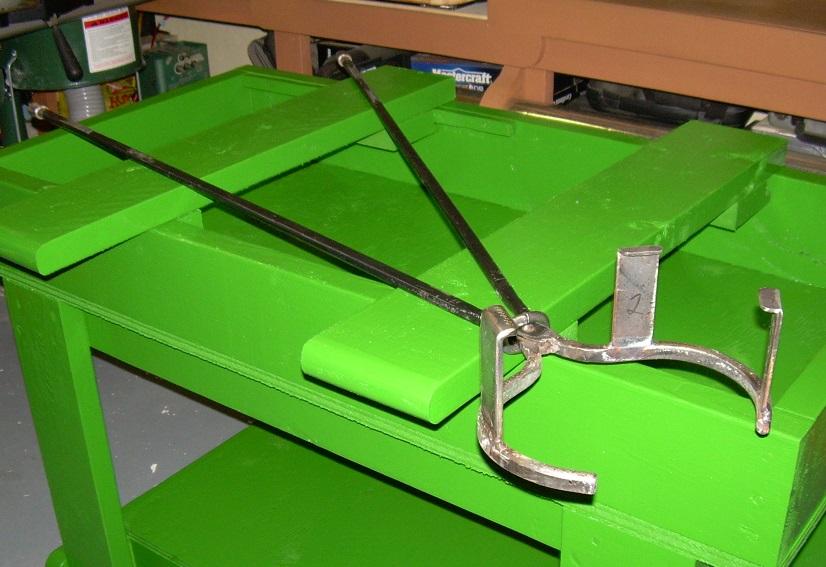

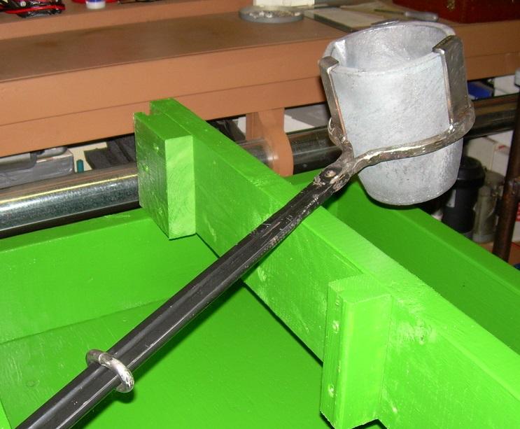

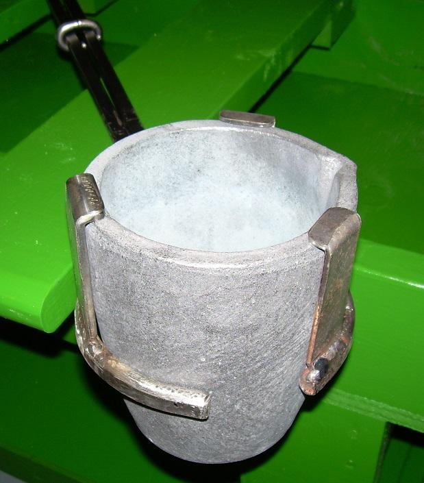

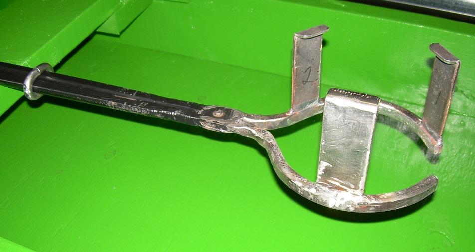

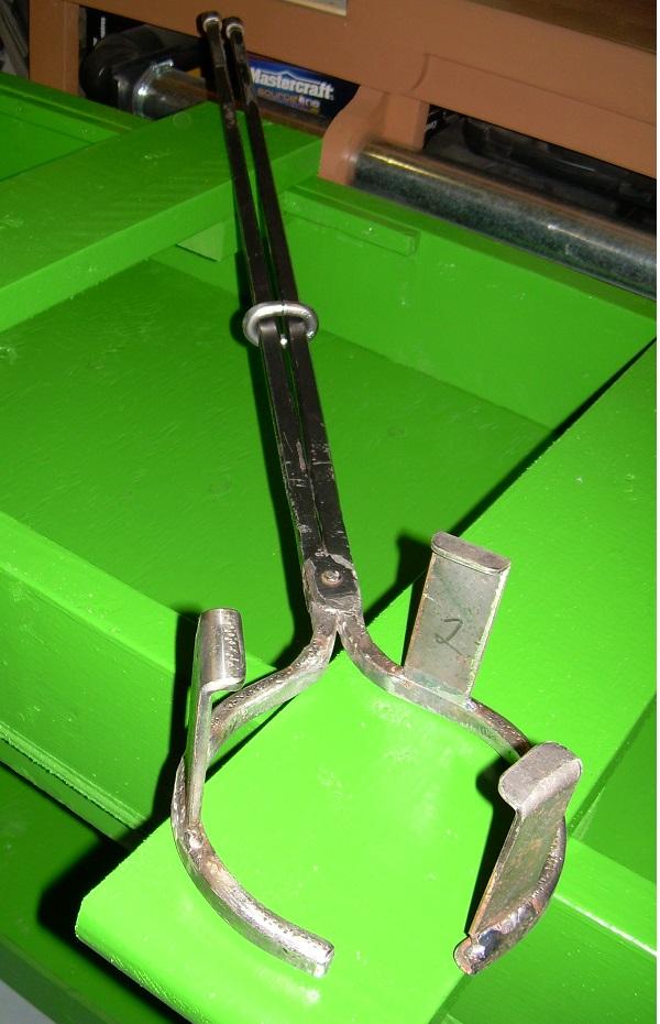

Well that heat wave is going to break tonight  :clap:. Spent the day indoors and built a pouring shank for the clay graghite crucible. I modified surplus oversized fireplace tongs I picked up for a song from Princess Auto years ago for this purpose. After alot of bending and filling and bending and welding I came up with this.

Thats not a bad idea having the tangs like that!  I just use the basic ring that the crucible sits in for pouring but a couple tangs like that would stop the worry of tipping it to much. I store my sand in a plastic container also and find that after storage for a while it gets that funky/mildew smell although it does clear up after a while.

The clay graghite crucible will only be used for a very few # of iron or brass melts. The idea of 20 lb of molten iron or brass popping out of my pouring shank is pretty scary  :zap: could result in serious injury or fire I wouldn't take the chance. For a #8 or smaller I think this will do, for a #10 or higher heavier pouring shanks are required, some with spring loaded retaining hooks and various other mechanisms. For aliminum I plan on using only steel crucibles so welding on hooks and eyes makes it handier for pouring.

CC, the only thing that comes to mind regarding your tongs is a question about pouring.
     Is there going to be enough leverage / grip to control the pour? A crucible of molten brass at that distance might just be wanting to tip out faster than you might like. Would a short bar welded on at right angles 1/4 way down one of the shafts give you more tipping control?? From the pics I gather you are right handed so perhaps on the left side?
        Bear in mind that I have yet to build my furnace let alone do any melting so may be looking for problems that are not there.
       Great re-purposing of the fireside tongs though and the lugs are a great idea. That crucible ain't going anywhere you don't allow.
