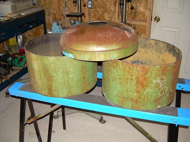

I started this build on another forum. I quickly found I was wasting time with a "your new so you don't know anything" attitude. I quikly cut my losses and left.

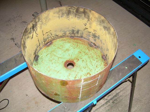

This is a Dave Gingery style crucible furnace. I chose this style for two reasons. The body lifts out of the way so after skimming the dross, the crucible goes directly from furnace to pouring resulting in less heat loss from handling and greater safety again from less handling.
The furnace body is 16" in diameter by 24" high, cut from a discarded water press. tank. Max. aluminum capacity 30 lbs. in steel crucible. Bronze or iron 24 lbs. in #8 clay graphite crucible, #10 will fit but I don't plan to cast much iron.
I am planning on two types of burners. A Reil type atmospheric burner to melt aluminum and a Lionel Oliver type waste motor oil burner for high temp. metals or when my barrel is full.
Plan Of Action:
1. Build shell and shell attachments.
2. Build carriage and lifting mechanism.
3. Install refactories.
4. Build burners and day use oil tank.
5. Test furnace performance.

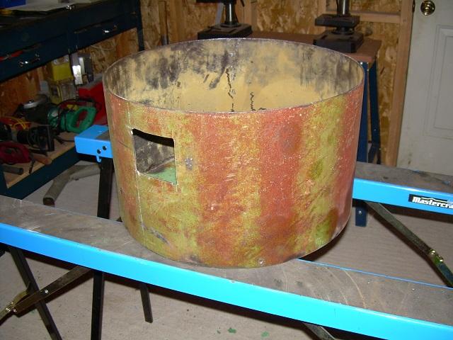

Enough talk, on with the build  :clap:. The first photo is the shell cut from water tank, I have a # of projects planned over the next few years so a steel delivery was in order. The 3rd pic is the bottom section with drain hole cut. The last pic. is the burner port cut and ready for burner mount.
I will compleat burner mount and post tomorrow.

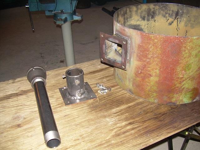

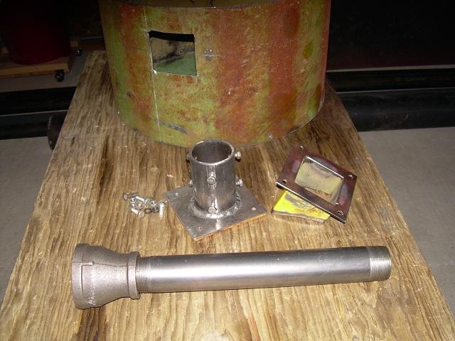

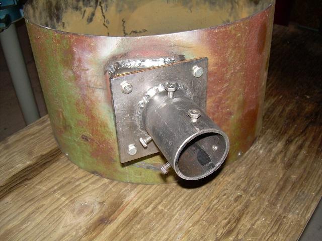

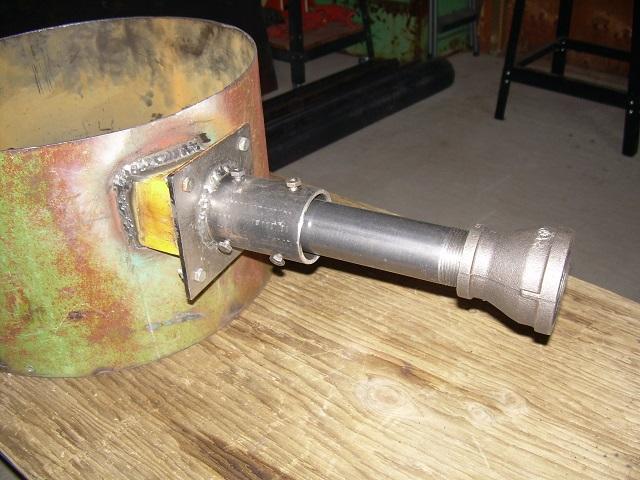

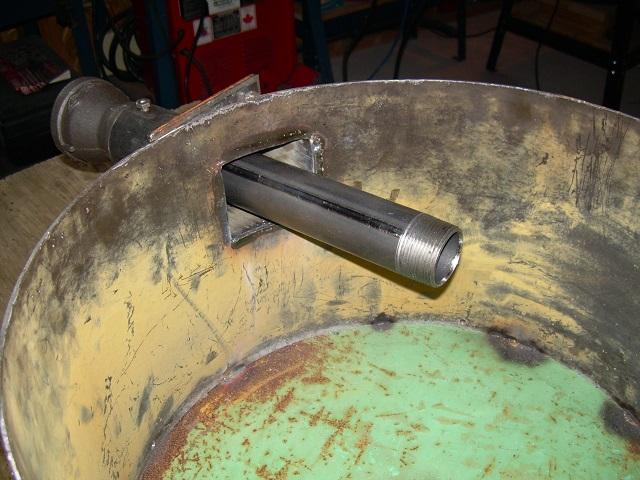

Finished the burner port and mount today. The first pic. shows the assemblies ready to install and a 1 1/4" burner pipe to verify clearances. This represents the largest burner I plan to use. The 2nd pic. is the port extention installed. The 3rd pic is the burner adjustment spud (thats what I call it, may not be correct term) bolted in place. 4th pic. is burner pipe in operating position. The last pic. is the burner pipe pushed all the way in to check side wall clearance. Refractory will be 3.5" thick, so the 4" I measured is just about right taking into consideration the burner flare. The burner spud will also allow 10* of adjustment in any direction up, down or sideways.
Cheers All :beer:
CB

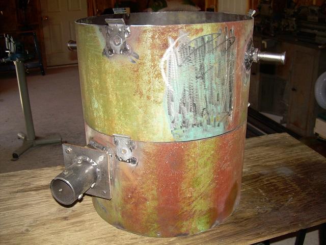

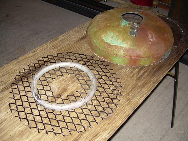

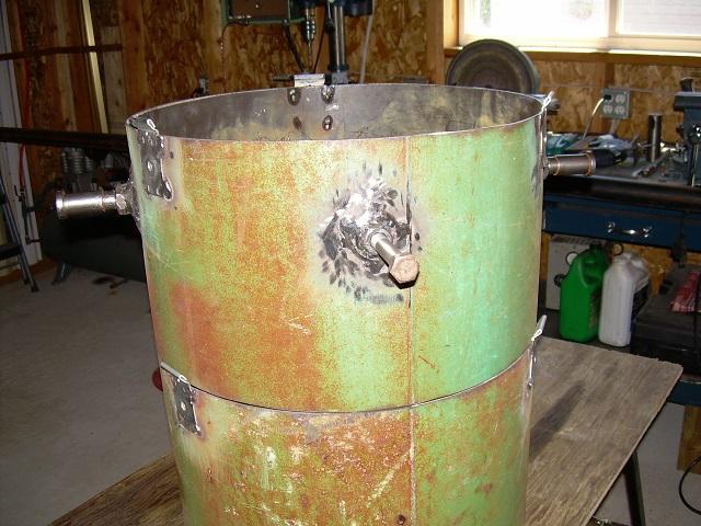

Hello again;

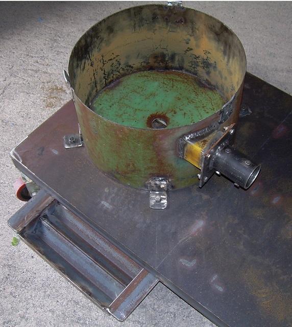

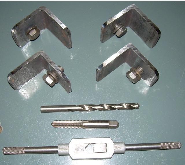

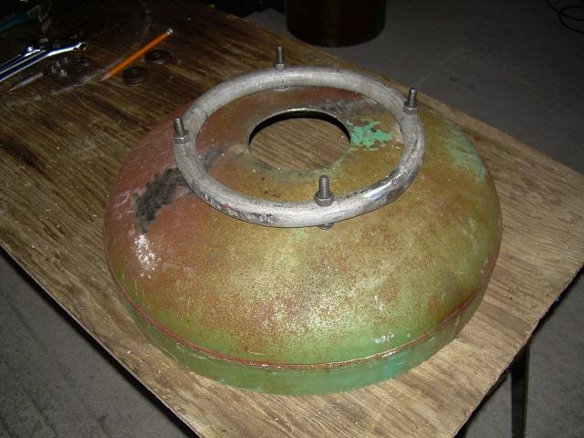

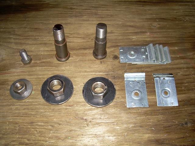

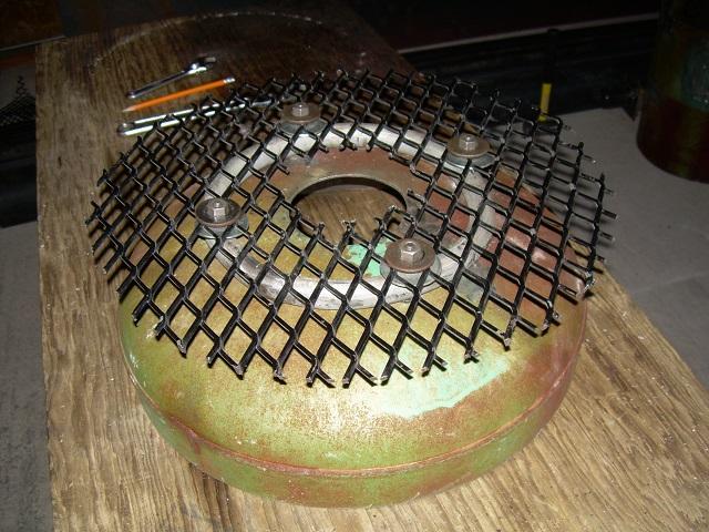

Following is the last couple days work. In 1st pic. are 6 alignment tabs hammered out of junk box brackets and the lifting bolts and attachments. I am using 3 1/2" shoulder bolts to extend the measurment between the lifting arms by 4". This will allow a 20" shell if I decide to play with a larger furnace in future and allow me to use the same carriage and lifting mechanism. Pics 4,5 and 6 are the parts and assembled preheat rack. Essentially the shell is complete. The bottom lip of middle section will get a refractory support ring and once the lid lift is complete I can fit it to the lid then the rack will get a finished edge around it's circumferance to avoid snags.
Break time, got to clean up the mess I've made so far and catch up on chores.  :whip:
Cheers All  :beer:
PS: I know the welding could be better, but heck I'm getting old and shaky.
« Last Edit: June 14, 2016, 09:07:09 PM by inthesticks »

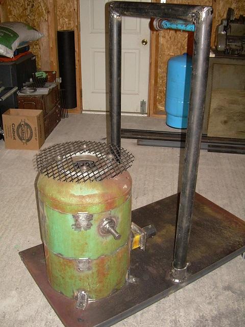

hi CB - just a suggestion : the preheat rack (pic 18) has the raw edge of the mesh which is likely to catch either skin or clothes - you might want to consider tacking say a 1/4" rod round the outside?

Please reread the post. I address this in the last line of the main body of the post. The edge can't be finished untill I determine where the lid lift struts will cross the edge of the rack. It will require trimming in 2 locations before the finished edge can be applied.
CB

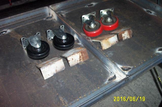

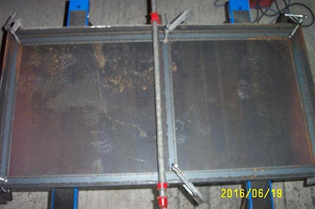

Hello all;

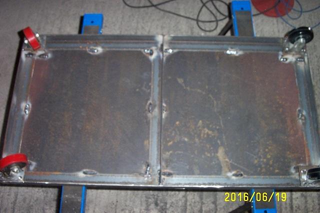

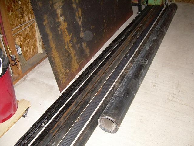

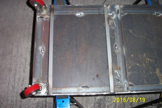

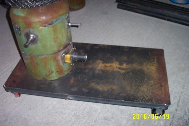

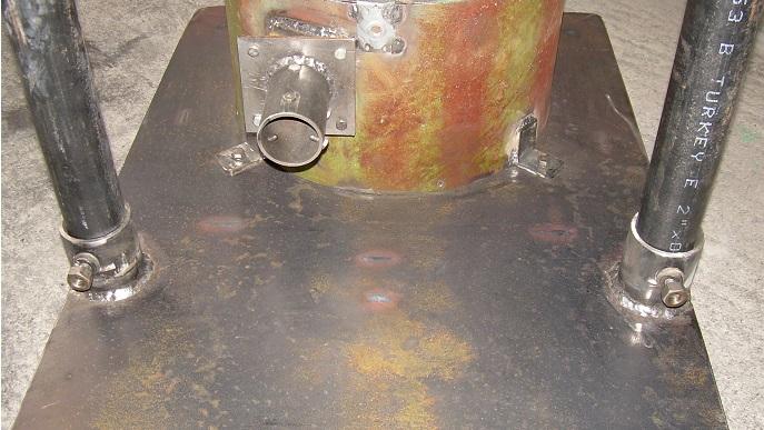

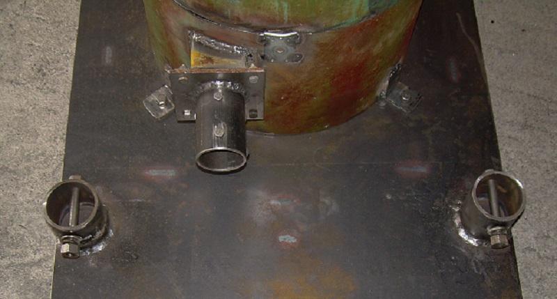

I managed to get in a couple of afternoons in the shop, fixed one screw-up and built the mobile base for the carriage.
Here are some pics.
1. The angle iron and deck cut, mitered and clamped ready to weld.
2. The casters and mounts ready to install. Didn't have matched set so, Heavy iron core swivels on furnace end, standerd duty on light end.
3. Casters installed, all welded up.
4. Crucible failure catch pan slide supports installed.
5. And just to try it out to see how it fits.
Cheers all :beer:
CB

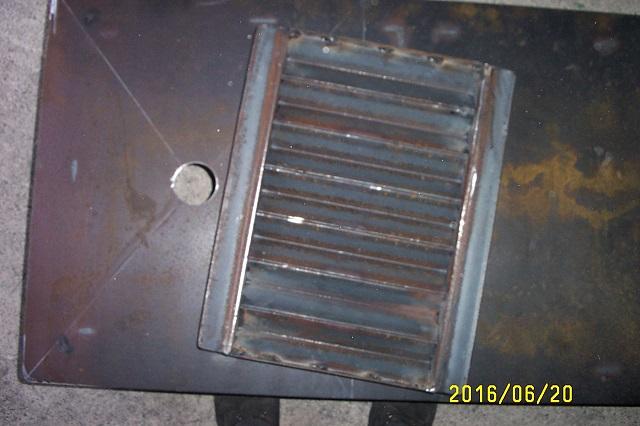

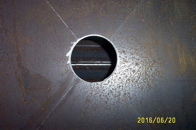

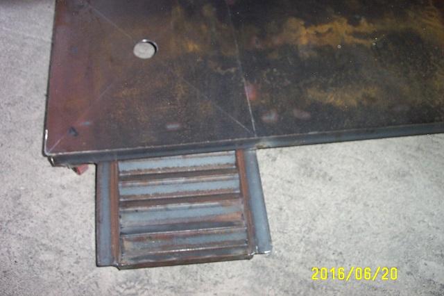

Did not do much today, high winds nocking power out all afternoon. Got the ingot mould/crucible failure catch pan welded and fitted. This ones for aliminum
I will make a pan lined with refractory or a couple of inches of sand for the occassional iron melt. Its a good idea but its not my idea I have seen at least 2 other builders use this type of setup.
Here are some pictures.
Cheers All

Offline Homebrewer
  • Posts: 17
Re: Dual Fuel Gingery Type Furnace
« Reply #19 on: June 20, 2016, 08:38:17 PM »
Are you planning to allow the melted metal to drop right through the bottom of the furnace, directly into the ingot mold?
Sent from my SAMSUNG-SM-G900A using Tapatalk
inthesticks
« Reply #20 on: June 20, 2016, 09:32:25 PM »
LillyHillBrewer I guess your new to this, the reason its a good idea is it gives the mould a double function in the case of aluminum, you store it under the furnace so if you have a crucible failure and they do happen, your crucible will empty through the drain hole into the ingot mold rather than onto the ground.If your casting ingots its a simple matter to slide it out when you are ready to pour.
With iron were crucible falures can be so much more dangerous A refractory lined or partly sand filled pan will catch the contents of your crucible. You may be thinking of a direct melt furnace that some builders use to melt scrap aluminum they work but are highly oxidizing and are used mainly to reduce scrap to ingots, to many contaminants for direct casting.
CB

Offline Homebrewer
  • Posts: 17
« Reply #21 on: June 20, 2016, 11:06:56 PM »
You're right; I am new.  Been reading about all this for a few months and trying to learn.  What you described makes perfect sense.  Thanks!

Here's what I should have finished yesterday till the power bumps screwed me up. Bolted the bottom section to deck using 3/8 X 1" NC bolts and lock washers.
Here's a couple of pics. On to the lift assemblies.

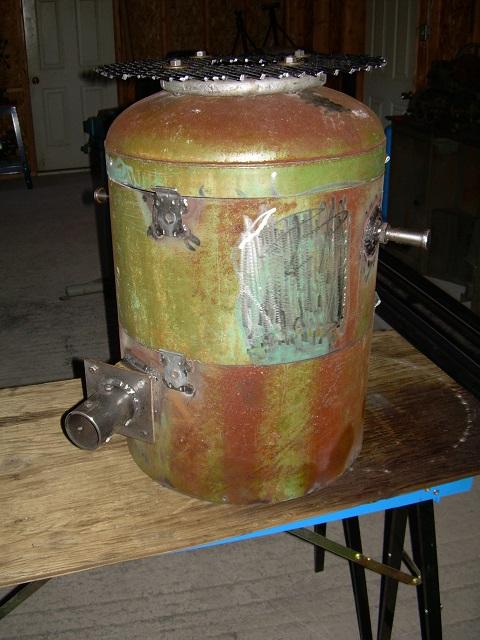

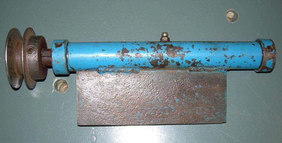

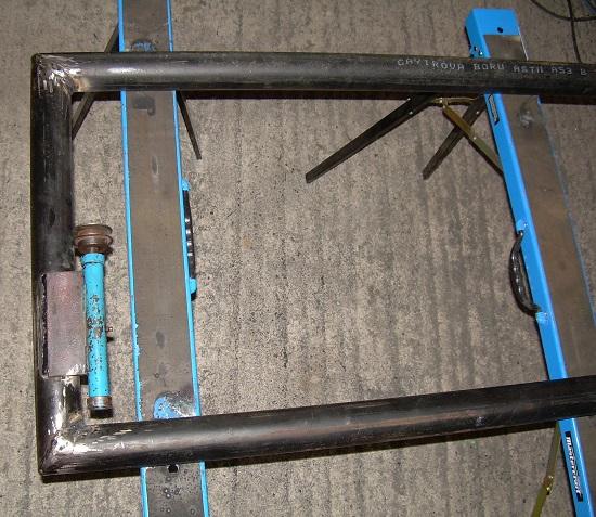

I managed to get a couple of hrs. in the shop this afternoon. Started on the lifting arch which both lifting assemblies will attach too.
Here are the pictures.
1. Arch deck mounts welded and drilled to accept 1/2 X 4" bolts.
2. A salvaged greasable bushing mandrel with pully, to be used as top lift pully for cable lift.
3.Arch cut mitered and welded with mandrel fitted to top of arch.
4.Arch installed in deck mounts.
5.How it looks so far.
Cheers all
