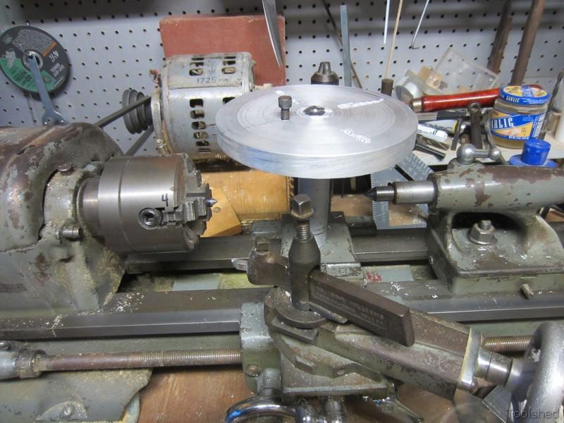

My faceplate acting as its own lathe dawg with the 4-jaw.  The center in the 4jaw was made almost as you made yours here....

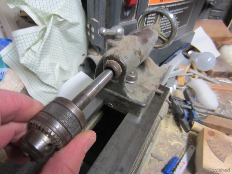

I also cut a Morse 1 taper for a drill chuck for the tailstock.

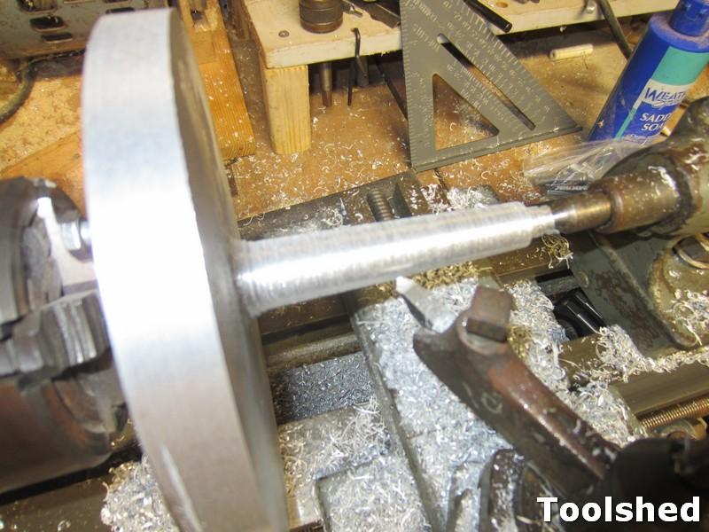

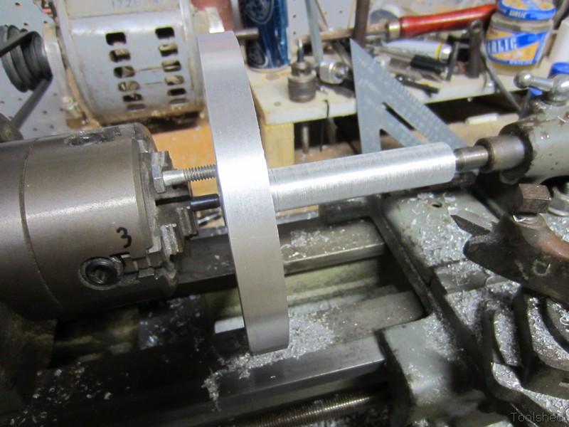

Thanks for the props Rob.  Tail stock offset.  Glad I took that one photo!
David, The tail stock offset allows you to traverse the carriage STRAIGHT.  There is no using the compound slide.  It brings the tail of the piece just that fraction closer to the cutter.  Has to be done between centers since a straight chuck would rip the work piece up being offset. Hence the need for a dog on the drive side of the works.
This allows you to cut any minuscule kind of taper.  HOWEVER, notice there is no vernier on my tail stock, so it gets a little dicey.  The great thing about that face plate is, if I goof it up, I just melt it down and have a redo.....Luckily got it first time....Or at least close enough for my needs.
