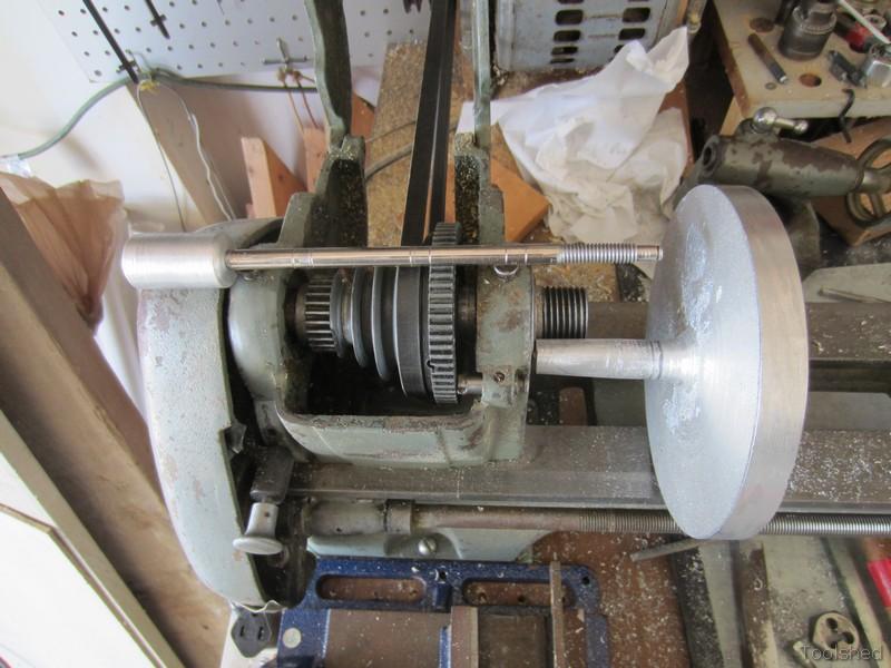

I needed to make some metric M6 -1.00 screws for my SINAR Clamp Set Unit
as none easily available here in the Colonies. My old Atlas 618 ... no longer
run by water wheel now that electric motors have been discovered  ... is
has an  Imperial lead screw of 16 TPI.
Tables in the long forgotten "Threading Information" gem gave me the proper
transpose gear pair ... 44/52 and the proper combinations for cutting the 1.00 mm pitch.

An other addition to the Atlas 618 is the use of ER40 collets with and 2MT shank*.
For example I needed to turn a thin ⅛" x 1.5" steel shaft. Holding a 1" rod in the
ER40 making it a 'chuck' I accurately cut the shaft dead on.
For smaller models my ER25 collets  with 2MT shank are used.
( Never too many tools for an inveterate tool-junkie. :)
