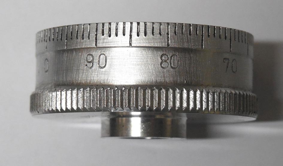

When I recently took delivery of my imperial long bed Boxford AUD MKII, I was very slightly disappointed by the fact that it had metric dials fited. I was told by the previous owner that it had originally been a school lathe and they had probably fitted them  post metrication. I couldn't help thinking that this was a little silly as the machine had an imperial thread cutting gearbox but decided to change them for imperial ones anyway.
I found someone selling them on ebay for £50 each but they were out of stock, so I decided to have a go at making my own. After all, how difficult can it be to scribe 100 equally spaced marks round the circumference of a piece of metal when all you have is a rotary table on a milling machine?
 :lol:
I decided to use aluminium, mainly because it would be easier to knurl, scribe and number punch than steel and it doesn't need to be particularly hard wearing. After going to my local Metal Supermarket and picking up a suitably sized off-cut of 50mm round bar for £12, I cut a lump off in the horizontal band saw and popped it in the 3 jaw chuck to start work.
I was pleased with my new Boxford and it was a good job to learn on. I roughed it out first, leaving  some excess metal to allow for errors and finishing to remove any marks made during production. I started the centre hole off with a drill then fitted my boring head into the tailstock to make a precision fit. The next thing was the knurl for which I used a single straight one with the leading edge slightly away from the work piece in order to minimise pressure. At this point I discovered why I shouldn't have lubed the back gears, Etc. quite so much, as the belt started to slip. :palm: After liberal wiping of the T lock drive belt with isopropyl alcohol, the slipping stopped and I carried on. Next  turned down the main diameter to raise the knurl above the main body, again allowing an extra few thou for errors in marking the graduations.
Next step was to scribe the increments, which I did using a scriber in the drill chuck of my mill drill and an er32 collet mounted in the 2 morse taper on my rotary table. The ten thou markings were easy as they were 36 degrees apart, I then moved round another 18 degrees and added the five thou marks every 36 degrees. At this point I was glad I left the diameter bigger than needed, as I messed up and got the spacing wrong, so had to remove metal and start again. :doh: Second try was perfect as was the addition of the smaller one thou marks which were 3.6 degrees apart. I followed this up by stamping the 2mm numbers round the dial which were not very good, so I was almost happy when I realised I'd done them upside down :bang: I then machined a recess in which to add the numbers the right way round and this was the result.

 :thumbup: It came out well in the end  :bow:

Nice job Griff, shows how a little effort and perseverance can make a bad job into a good job and less scrap pieces......

Russell, Sounds to me like your lathe is the same as mine, imperial gearbox, 8tpi imperial lead screw, this makes it an imperial lathe! Of course you will need the standard imperial end gears in order to get the correct screw feeds.
Of course with the use of different end gears, as Mick said, you can cut metric threads but that doesn't make it a metric lathe. The thing that would make it metric or imperial by definition would be the Boxford name plate, if it is a metric lathe it will have a metric name plate, if it is an imperial lathe it will have an imperial name plate. Also the metric gearbox is kind of a mirror image of it's imperial counterpart, with the tumblers on opposite sides. By all accounts even some of the lathes sold and labelled as metric, with metric name plates and gearboxes, were fitted with imperial feed screws, this was done to use up the stock of feed screws already on the shelf and again they were fitted with different end gears to enable metric thread cutting.
I think I already explained this bit but I'll repeat it in greater detail. As we all know, Boxford lathes have always been used in schools,colleges and with the advent of metrication they couldn't afford to scrap all the imperial parts they already had. Also schools that already had imperial lathes couldn't afford to replace them with new metric ones or fully upgrade them by changing lead screws, gearboxes etc. The simplest thing to do was to change the dials on the cross slides and compound slides. It was a stroke of genius how they accomplished this and a case of using very simple mathematics.
On an imperial Boxford as we all know, one turn of the dial moves the tool 100 thou, or a tenth of an inch, so the dial simply has 100 increments of 1 thousandth of an inch. I'm sure we are all aware that there are 25.4 mm in an inch (approximately), therefore a tenth of an inch, or one turn of the dial, is 2.54 mm, they simply discounted the 4 hundredths of a mm per turn and rounded it down to 2.5mm, after all they were meant to be used by students not in industry. Of course they couldn't put 250 increments on the dial as they would be too close together and hard to read, so they simply made 125 increments, each increment 2 hundredths of a mm. There was no need to change any feed screws or anything else, as this was unnecessary and would have been prohibitively expensive. As Mick said all they did was add a 127 change gear and with the aid of a conversion chart (which is widely available on the internet and in the more recent versions of Know your lathe) and hey presto you could cut metric threads on your imperial lathe.
Hope this isn't too basic an explaination but it really is that simple. Rest assured, as soon as I get a tool holder adapted to hold a dial gauge I will test the theory out with hard facts but I've tried it with a magnetic mounted dial gauge and I'm getting 2.52 mm per turn. I know this isn't a true reading as the magnetic base isn't perfect but it is pointing towards a tenth of an inch per turn!!
Cheers, Griff.

The whole point bis that the cross slide does not move the tool in as far as the dial says it is doing.
'Rounding up' seems a strange way to go if you are trying to teach precision.
It is short a couple of thou for every turn.  Turn the wheel ten times and you are 20 thou short of where you expected to be.
This isn't too much of a problem as at least you are ending your cut short; you can always take off a bit more.
And, of course, we are assuming that anyone using these machines knows about the shortfall.

2.5/25.4 = 0.0984" ,thats a 0.003" error on a part OD/ID  with just ONE full rotation of the leadscrew if it were fit with an imperial 100 thou per rev dial  :palm:
Boxford did not fit metric dials to an imperial leadscrew  :bang:

Offline GRIFFIN
  • Posts: 29
  • Location:Consett, Co. Durham
Re: BOXFORD IMPERIAL DIAL
« Reply #24 on: March 29, 2016, 01:13:42 PM »
:update:
Ok the moment we've all waited for, I've fitted a dial gauge into the tool post and as instructed dialled in three full turns on the cross slide !!! Hands in the air' it was 5 thou under three hundred thou, so I was wrong, it has got metric cross slide and compound screws. Looks like it's humble pie for dinner this evening for me!!!
:bugeye:
Please don't be too hard on me though, everything else is imperial, I have checked, 8tpi lead screw, imperial end gear set up, imperial gearbox, imperial name plate, HONEST.
The only question now: does anyone have a set of imperial screws and nuts for a Boxford AUD to convert it back to a full imperial machine?
:doh:
