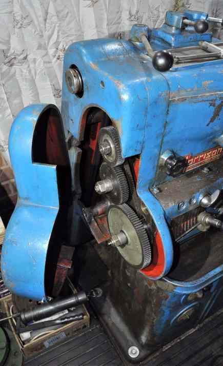

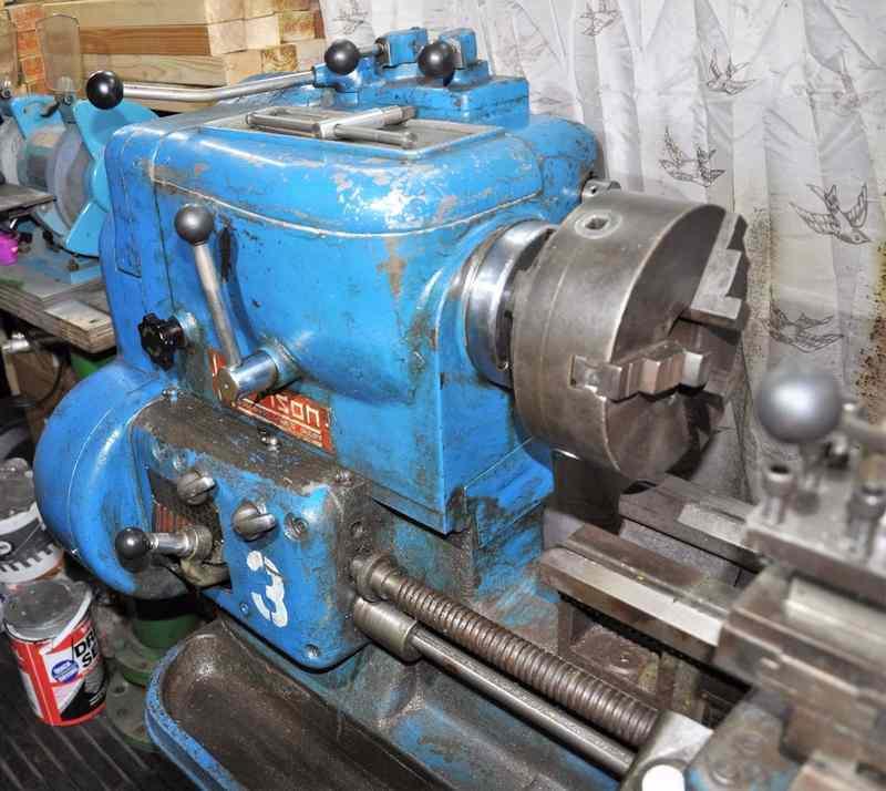

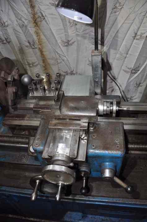

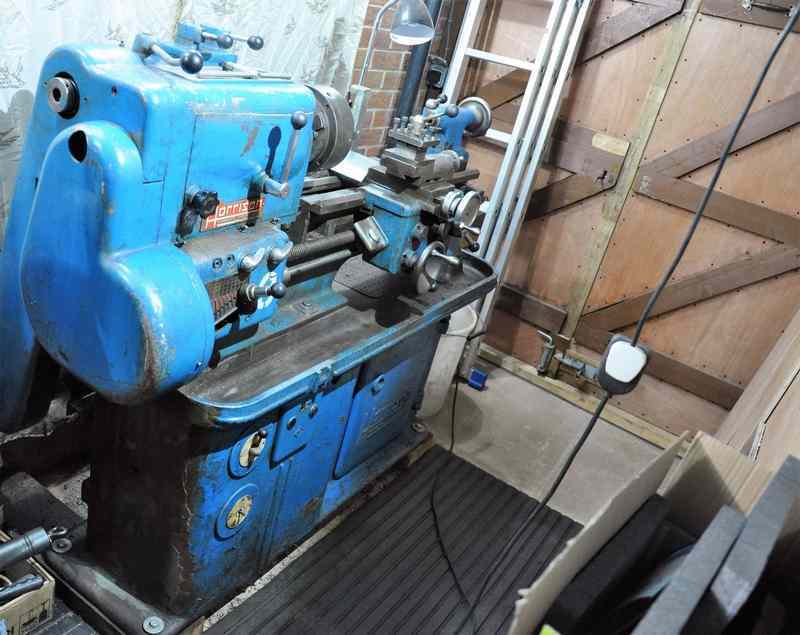

I have now had the Harrison for one Month and in the meantime have instigated the making of a set of conversion gears in cast iron, stripped most of the saddle except for the broken and rusted screws and found someone else’s good work to repair!
The way things are progressing I will probably have to strip it to the bone in the same manner as Mick’s previous resurrection. :doh:

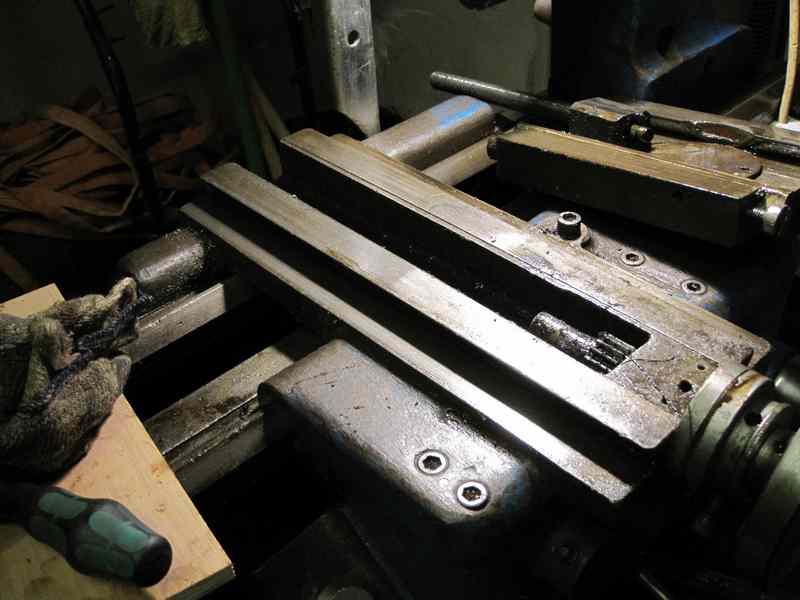

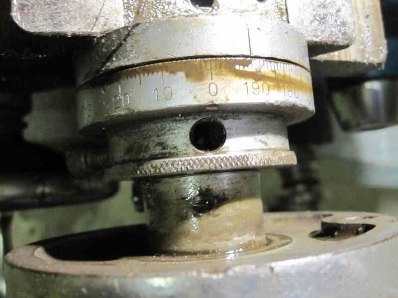

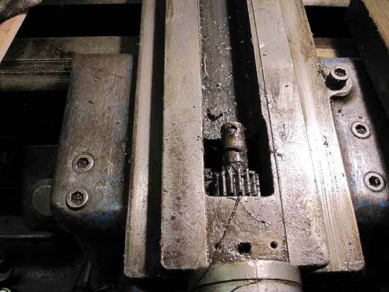

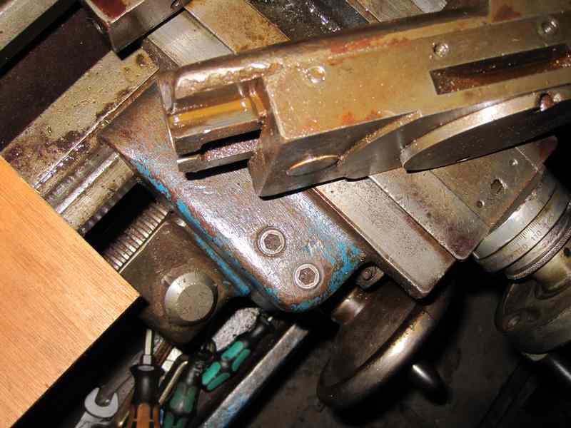

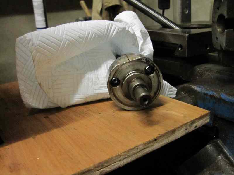

The cross- slide has been very stubborn as the two bolts holding the measuring collar were thread locked in and the rust had also attributed to the problem. After about a week in Kroil, I had given up and resorted to heat. That did the trick but, this also heated up the bearings which now feel a little gritty. Next job is to remove the bearings from the crossline lead screw.

Hi Biggles, you have your work cut out there, but the cross slide gets some stick on all machines, clean all the crap off, a light stoning to mark the dings and bumps, and then a carefull examination. you will be making swarf before you know it1

Hi Phil, it’s not so much the slide that worries me; but because I had to heat the thrust bearing on the leadscrew to get one of the retaining screw off, (it feels a little gritty now) and wondered if I have distorted the bearing run, also how to get the bearings of the screw if I need to change bearings. :palm:

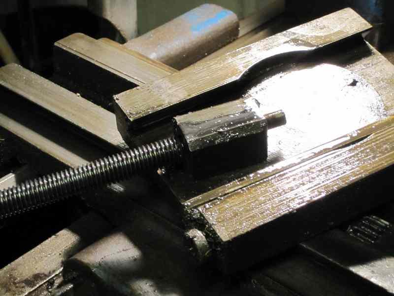

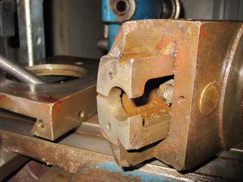

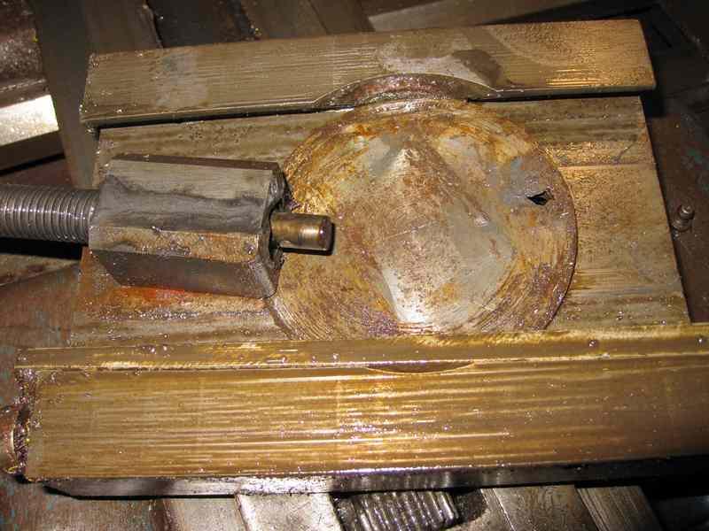

It’s been a while since I have written anything in this post, I have been busy. I have sent some parts of the compound down to a friend’s workshop to be filled in with stainless and to have gibs and T nuts made for my new phase 2 post. I managed to take the compounds micrometre and bearings apart and found that someone beat me too it, previously denting the thrust bearing. Bought some more bearings and located a new three ball hand wheel to replace the old type with the two bolts screwed in for control. I thought I should download an expanded drawing of the headstock so that I can ask question on some parts latter on. Apart from that I have been busy with the loft extension and lying down on the settee for my back problems. That’s about it. I will upload some photos later on.
