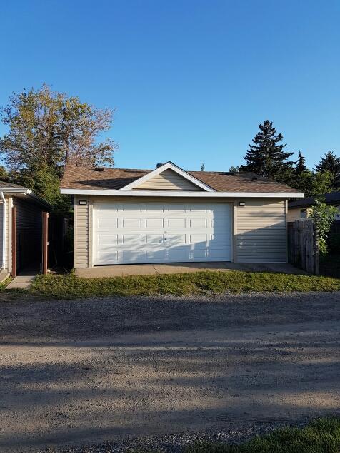

Where I am there is a back alley and then baseball / socker field. Some neighbours got together and put in some streetlights the cost gets split and put on your electricity bill. I had the garage redone on the outside and had this added to the roof for the video cameras I also have two led lights that come on at dusk that light up a good area.
 The bad part is the summer people going to their games all looking at what you have!
Not to mention that piss poor lock on every garage! :doh:
