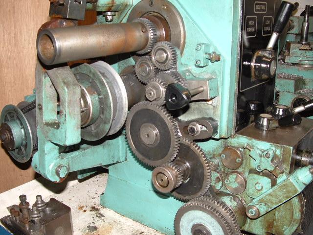

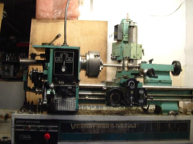

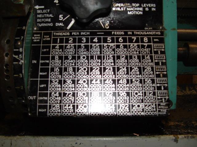

A few quick pictures. Taken with a hand held camera, so not good quality. Things will improve when I get the tripod adapter sorted out.
I'll save the descriptions for the next (better) pics.
But basically,  the gear train as it is in normal (low range) usage.
 then the machine. Sans guards. The big lumpy thing in the middle is the EMCO milling head.
And a rather reflective view of the Imperial screw cutting chart.
Let's see if they appear.
