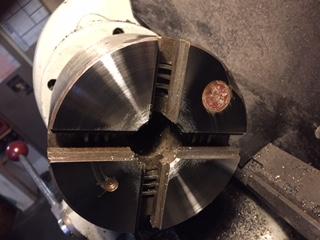

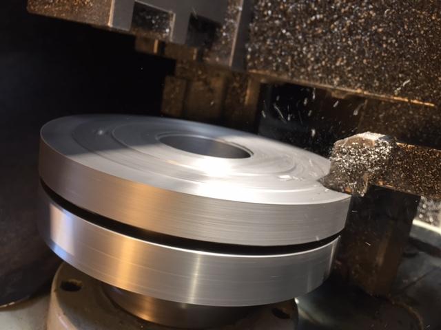

Hi folks,
Video showing the problem - shot of the surface finish is at the end -
So I've just finished doing a full refurb on this lathe, scraped it all in, replaced the old gear drive with a direct belt drive  & VFD, serviced all the parts etc.
Put it back together and it's chattering like mad. Anything steel above about 30mm is more or less unturnable, and even on steel around 15mm it only turns nicely if I use a high rake tool (like what you'd use on aluminium). It seems like it just can't handle a heavy load.
I've double checked everything and eliminated all obvious variables - tried different bits of stock, steel, alu, all different tools etc. Checked nothing is wobbling on the saddle/slides/etc. Absolutely everything I've eliminated I think.
The chattering noise is coming from the headstock. The poor surface finish does not improve the closer to the chuck it is. The bearings I adjusted tighter and tighter but that didn't help. I have about 0.007mm of end play in the spindle (if I chuck up a big bar and pull on it).
I'm wondering if the bearings are knackered? They're timken taper rollers and the races look okay to a laymans eye, but I don't know for sure how to test them?
Would appreciate any advice as I'm a bit disappointed at this stage!
Thanks,
Rich

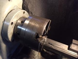

What type of tool is that you're using, it's difficult to make out for sure.

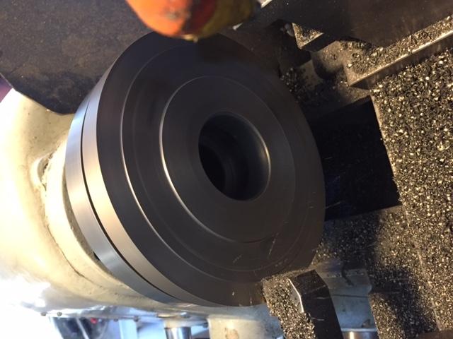

Tried everything - all the same result - two types of carbide insert, HSS, really sharp HSS, and sharp brazed carbide...
Best results came from tools with big back rake - like 35 degrees - but these won't last on steel. Still could only take 3 or 4 thou without chattering.

The tool looks like its about 10mm wide and flat to the cutting surface the tool should have a clearance rake so you are only cutting at the tip.

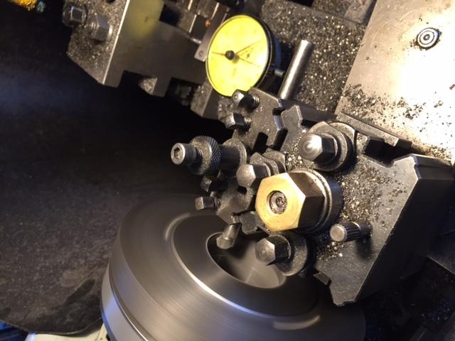

By the way the depth of cut in the video is 0.06mm, that's all it can manage, any more and I think it's dangerous (sounds like it might rip the part out).
For RPM, tried everything from about 150 with HSS up to about 800 with carbide, and everything in between. Couldn't find a sweet spot anywhere.

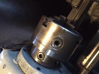

Re: Any idea why this lathe is chattering? Spindle bearings?
« Reply #16 on: January 02, 2016, 06:09:27 PM »
I wonder if the bearing adjustment isn't working quite as you think? If you are swinging on an 8" spanner I'd expect some noticeable friction and them running warm. Indeed in the past I've adjusted head stocks so that there is just a bit of noticeable friction, then backed them off a tad. Leave them running while having your tea, and if they are not warm when you return they are too loose. If you can't keep your hand on them they are too hot and need a slight slackening.
Crude. But it works.

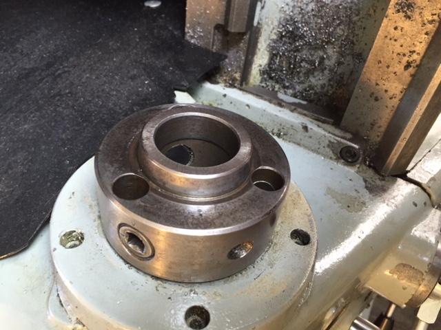

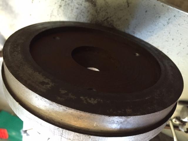

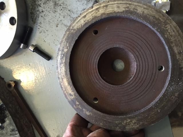

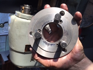

PK, I understand what you mean, but no, the spindle is one diameter where the rear bearing is, with no shoulder.
I've just been out and took the chuck off to eliminate the chuck:spindle connection. I can move the spindle up and down by about 0.01mm by pushing hard with my fingers on a 200mm long bar in the spindle taper. Again I don't know whether that's normal or not?
