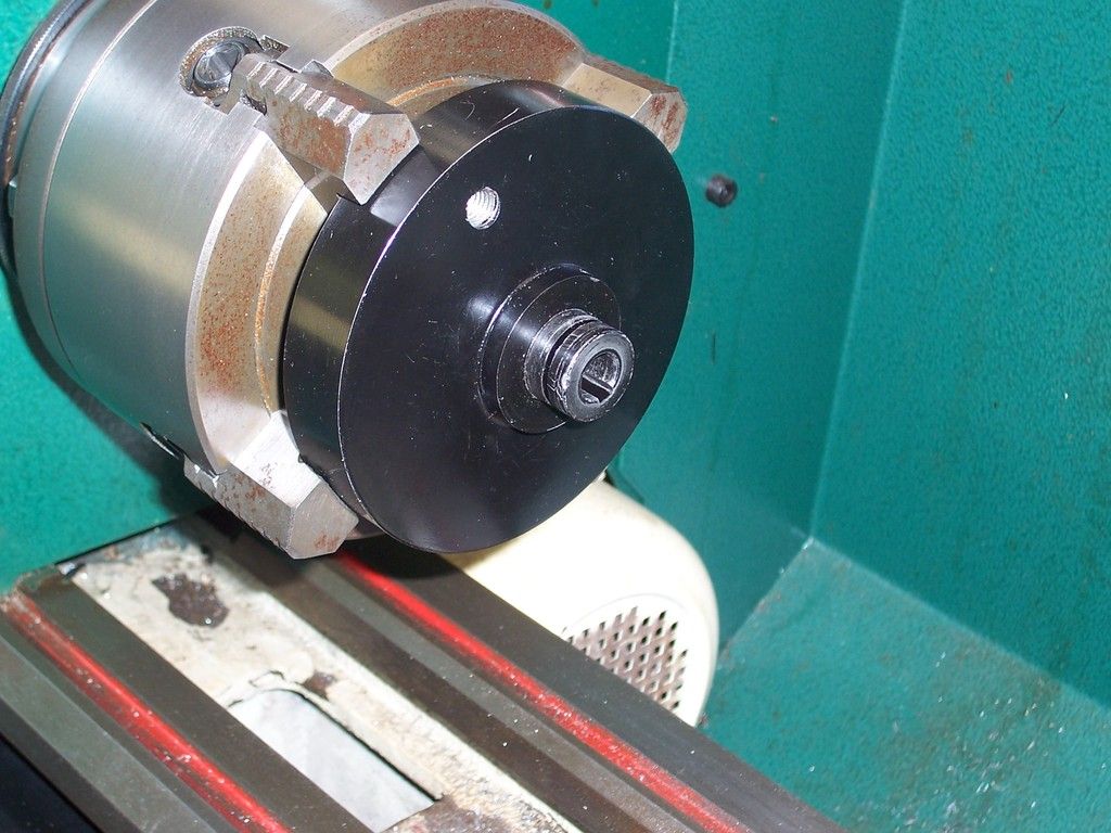

Hey I'm curious, if you don't mind my asking, how you mounted the handwheel to turn down the inner hub on it for the gear? I can think of 2 ways to mount it. Were you able to clamp the outer handwheel ring in your lathe vise, or did you mount the handwheel on a 10mm shaft as a mandrel, and put the shaft in the lathe vise?

I mounted the hand wheel in the 4 jaw chuck by the outer rim.
http://i87.photobucket.com/albums/k142/madluther/Misc/100_1575.jpgSIEG X2 Y Axis Power Feed Idea

Thanks Rythmbls.
That method worked for me as well. I have the handwheel turned down now, and have started boring out the pulley that will go on it.
These pulleys surprised me in their design. I chose a "no-hub" pulley design to get the thinner sizes, but I am going to refer to the center as the hub, below, for lack of a better term.
As you can see in the photo, they are apparently assembled from at least 2 or more components. I am not sure if the crimps running around the flange/hub junction are just to hold flanges on, or if the notched perimeter is a piece they slide onto a blank center hub and swage it together. Either way, I was concerned about it breaking loose at that junction from the force applied while drilling the center out to 3/4" on my way to 20mm. So What I did was park the dual setscrews that came with the pulley such that they span the apparent junction, which would hopefully keep things from moving. Then I used a step drill in the lathe tail-stock (I love step drills!!) and it drilled out very smoothly, all the way up to 3/4". After I set up a boring bar to finish it off, I stopped for the night. When I get back to it I'll bore it to fit the handwheel journal.
