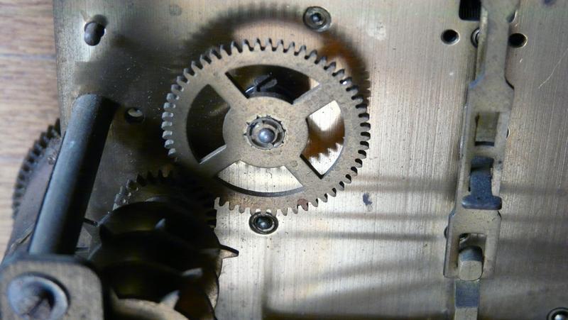

First a photo of the clock as I received it a couple of days ago.  I haven't seen it in the case.
http://i1192.photobucket.com/albums/aa327/jcs0001/junghans1a.jpgGear for a clock
The stainless steel bar is pointing to the pinion (?) which is missing a gear.  The gear that it meshes with is up a bit and to it's immediate right.
http://i1192.photobucket.com/albums/aa327/jcs0001/junghans2a.jpgGear for a clock
http://i1192.photobucket.com/albums/aa327/jcs0001/IMG_0491.jpgGear for a clock
The other side of the mechanism.
http://i1192.photobucket.com/albums/aa327/jcs0001/IMG_0493.jpgGear for a clock
And another shot of the existing gear and bare pinion.
I haven't yet measured anything - that is my next step.
John.

I made a number of measurements and calculations and figured that the outside diameter of the missing gear should be 1.505 in. (and circumference =4.728 in.)   That number does not account for any "slop" in the gearing - it would be very tight to the existing gear.
The existing gear has 30 teeth and is .764 in. outside diameter.  Thus the circumference is 2.400 in. and the teeth per inch of circumference is 30/2.4 = 12.5 teeth per in.
Using the above calculation of 12.5 teeth per in. for the new gear we end up with 59.1 teeth.  I believe that the .1 extra tooth is due to the fact that my calculations allow no clearance between the gears (and possibly measurement error).  If I treat this as a 59 tooth gear then the diameter would be 1.502 in. (and circumference =4.719 in).  That make sense to me as it would allow several thou clearance.

59 teeth dosn't make sense it's has to 60 the chimes are linked to the front cam the bit with 4 slots , it must be an even number to work , the gears are probably module http://www.myvirtualnetwork.com/mklotz/ lots of small programs for gear cutters and gears hear .

« Reply #7 on: July 14, 2015, 05:56:15 PM »
The teeth on that gear look to me to be cycloidal (rather than involute).

Re: Gear for a clock
« Reply #18 on: July 17, 2015, 02:19:42 PM »
Counted the gears 60 30 is what I have .5 module cycloidal teeth .
