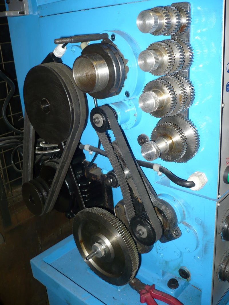

  • Posts: 9161
Re: Electronic Leadscrew?
« Reply #108 on: April 09, 2015, 12:41:59 PM »
I'd be tempted to replace the gear train with tensioned toothed belts and toothed pulleys to minimise backlash.
« Reply #109 on: April 09, 2015, 01:41:13 PM »
Yup, gears are so yesterday.
I have replaced the 'standard' ratio on all my lathes with a toothed belt drive to the gearbox.
The gears stacked on the holders are just for specials that are out of reach of the normal ratio's in the gearbox. Means I can run at higher speeds with less noise.
Sounds good, do you think that would fit on my lathe (Seig C2)  :scratch:
Tim
  • Posts: 9161
« Reply #111 on: April 10, 2015, 02:57:19 AM »
Toothed belts are available in an amazing array of pitches and sizes:
http://www.hpcgears.com/n/products/1.pulleys_belts/pulleys_belts.php
