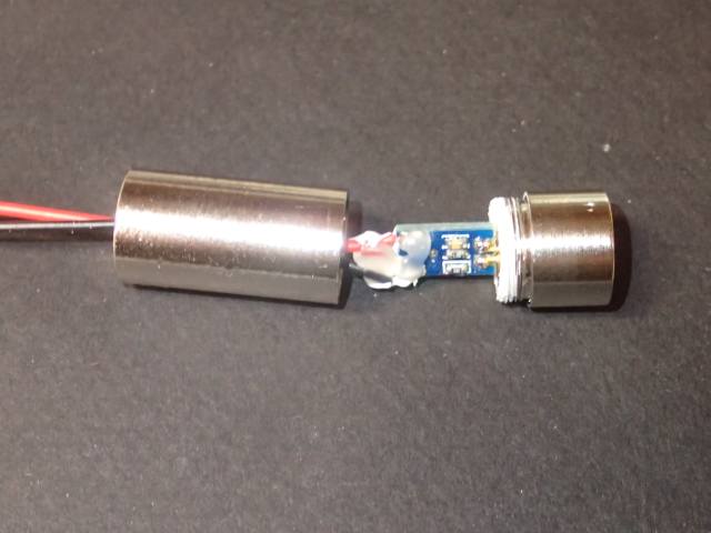

I tested a little pin hole...I pricked a little pinhole on black carboard, cut it round and fited between spring and lense. It worked pretty good.
I removed tha sticker and found out that rear end screws off fairly rapidly revealing the contol board. I wonder if the control board could be mounted remotely or turned 90 degrees to make the whole thing shorter. Looks like a simple regulator, wonder if it needs to be immediately next to laser diode, or could it be moved a little further.

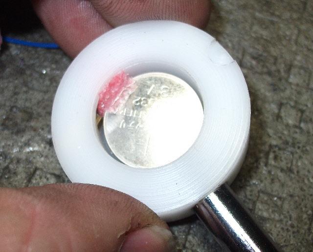

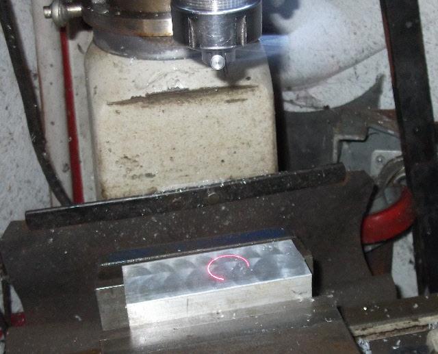

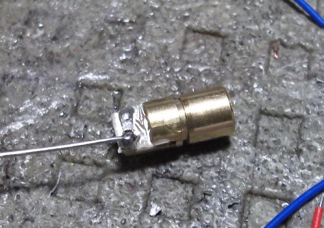

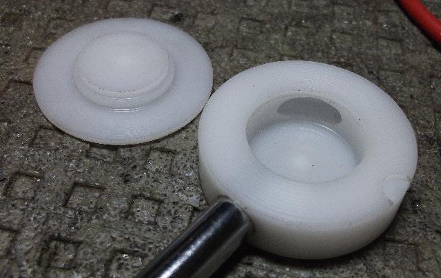

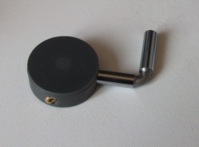

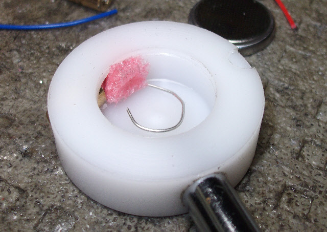

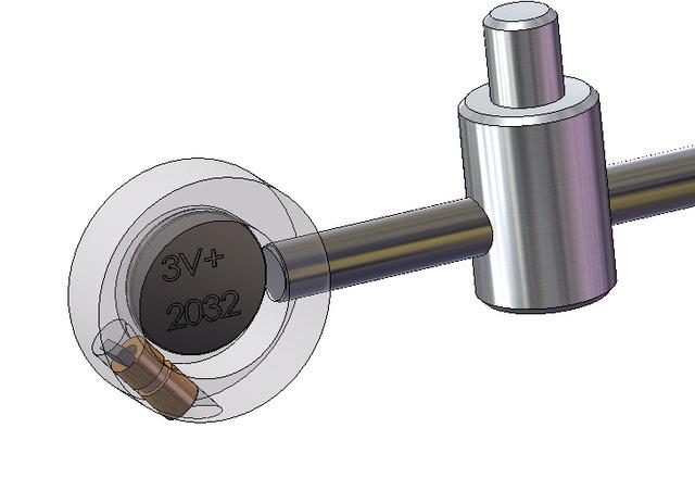

My version :-)
Based on Mike's (of Mikesworkshop) design , I've pared this down to the minimum using a plastic body and automatic centrifugal switch.
Photo 2 - The cap is  sized and shaped to clip into the 21mm battery recess

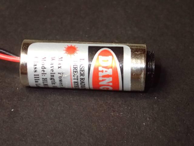

Photo 3 - the cheap 50p eBay laser module has the wires removed and a 40mm piece of tinned copper wire added to the negative (resister) terminal - the module's PCB has to be trimmed (grinder) to make sure the module will press nicely into the 6mm hole
4 & 5 - Once the module is pushed home the wire can be bent around to form the Negative battery connection.  A small piece of plastic foam packing is used to push the 3V lithium cell  away from the laser body (the +ve connection).
6 - Once the thing is rotating above a couple of hundred rpm , the battery is pushed against the body of the laser module and it lights up.

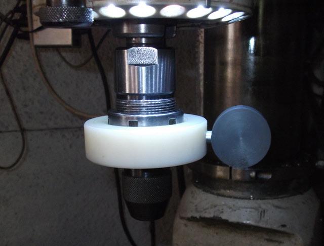

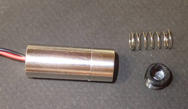

Finally; one that works like Dan Gelbarts' and mounts to the ER32 chuck nut. Using an offcut of Nylon 6 bored to be a press fit .
Incidently, adding an iris as mentioned in the posts above (e.g. something with a small hole between the spring and laser diode) improves the functionality immensely.
I used one hole from a piece of Vero board (matrix PCB ) filed to fit into the laser recess.
