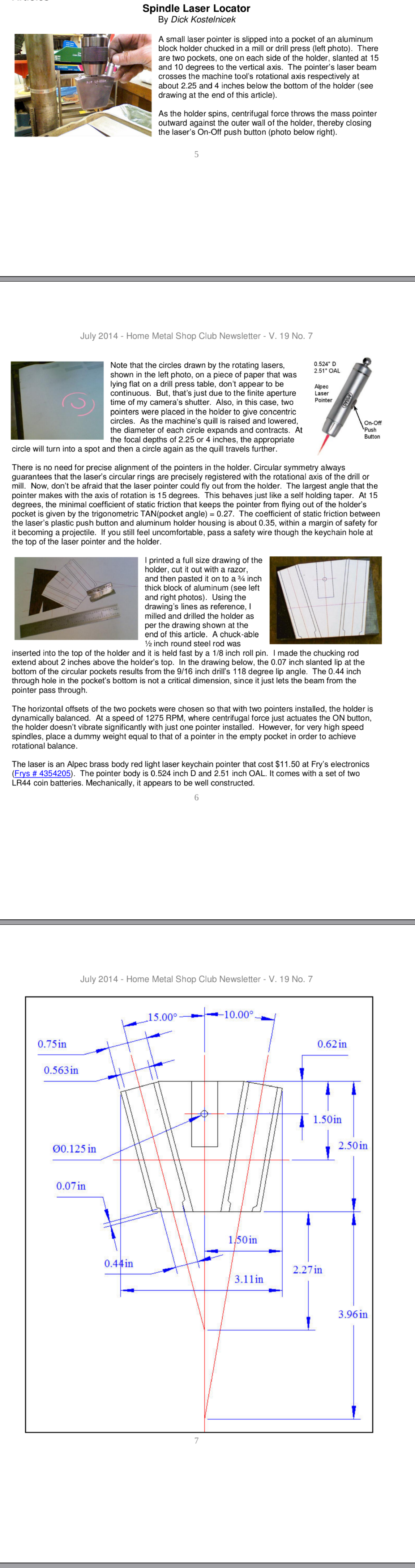

« Reply #101 on: April 21, 2015, 03:34:35 PM »
Hi Guys,
I just found this on the HMSC web site.
There is a PDF article on there but the interesting bit starts at page 5.  I just grabbed an image of the wanted pages.
Best Regards:
                     Baron
Re: Anybody build Dan Gelbart angled laser centre finder?
« Reply #102 on: April 21, 2015, 03:45:07 PM »
I like the simplicity of using centrifugal force to operate the switch - very neat  :clap:

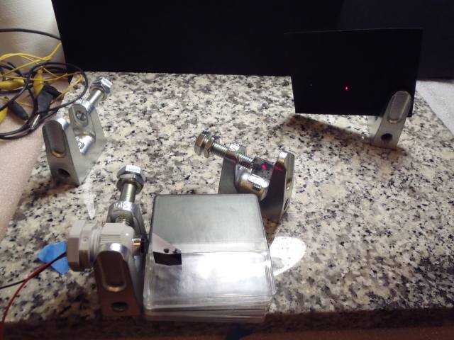

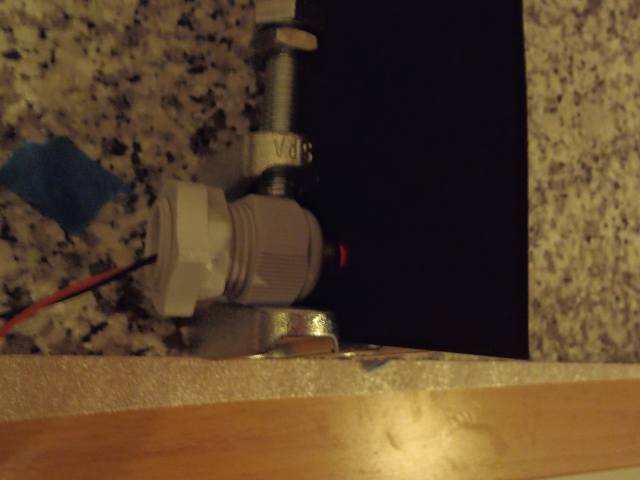

Got one cross-line 5mW laser from mail.
I got some time to play with this cross-line laser.
1) I took the cap/grid lence off and noticed that there is a lense (group?) on threaded holer, that allows "focus" adjustment.
2) Original dot is not extremely clean, about the same than "focusable laser module" that has been linked here.
3) Tried prism to angle the beam and it worked out pretty well. I was expecting some artefact here, but quick look seems to confirm that with a little adjustment laser and prism will compensate oavality of the beam.
Laser inside a grey plastic cable gland
prism from a binoculars (roof prism type, pechan prism used)
ND filter, thanks Vic
Black cardboard.
It looks like it is possible to use prism, but to adjust the beam only with the prism is not optimal. Surface mirror?

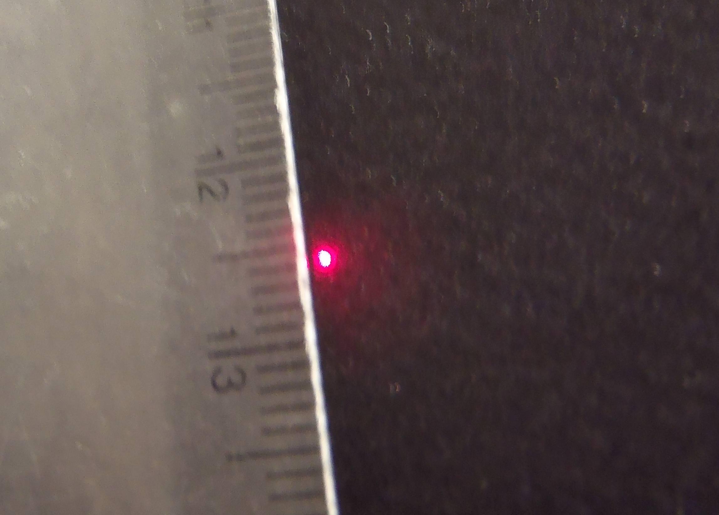

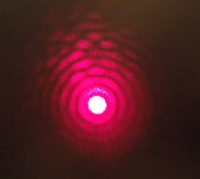

Little testin with pinhole.
1) I made a pinhole onto black craft cardboard, smallest pin I had.
2) I placed the pinhole on front of the collimation lense and it produced interference rings as theoriy says, clearly visble when focused on about 200 mm and then viewed at three meters trough frosted glass.
3) Dot density is greatly reduced and dot is pleasingly round, but not exceedingly small at 200 mm, due to interference no doubt. However when projected onto machined metal surface it looks very promising.
My gut feel about this (not very sientifically based) is:
Pinhole can be used to clip the size of the dot, but to be highly effective it needs to be placed carefully, probably near focal point and in this system it means some extra lenses.
Pinhole naturally cuts some intensity, specially when placed into "wrong place" wether this is good or bad depends on situation.
ND filters I got do no seem to reduce quality of the beam.

I couldn't see any interference rings with the setup I used. It may be they are still there, just too feint to see? I have another mounting prepared ready to drill when the micro drills I've ordered arrive so we'll have to see what happens with that. I can't see the need for a prism unless for some reason you really want to mount the Laser horizontally? Adding a mount to house a ND filter and a reduced aperture increases the bulk somewhat but it's still small enough to use. The other Laser I've ordered is very much smaller so it will be interesting to see how compact this assembly will be. I'm still favouring a button cell, maybe a CR2032 if it lasts long enough.
« Reply #111 on: April 27, 2015, 05:27:52 AM »
As you see on the bottom picture, interference artefact is not that visible on reflected light at 200 mm distance, but I assume that dot appear bigger because of that. The picture where interference shows is the same beam, but at three metres trough matte glass. When I viewed at laser side the effect was not very clear just a bigger dot (about 2-3 cm). But at the other side the effect is very clear. Last picture shows the interference nicely (Picture is taken at a angle, because head on the picture was just just a big blow of red light, but vhen observed the rings were very consentric and all around the central dot). But the dot was really round, only the interference rings to make it too large.
I'm testing the prism, because I want to slip the indicator at the end of the spindle and there is space only to very thin object. Therefore my preference is to make this flat, but if that is too much trouble or the smaller laser is not small enough, then "Plan B" is to fabricate one that will slip over dedicated ER holder - not as versatile, but plenty of headroom.
I don't know much of the pinholes, but I think that thinner the material you have the better the results are. I could not find my very thin copper foil, but I should have somewhere a little of thin brass shim stock and I was thinking of comparing that with domestic aluminium foil - hole pricked with a needle.

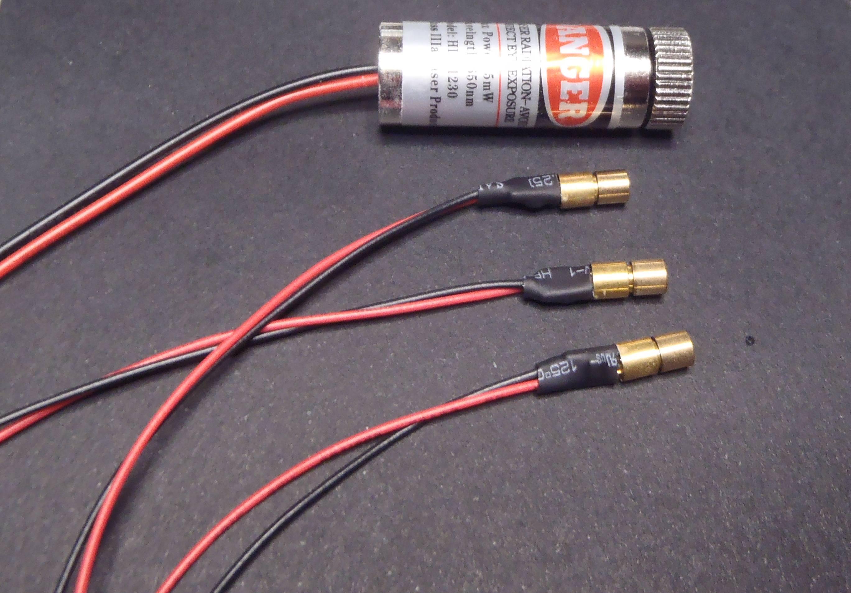

And the mailman brought small lasers, quick and dirty testing showed that these would simplify mechanics greatly.
« Reply #116 on: April 27, 2015, 03:21:50 PM »
When this thread started I ordered a job lot of 50 of those small ones for a ridiculously small amount on ebay. Did a quick and dirty test with a variable voltage and current psu and was most impressed.
They then went back in the bag and still are sitting on the desk waiting for time to make a mock up  :bang:
I have to say reading all that's been said people seem to be making this far more complicated than Dan's original simple concept  :scratch: But what do I know, mine are still in the bag  :ddb:
