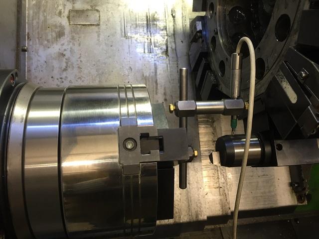

Cricking my neck reading DTI's upside down whilst adjusting my Traub tool turret it occurred to me that I have a perfectly good Mitutoyo  543-682 electronic DTI with a socket for remote reading.
Anyone built a remote interface / display for the Mitutoyo SPC interface ?

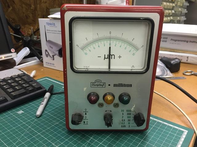

It was about this time I remembered I had a Mahr Feinpruf transducer based measuring gizmo, so in this instance my immediate need vanished  :clap:
(Details in my CNC lathe thread)
Still think given time it would be a useful exercise
