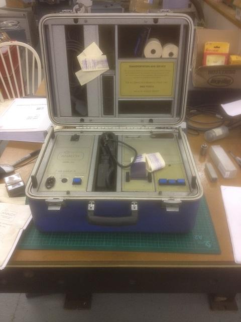

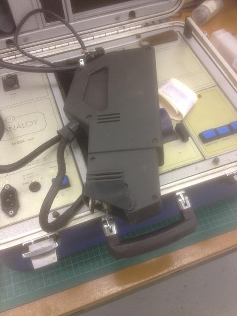

I'm definitely sticking with my Analloy Analyser:
http://madmodder.net/index.php/topic,9244.msg102310.html#msg102310
I seem to remember that aluminium and zinc based alloys can be distinguished by their reaction to acids quite easily

Hi there, Andrew,
Thank you for your post.  I did intend to refer to your marvellous gadget in my introduction - it must be a useful asset but it's one not many of us have.
