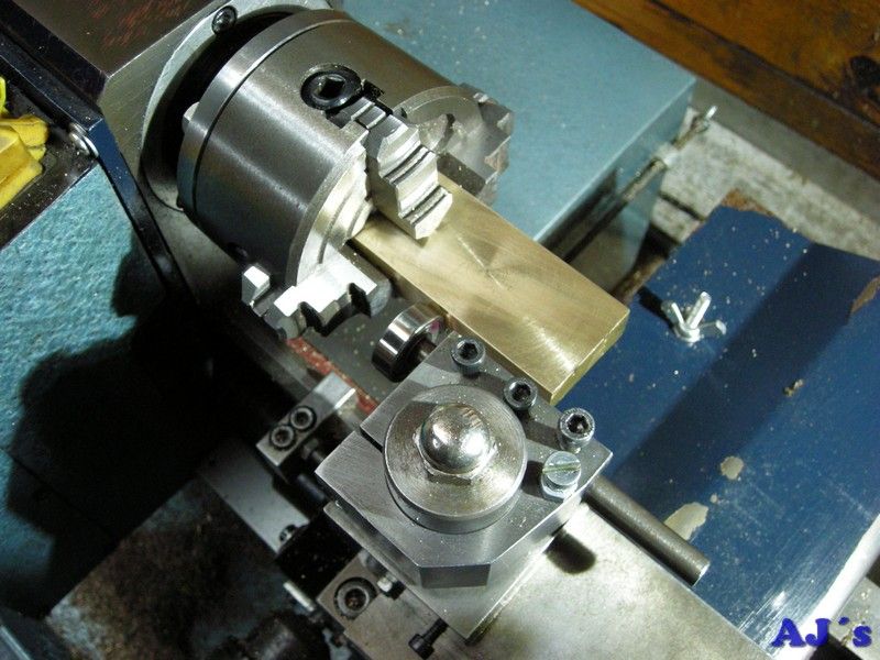

A piece of flat bar was centered to a punch mark.
http://i519.photobucket.com/albums/u356/dozerd10/Workshop/Projects/Elmer33/Image00024.jpgElmer's horizontal mill engine.
A hole was drilled.
http://i519.photobucket.com/albums/u356/dozerd10/Workshop/Projects/Elmer33/Image00025.jpgElmer's horizontal mill engine.
And bored.
http://i519.photobucket.com/albums/u356/dozerd10/Workshop/Projects/Elmer33/Image00026.jpgElmer's horizontal mill engine.

To hold the blind head for facing the outside an ER40 chuck was used.  A slug of 25mm bar was placed in the back of the collet so it could close.

The finished pair.
http://i519.photobucket.com/albums/u356/dozerd10/Workshop/Projects/Elmer33/Image00058.jpgElmer's horizontal mill engine.
http://i519.photobucket.com/albums/u356/dozerd10/Workshop/Projects/Elmer33/Image00059.jpgElmer's horizontal mill engine.
That’s all for now.
Abraham
