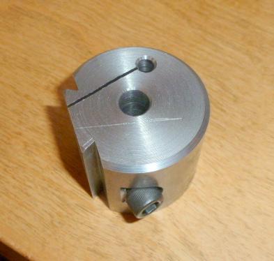

First thing was to gather materials to build the thing, didn't have an aluminum, or any other suitable metal stock at hand, so I made mahogany slabs for the arms:
Flanged bushings were made of brass, pins were turned of 8mm stainless steel.
For the pivot, I simplified the design even more; I used a 19mm(0.748") steel ball, from the ancient ball-mouse. Soft steel, easy to drill, and tap.

Thanks! The size of that Johnny Cash -master is 160x100mm(6,3 x 3,4"), while the engraved one is ~23x14mm(0,9 x 0,55").
So the ratio is ~7.
Motor speed is about 4500 rpm at 24 volt. Cutting bit is made of 3,2mm(0,125") scrapped tungsten burr.
This end is used for filling...                               ...and this end for finishing:
Both ends have six faces, sharpened until there is no flat at the end.
At first I considered of getting commercial bits, but they might be too delicate for manual operation.
And the stylus:
Tip is made of 1mm drill bit. 0,5mm would be even better for superfine details, but also much more fragile.
