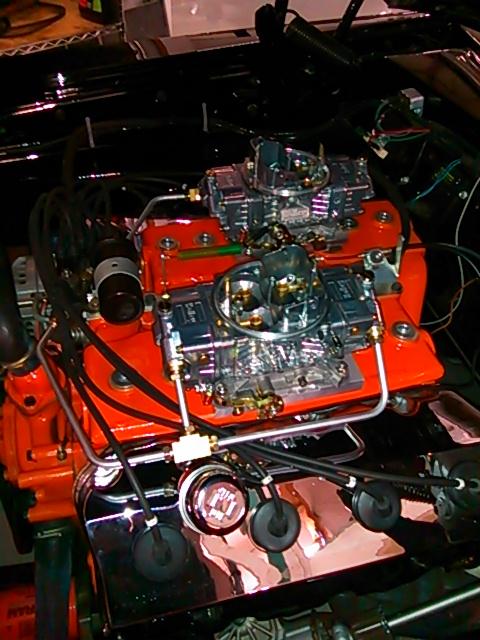

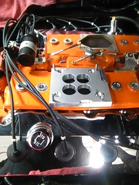

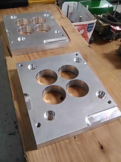

So I decided that most of my drivability issues are because the carbs are mounted side ways. I think fuel slosh in the the bowls is the culprit. From the factory they had Carters mounted forwards and no issues. Holleys are not designed to be ran side ways. I machined these plates to turn them 90 degrees and drilled some new mounting holes in the intake manifold, the installation is all most done I'll let you know how it goes .

That's some nice work!

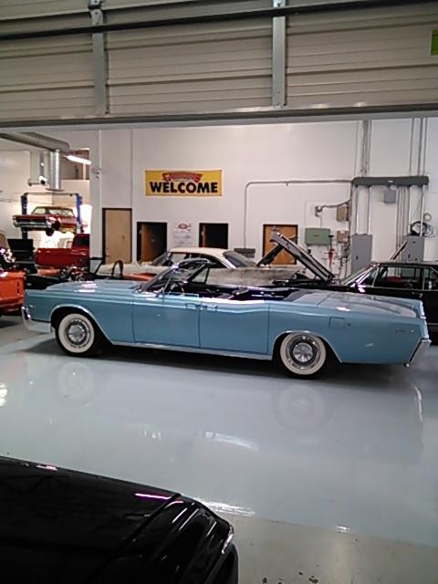

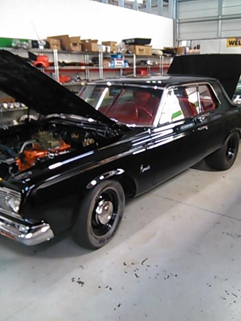

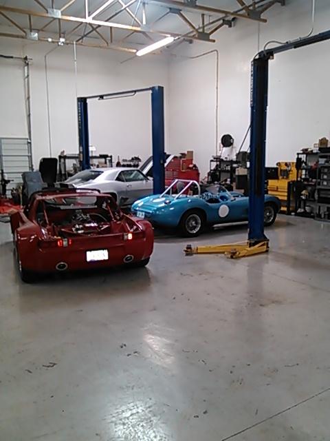

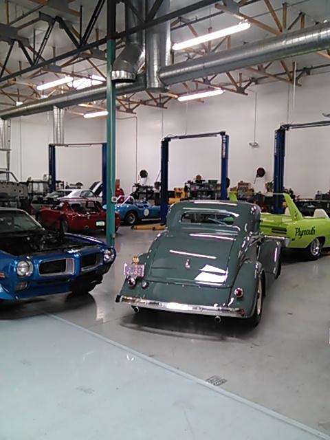

Here is a 66 Lincoln in the shop for minor repairs and some other pics you might like. These were all taken today , the shop is all most full we have had 34 cars in there many times thats about all she will hold at one time . thanx for looking.
Nice, Dave! Wish I had a garage like that!

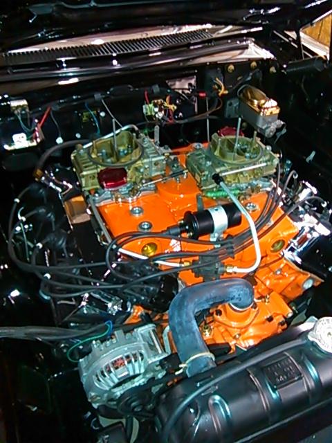

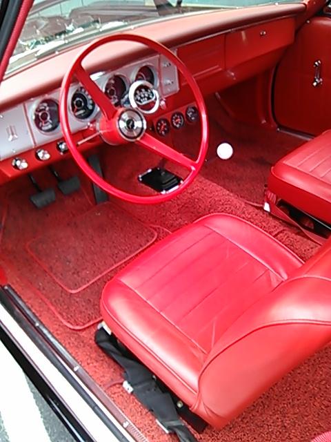

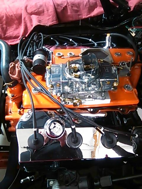

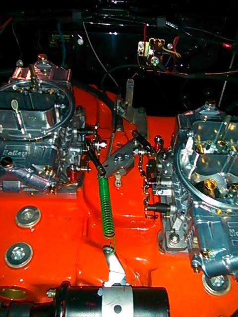

Back on subject , reworked throttle linkage, got the new plumbing in, cockpit ready to go, and lots of tire.  Im gonna go try it out , I'll let you know how it goes .

Re: 64 Plymouth Savoy
« Reply #20 on: December 04, 2014, 04:55:47 AM »
Hi Dave, thanks for showing us, hope your roadtest went well. Just a question - from the first photo it looks like just that one green throttle return spring, are there any more?  In Europe, the criteria for many types of motorsport mean you're unlikely to be allowed through scrutineering (especially if there have been any modifications) unless you have at least two independent positive methods of throttle closure (I've surrendered my International rally licence so haven't got a current MSA 'blue book' or FIA 'yellow book' to get the exact wording) - and that green spring already looks maybe a bit tired?

« Reply #21 on: December 04, 2014, 10:17:11 AM »
The spring looks to be "Progressive", wound at different pitches.
And Dave do those seats rotate to assist in entry and exiting? I remember Chrysler offering that feature back around that time. Sure wish they were still offered for those of us that can remember them and now need that feature badly!

Good evening Gentlemen, I took her for a test drive and let me just say this, the amount of Brute Force and Violence that car now has is incredible. It was pretty good before but now with the double pumpers and mechanical secondaries it is truly unreal. My drive ability issues are a thing of the past, you can actually drive it normally and enjoy it . Jump on the loud pedal and look out . It is really a dangerous fast car . As for the Questions , the seats don't swivel I think the factory was trying to save weight so they kept it bare necessities. There isn't even a back seat.  The throttle spring, you are correct it needs 2 and has 2 I just didn't have it on in photograph . (good eye). And for the automotive pornography , that last pic I posted is a nice look under her dress.......... Just sayin .
   Thanx for the interest guys have a good night    Dave .                 (ps those are progressive throttle springs)
