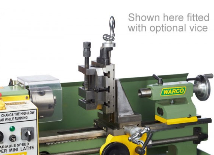

Has anyone any experience of mounting a slide like this on the Sieg S3 lathe.
They look a lot more useful than the tiny slides sold for the 7x lathes, and do not cost much more.
Warco sell them as a mini lathe milling attachment, but sell the smaller versions too.
Are these a useful upgrade, or too big to be practical on such a small lathe?
I would anticipate drilling new mounting holes to put the slide in the middle of the cross slide as per stirling lad's picture.

Offline ian_in_the_midlands
  • Posts: 65
Re: Milling on a mini lathe
« Reply #12 on: November 26, 2014, 08:21:54 AM »
Hi Norman,
What I think you are describing is my option 2, but using a block of metal rather than an angle plate. Am I right?
My issue with this is the cross slide on the 7x mini lathe is poor.
Wouldn't the slide I pictured in my last message be far more rigid?

Offline nrml
  • Posts: 262
« Reply #14 on: November 27, 2014, 01:45:59 PM »
Hi Ian,
Oddly enough, I have been researching this too recently and here are my opinions for whatever they are worth. Forgive me if I am stating the obvious.
1. The cheapest option is using your existing top slide but if your mini lathe is anything like mine, the build quality of the top slide and the amount of backlash in the screw would make an already difficult operation (milling on a machine with lots of limitations) even more infuriating.
2. The option with least limitations on workholding is the ARC offering along with their sub table. However, it is the most expensive option and I am not convinced you would get your money back if you flogged it on ebay when you get a milling machine eventually.
3.The warco option you showed earlier looks more versatile than the basic mini lathe vertical slides on offer, but it isn't very cheap either especially if you add the £40 it will cost for the vice. However, you can split the slide and vice and dispose of them separately possibly recouping a bit more.
4. The bracket mounted or tool post vertical slides sold by most of the usual suppliers like RDG, Warco and Chronos etc etc don't appear rigid enough to me.
I would go for the warco option because it will probably be the easiest to dispose off if you find that you don't like it. However, if money is not the limiting factor and if you'd rather keep the slide than dispose off it when you don't use it anymore, the ARC offering  would make more sense.
  • Posts: 65
« Reply #16 on: November 27, 2014, 05:06:07 PM »
That is about the conclusion I have came to nrml.
The arc slide, with the additional table is too much.
The Warco option looks more versatile with the T-slots, but I am surprised that I can find no pictures so maybe there is a problem with fitting.
I saw them at the Warwick show a few weeks ago. I wish I had taken more notice.
Offline nrml

Offline nrml
  • Posts: 262
« Reply #18 on: November 27, 2014, 05:15:03 PM »
Why don't you ask Warco what the distance between the centers of the two mounting bolt holes are? If that is right, it shouldn't anything major doing to make it fit.
