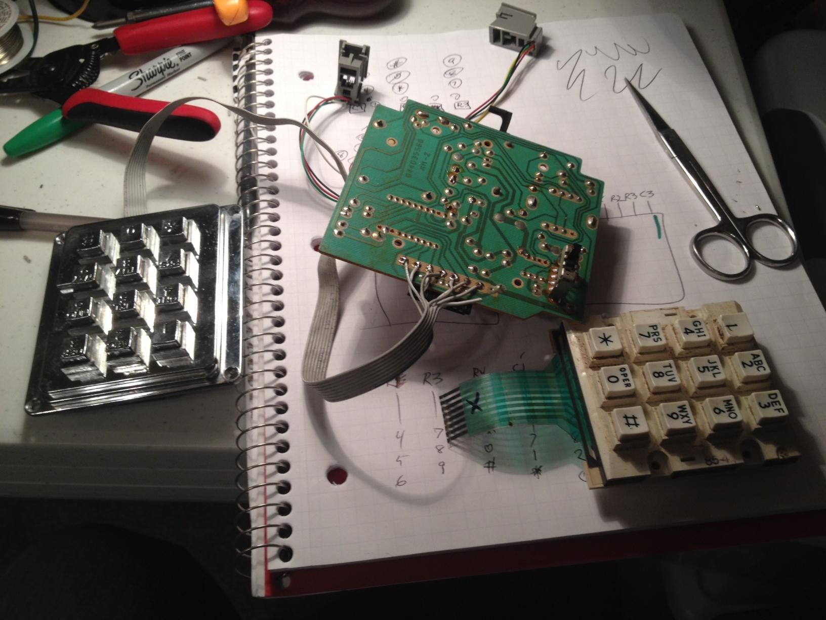

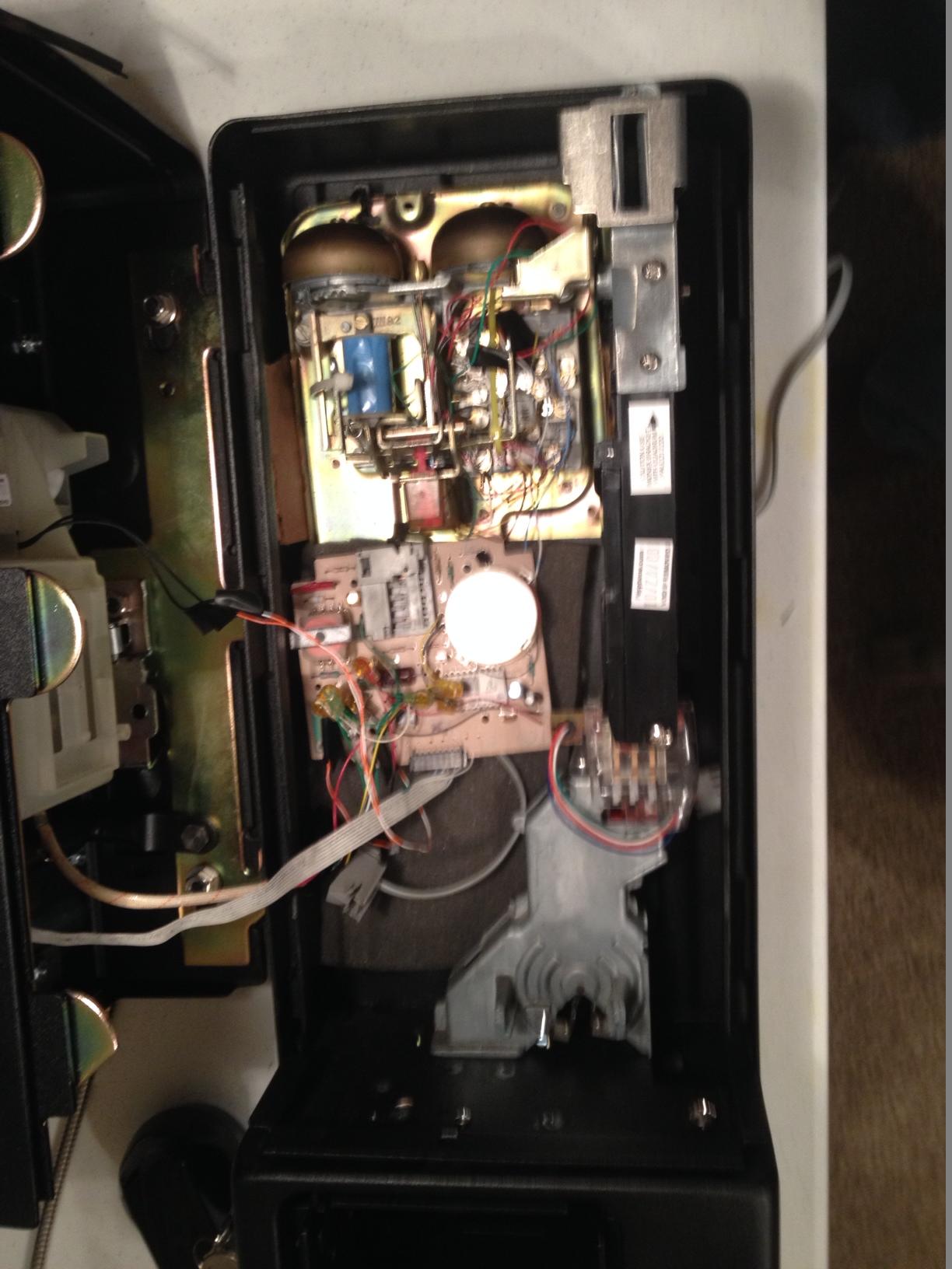

I got a free single slot, touch tone pay phone from my company when they decided to remove them from service.  They are no longer needed with the number of cell phones being carried.  The controller board is fairly complicated and there is not much info about them, so I decided to remove the insides and replace it with the guts from two 2500 standard analog desk phones.   The older desk phone had the two bell mechanical ringer and the newer one was all electronic on a single circuit board.   I used just the transformer and bell from the older one and wired the keypad and handset from the pay phone into the newer circuit board.  Fortunately the keypads are fairly standard 7 wire hookup.   It was just a matter of identifying the  3 column and 4 row wires on both the pay phone and desk set and then just connecting the pay phone key pad up.   Hand set was done the same.   Just figure out the ear and mouth piece connections and hook them up.  The switch hook on the payphone is a simple reed switch SPST normally open so I connected the green (L2) wire from the phone line to the green wire on the circuit board and then connected the red (L1) wire through the switch hook.

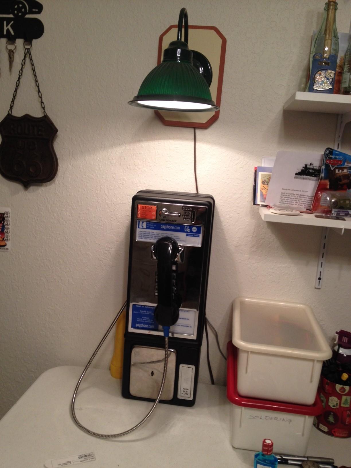

On the coin mechanism I put in a screw to keep the coin gate set to always send the coin to the coin box and not the return slot.  Pretty simple to do in only a couple of hours.   Now have a pay phone sitting on my work bench that works perfectly with an old school dual bell mechanical ringer in it.   Total project cost was under $10 for the phone cord to plug into the wall.   No external power needed.
You can drop coins into the coin box, so I guess it will be my piggy bank.   Also have the keys to it so I can get the coins out.
