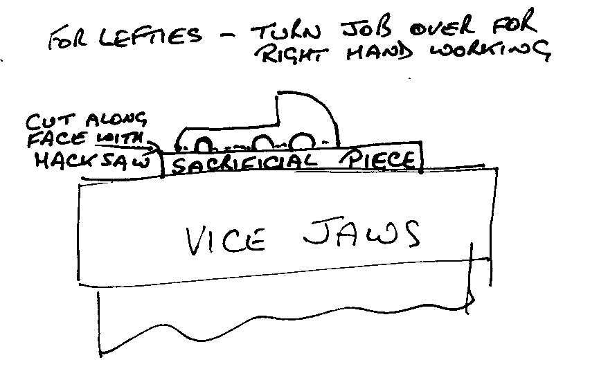

My slitting saw didn't like SS  :( So I attacked it with a junior hacksaw..... :dremel:

bogstandard
Re: Twin Cylinder Steam Engine
« Reply #131 on: May 01, 2009, 12:53:05 AM »
Darren,
Unless you are really sad like me, forget SS here, you might find brass to be much easier to work with
I was wondering how long it would take you to realise that barbed wire knickers hurt. Those crankwebs were a good example of self flagellation.
But you have done a great job with what you had.
Nothing against the way you did your slots as you achieved the correct result, it is just that I would have used a slightly different method to obtain the same result. There are always more ways to get the same results, and by showing them, people can choose the way they want to go.
The pic shows how I do it. If you take it steady, you can get results as good as a slitting saw.
I drew it up incorrectly, so I put my excuse at the top of the sketch. Makes it look like I am one of those brainy lefties.

Nice tip on sawing there, mine are off a bit but ok.

I did swipe the tips of the drill bit to take the edge off, though I don't know how much this helped cos I wasn't taking any chances with a sharp one.
You could say I'd had enough of frustration by then  :lol:
Thanks for this little tip John, all added to the database for future ref  :thumbup:
