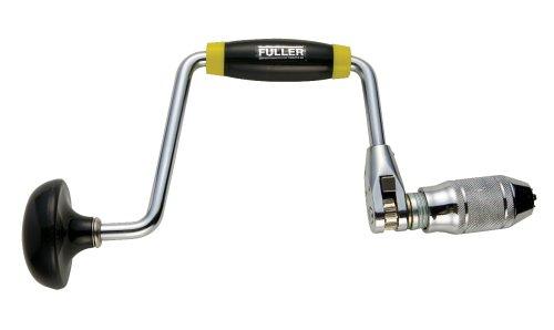

I have been looking for a long time for a drill 4 jaw chuck to put on my tapping machine
and came across this on amazon.
Fuller Tool 890-1072 12-Point Reversible Ratchet Brace with 4-Jaw Chuck
http://www.amazon.com/dp/B000BDISDC/ref=pe_385040_121528360_TE_dp_1
We will make some king of adapter for this brace, chuck. :headbang:

Just a little worried on how true the tap will be held (as that brace may have tapered jaws) and how much run-out it'll have.

Yes bit braces grip tapered square bit ends. This is because end thrust is important.
Why couldn't you use a regular tap wrench for parts? They use a collet closing action. if the collets were replaceable instead of built in (the way a pin vise works) you could make a range of 4 finger collets.

It might work Ivan if you change the jaws. Remember, they grip on only 2 corners, btw -- they are 2 jaw, not 4 jaw. The bit grip length is much longer on a brace bit than it is on a tap.

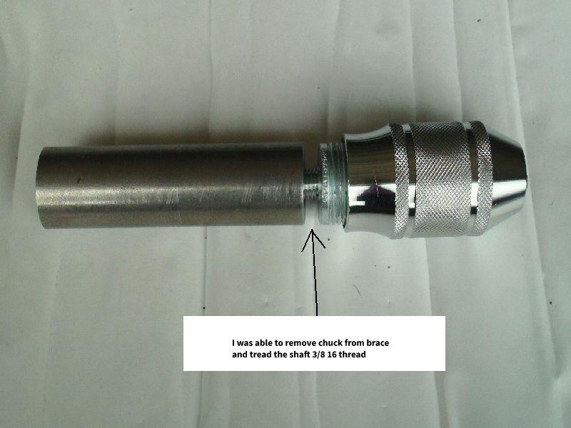

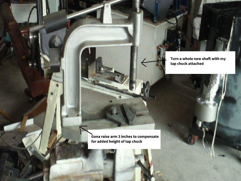

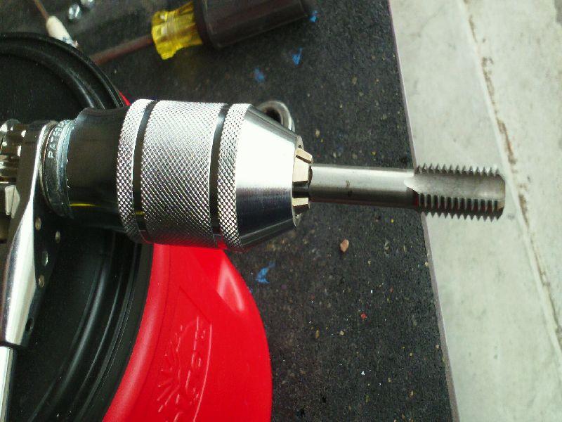

 :ddb:  Okay guys,  got the brace drill today and couldn't wait to tear it apart.
The taps fit nice and snug with no movement.  I got a tap chuck..... :drool:
Check out pics. got explanations on pics.

Hmm, mine only has two jaws with a vee-groove in it. Yours has 4 -- much better!

That's coming together nicely!  :thumbup:
