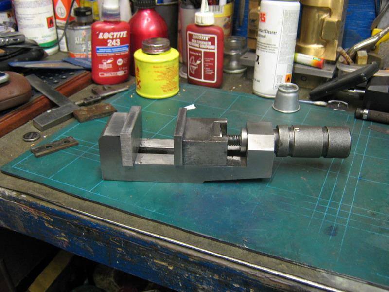

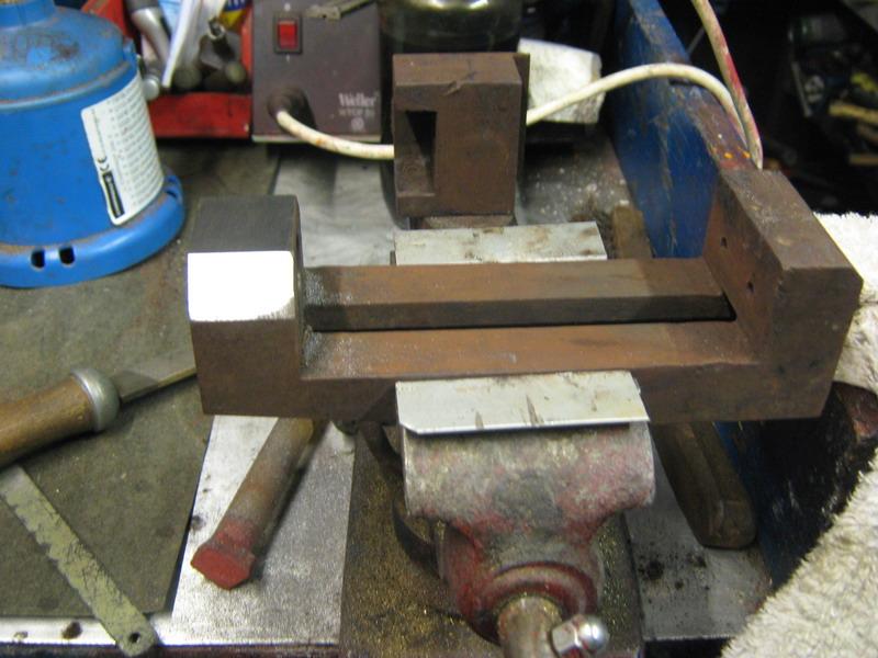

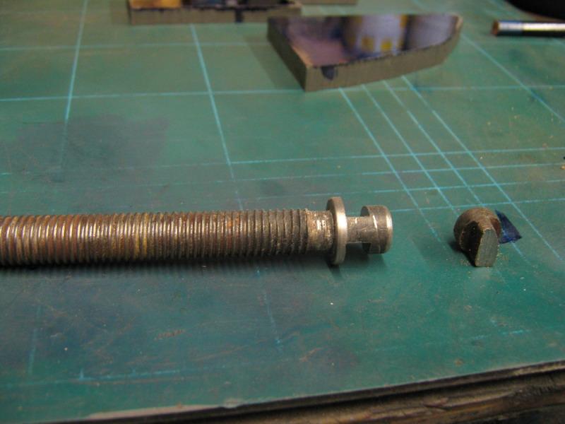

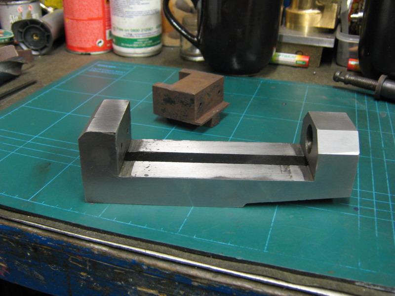

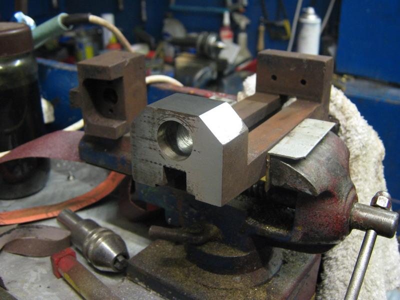

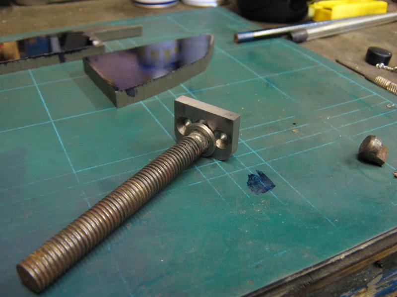

hi all i was given this vice sum time a go so i decided to clean it up if i was at work i wood have just gone over it with the surface grinder but i had to settle with a file and its still square next thing to do is the slide and vice jaws

« Reply #2 on: August 14, 2014, 02:54:07 PM »
 Hi Bob, I love to see hand tools used.  I went through a stage when younger when I used power tools for every job.  Then I became interested in hand tools, and use them whenever practical. I like the feel and accuracy you can achieve, and I find it much more satisfying.

krv3000
Is your vice a drill press or a milling vice. Nice project. That was the way a man was trained to start with. If he could master that he moved on, if not he got the boot. Nice work looking for the finally.

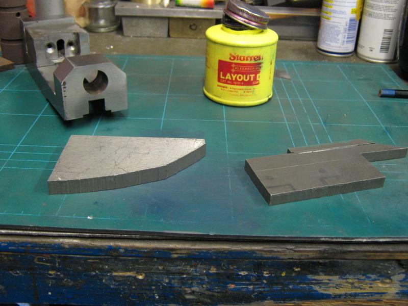

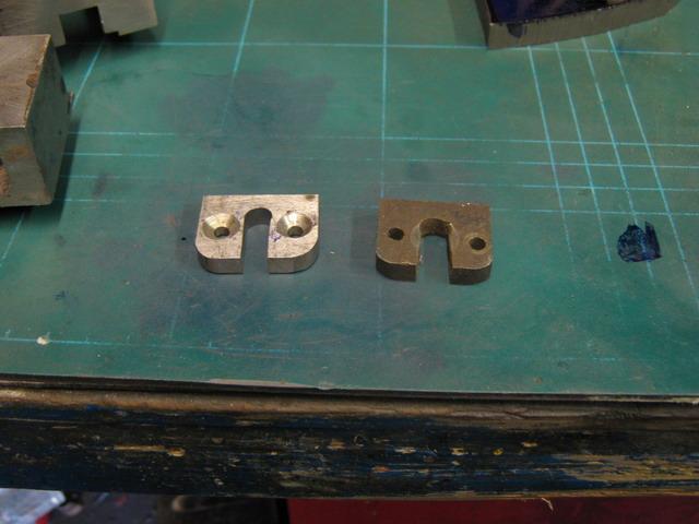

« Reply #4 on: August 18, 2014, 10:41:50 AM »
hi its still on gowing as to the type i beleve it to be a vice to be used on a surfice grinder normely nown as a tool mackers vice when you served your time its one of thows things you make i hope the maker of this one improved as time whent on will post mor pics i had to replace the tope of the scruw that a taches to the moving vice jaw and make a new plate as bin biz with other things so its bin shuved to one side

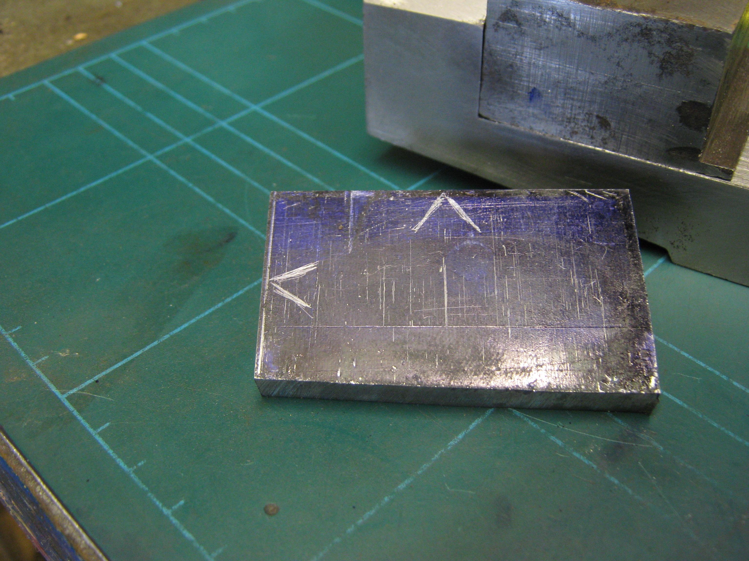

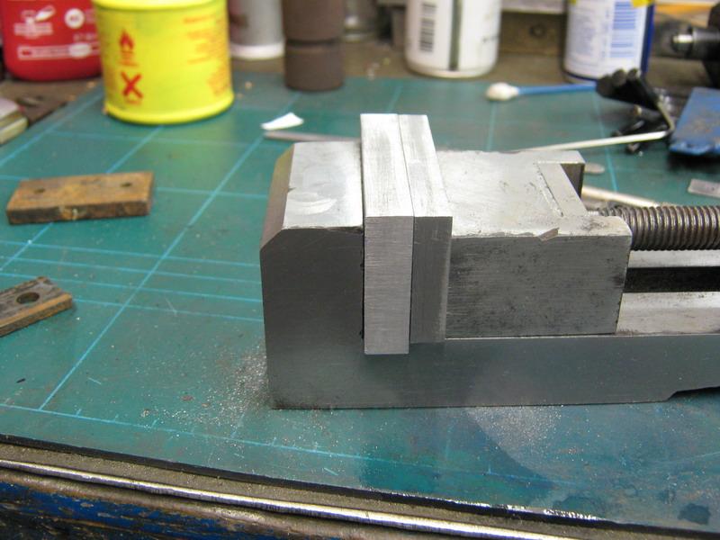

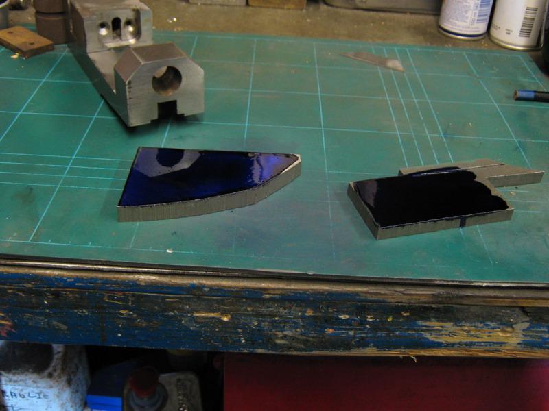

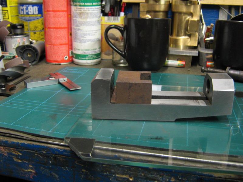

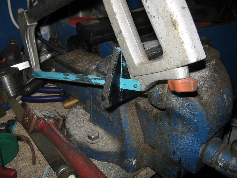

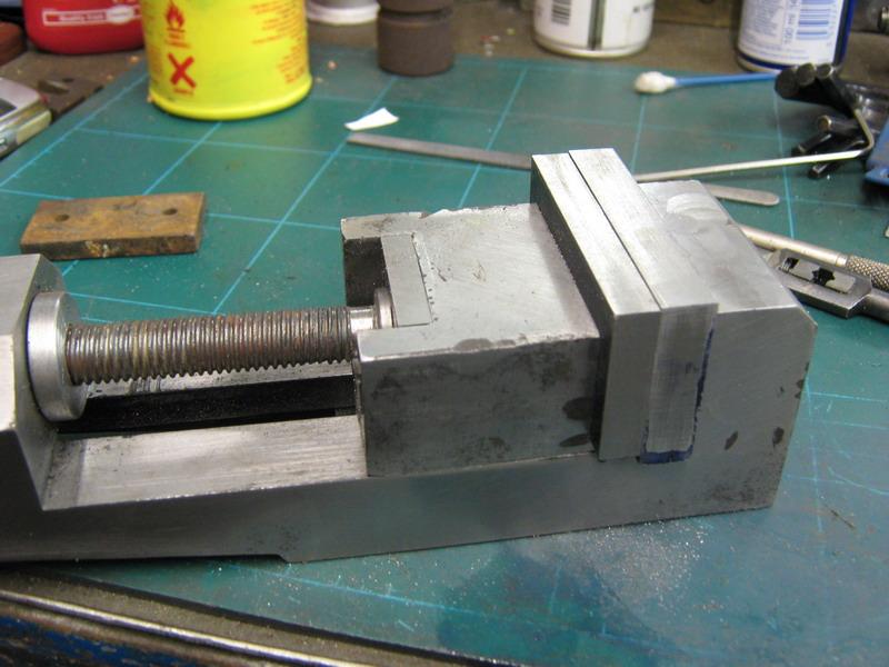

« Reply #6 on: August 24, 2014, 03:30:21 PM »
hi sos for the delay a part from hardining the new vice jaws its all dun i wil cheet with the jaws as they need hadening and i will grind them flat and grind them to sise when ther back on the vice pics

« Reply #7 on: August 25, 2014, 08:01:55 AM »
            Coming along nicely Bob.
