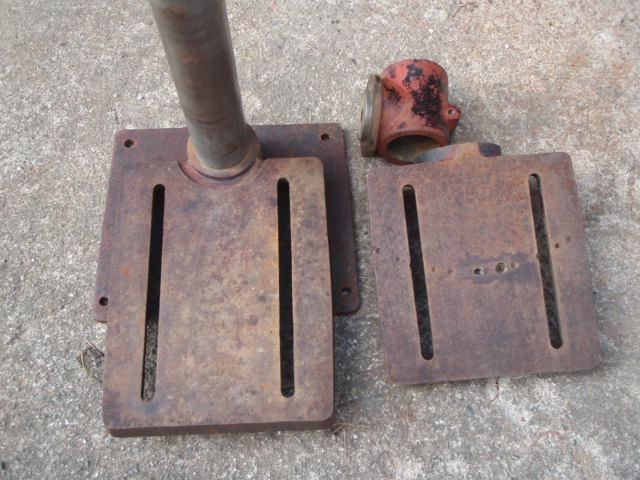

Exelent! And I can get that Fast orange here (Finland) too. Finally something good about globalisation!

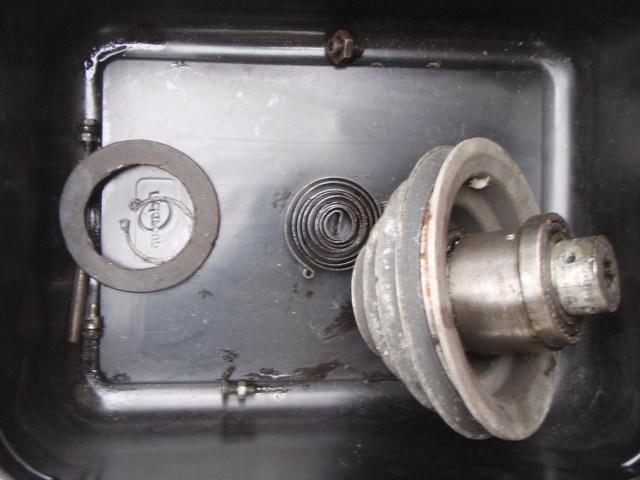

Yesterday I disassembled partly the drill head to use some parts of it. Looks like the moving spindle assembly/body fit is exccelent. Maybe I should try to fix the spindle bearings and that. Really funny english contraption. Some parts are really nicely done and some have shortcuts.
Now, the dilemma: The spindle head has some good fits and I don't want to destroy them. Plan:
1) Grease/gunk removal, I'm going to try fast orange.
2) Rust removal: Fast application of citric/phosphorous acid mix.
3) Wash with metal wash detergent
4) water removal - I'll try IPA
I'm putting here some pictures.
Allication of drain cleaner (PH10 or something caustic soda)
Then I dunked them in mild citric/phosphorous acid mix for overnight.

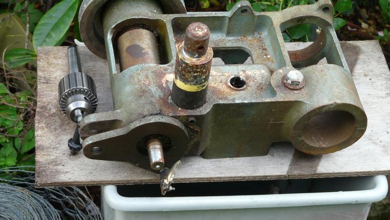

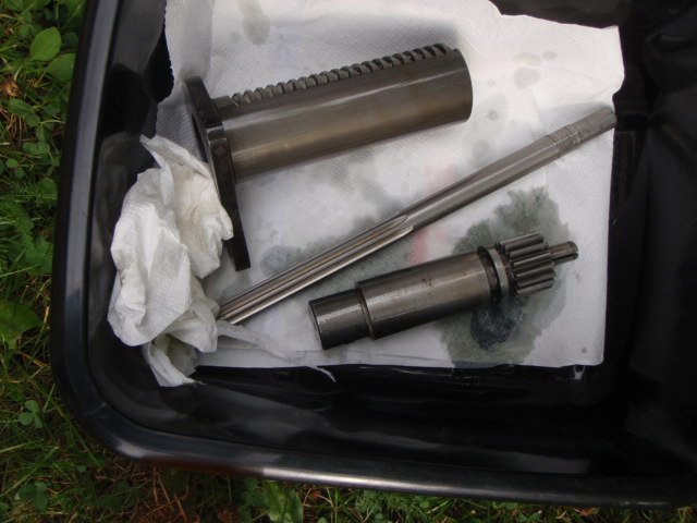

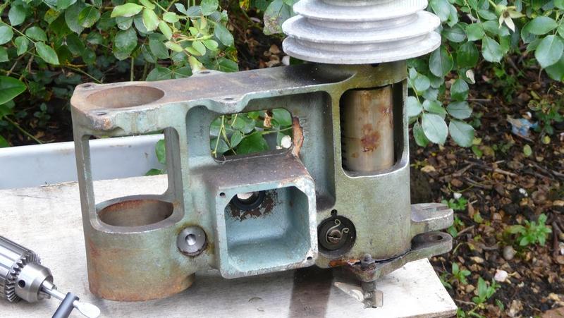

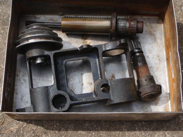

« Reply #10 on: August 09, 2014, 10:05:35 AM »
Some more progress.
Spindle is shot. Bearings are pretty loose and some parts have clearance.
Drill chuck is Kawasaki! It looks like it is beyond repair, but I'm tagging it along and see if bring myself to disassemble it.

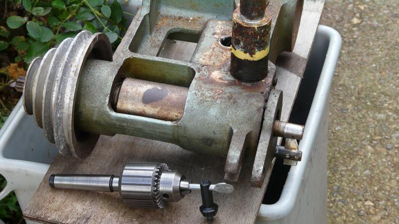

« Reply #11 on: August 10, 2014, 02:01:08 AM »
There is one thing I wonder:
This three step pulley has two bearings. They seem to be grease lubricated and shielded. However on top the pulley there are two conical holes with stamped "Oil" in them. Is this just case of using old stock pulley after product design? Someone might have changed the bearings.
The spline shaft looks very nice, but awfully skinny for my purpose. I was surprised to find that splined hub was made of plastic that appears to be nylon, judging from the looks of it.
Not sure if the pulley assembly will disassemble civilized manner.

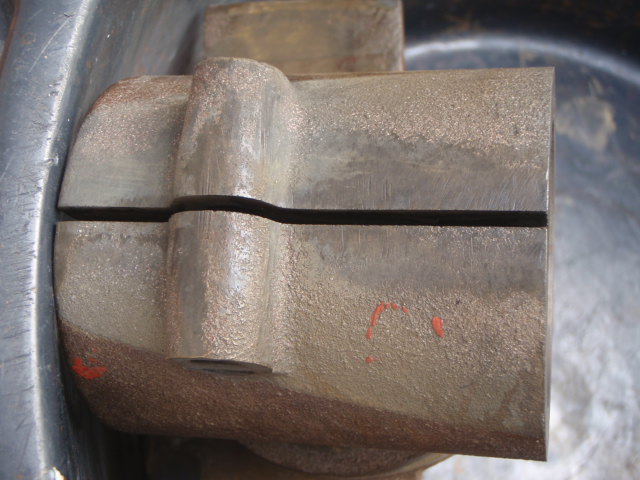

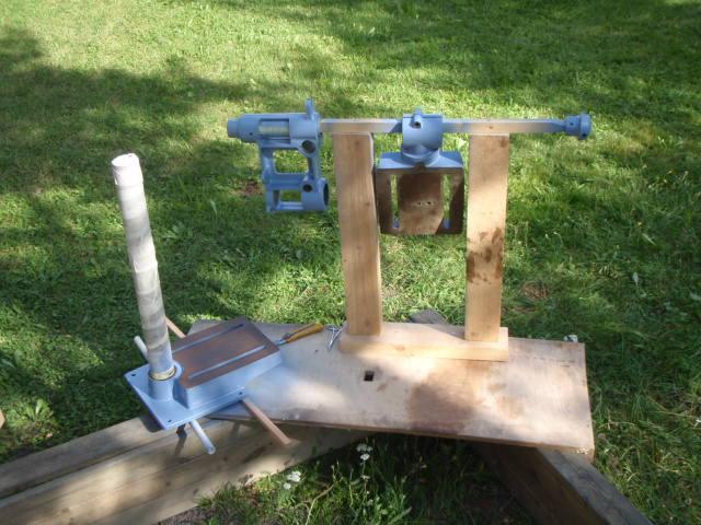

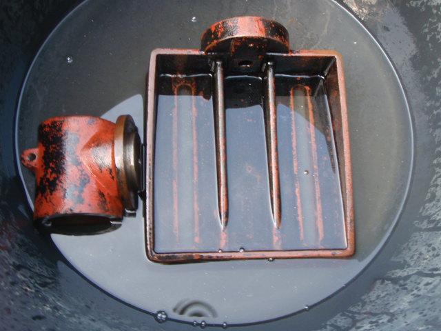

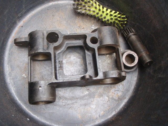

« Reply #20 on: August 17, 2014, 02:55:20 AM »

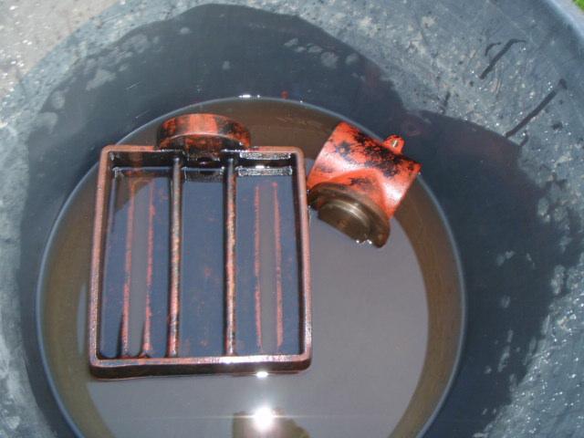

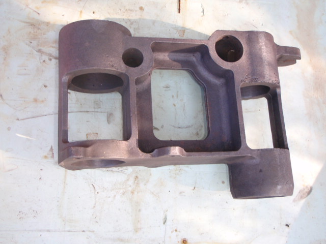

Bit more preparation and paint removal. It has been raining here and mys "shop" is outside with these dirty works.
I tried fast orange and it does removes grease, gunk, dirt really nice when assisted with a nylon brush. It does not seem to remove the paint I have on cast iron though. I have one sticker removal spray that has citric oils etc. and it does good job removing sticky glue.
I found out that unheated liquid drain opener right from can is a lousy pain remover. It does something but not very fast and if you let it soak for hours you exchange paint for rust.
First two pics on this experiment.
Then again when I used four litres of 70C water, laced with 0,3 litres of granulated drain opener (caustic soda?) and applied it to preheated chunk of cast iron and paint was removed in 15 minutes excluding few corners and spots. I applied some steam and that too was cleaned fast.
last two pictures on this episode
I'm very sure that drain opener/caustic soda/alcaline would be a really bad idea on aluminum, thin it would bad also copper metals?
Grit blasting would have worked really nice on these I had the means.
Re: How to paint cast iron?

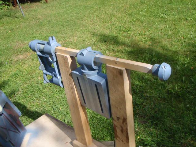

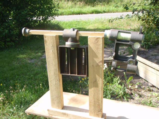

« Reply #21 on: August 17, 2014, 02:29:22 PM »

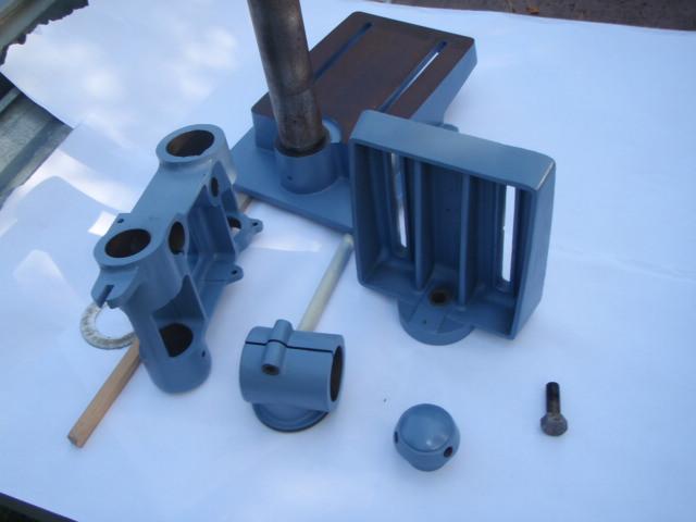

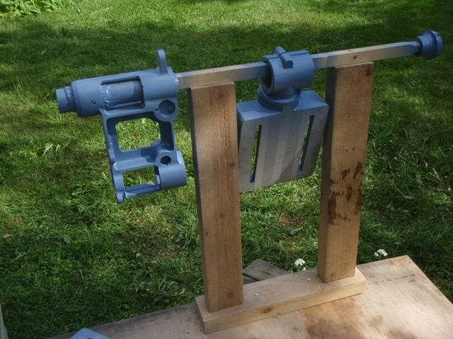

A little update. I wonder if anybody reads this, because this is pretty basic.

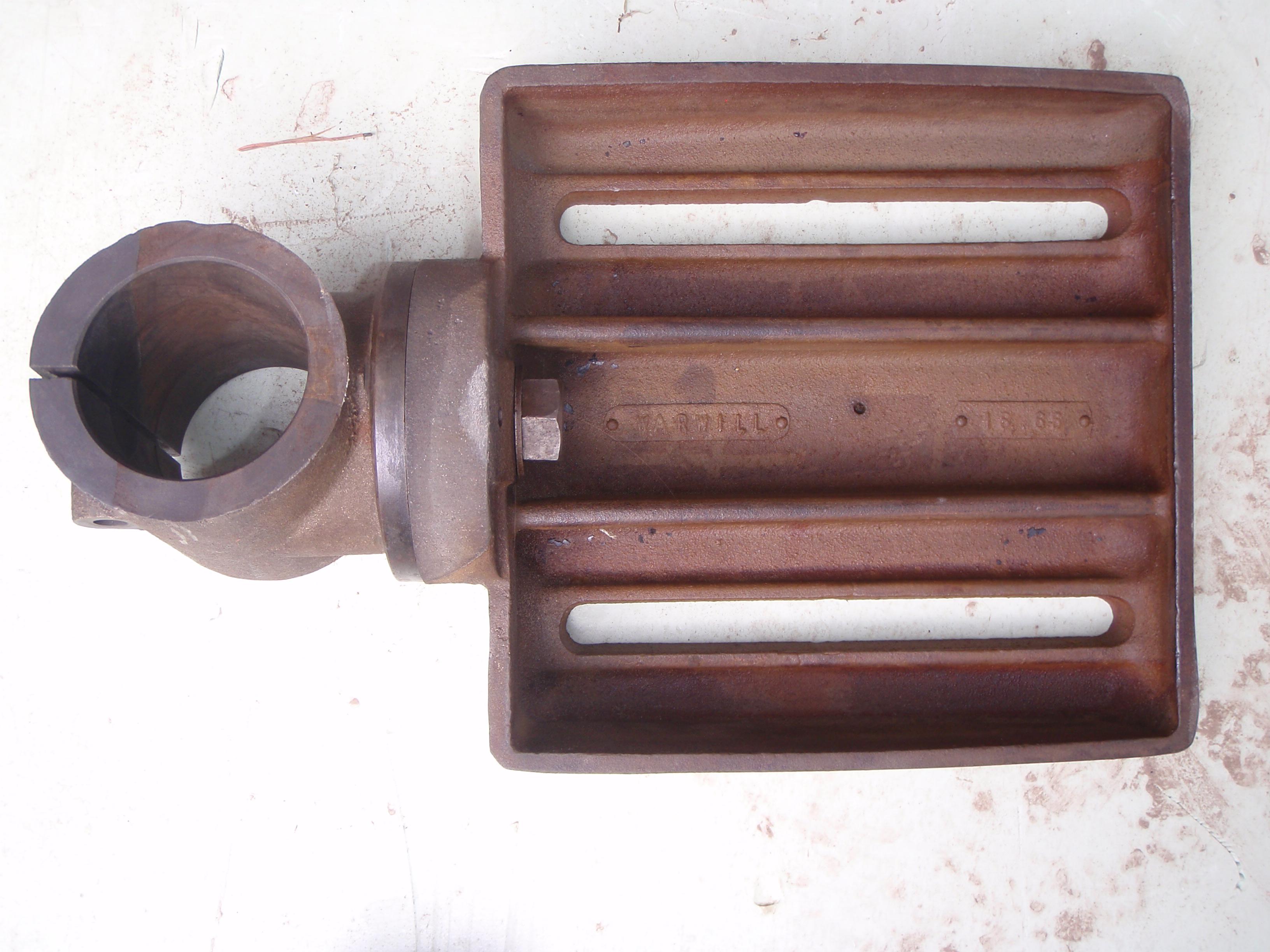

Anyways, I washed the stuff, Dunked them into heated mild phosphoric acid and dried with hot air blower.
Then I taped and masked the heck out of them and hung them.
I got no runs, but some parts were left a little on thin side. I didn't fill or sand them at all.. Just sprayed one thin layer, let dry 30 mins and sprayed final layer. This is recommended on this paint. It has some inhibitors and its possible to paint it on wet on wet as a single medium.
I'm pretty happy with it. I didn't try to make it a show piece, just nice to work on.
Some pics.
1) Masked and hung
2) First thin layer, had to give small tired compressor a break.
3) Second layer.
4) Unmasking took almost as long time as masking it. I was afraid to glue masking tape somewhere painful to reach.
5) Masks out. Have to let them dry overnight.
Haven't done much spraying long time and it shows. Next time I might even use filler. happy I didn't use it today. This was my only whole day off and weather report is threatening plenty of rain for the rest of the week.
