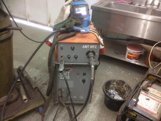

When I was doing some heavy welding recently, my Butters AMT 3205 MIG welder decided to play up - the gas solenoid was going all the time. Gas valve is in the remote WF2 wire feeder.
So today it came to the top of the list to sort out
Re: Back from the Dead !
« Reply #1 on: August 02, 2014, 08:33:09 AM »
Opened it up, and looked at the valve - just check is it permanently being powered, or is the valve stuck.
Ah - fault symptoms - what fault symptoms  :bang: You guessed it - fault gone. Now it could just have been a bit of muck jamming the valve, or the electronics could have been driving it, but no telling now .
So I decided to get a spare valve and keep it in the wire feeder as a spare, but what threads and what voltage coil? Coil is easy, having pulled it out it's marked as 42V AC - a bit odd but that's what it says. The threads - female both end - first glance say 1/8" BSP, but when I measure the male spigot screwed into one of them it is spot on 0.375" ie 3/8" with 28tpi - but 1/8" BSP is 0.385" major diameter.
So I reckon we have a rather bad fitting 1/8" BSP - anyway that's what's on order  :scratch:
