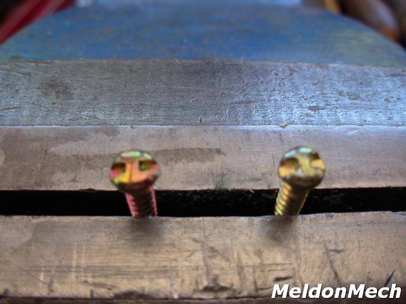

Hi Guys

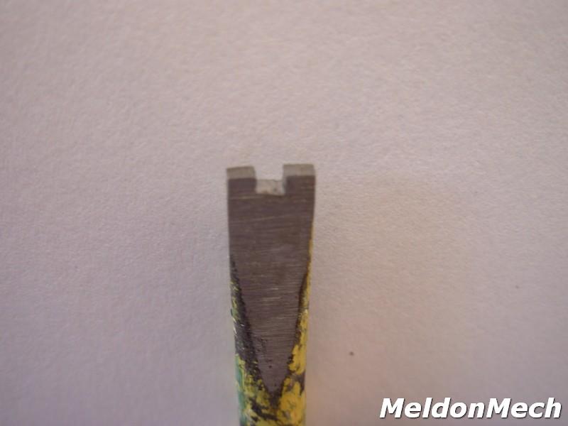

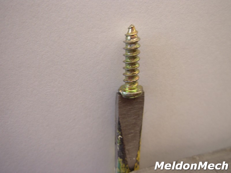

               More and more I am coming across those horrible screws where there is a lump right in the middle of the screw head slot. Often they are recessed into a hole which makes extraction even more difficult.  This called for a mod to one of my old screwdrivers.
                     A slot was sawn in the screwdriver blade then finished to size using a square needle file, to fit the corresponding
 screw head. This works perfectly and different sized screw drivers are on the to do list.
                                                       Cheers David

On a serious note, the packs of hexagonal security screwdriver bits often aren't suitable to extract security screws from deep recessed holes due to the diameter of the socket style screw bit holder being to large in diameter to fit down the recessed hole that the screw is located in.
The best and most versatile solution is to purchase purpose made round shank security screwdriver sets to suit the most common applications encountered.
Another solution to extracting awkward security screws in a deep hole is to use a Dremel disc to cut a straight screwdriver slot in the driven end of a hexagonal security bit and use a straight blade screwdriver to turn it and the offending screw....OZ.
