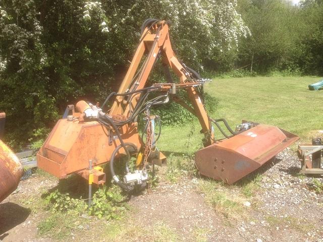

Several years ago I bought a Twose 276 Hedge Flail. It originally would have mounted on 'axle brackets' but this one had been converted to mount on the standard 'Three Point Linkage'. Theoretically this makes it easier to mount and also able to be fitted to any tractor with a three point linkage.

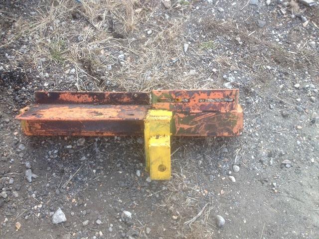

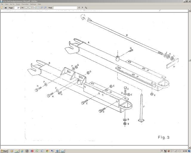

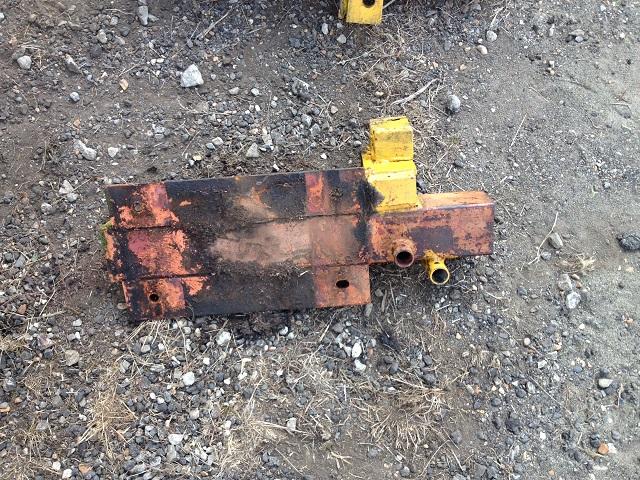

The original 'fore and aft' spars on the flail had been chopped off and brackets welded on for the three point linkage. Now these spars are 100 mm square box with 6 mm wall thickness, and I had intended just to weld bits back on to bring them back to the original length. But thinking of the huge torque that they have to withstand I decided to replace them in their entirety. Theoretically they just bolt onto the very substantial hydraulic tank, but it remains to be seen how easily they come off.
This is what they looked like according to the parts book, which is the only documentation that the original manufacturer has after suffering various take overs

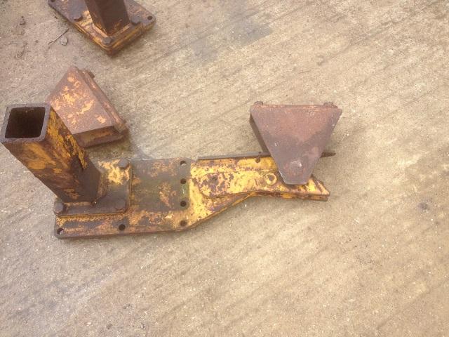

A set of brackets designed for my tractor (Ford 4600) but for a different flail turned up on eBay - they were for a Bomford and he also had the 'jaw fittings' which are rather more self-aligning than the Twose ones (which I couldn't find anyway)

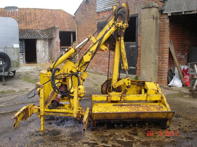

So having at last completed the change of the right hand axle oil seal yesterday I could mount the brackets and start deciding how to glue the lot together.
Here is a picture of a Bomford flail with very similar brackets

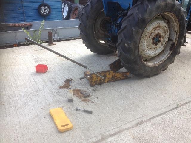

So this morning I started unbolting the jaws from their original mounts - easy peasy - just four nuts and bolts on each - well not quite - they we unbelievably tight and I had to resort to unothodox methods to hold the bit down while swinging on the 3/4" socket drive with a long pipe

So having got them off, I mounted the jaws on the brackets, which I'd bolted to the axle yesterday

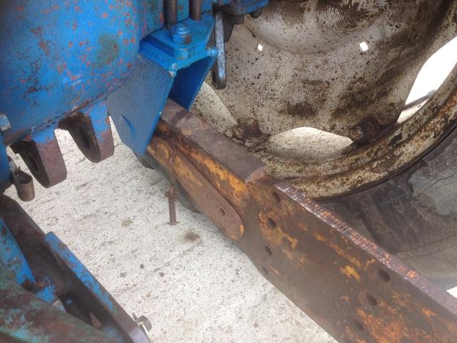

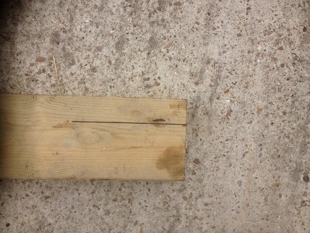

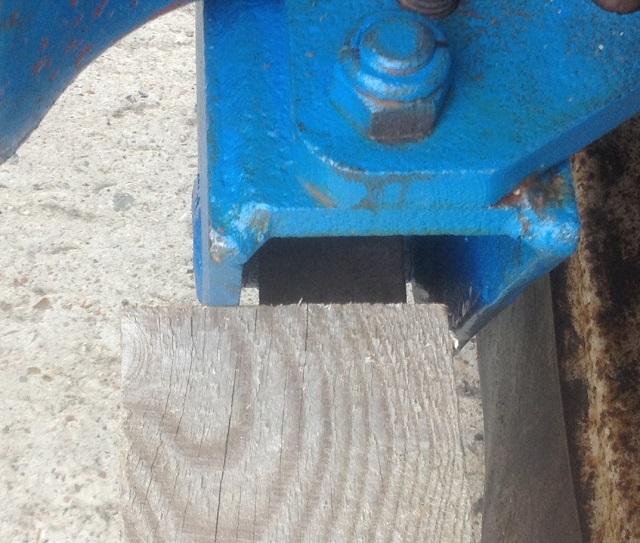

This allowed me to start measuring up how it would interface to those two spars I was about to make. I had made up a timber 'mock up' of the spars accurately set to replicate their spacing and width, as having the differential 'lump' and the pto gubbins in the way otherwise made measurements impossible.
First offering up implied that the 'jaws' nicely fell on the centre line of the spars - but this was wishful thinking as the jaws obviously weren't set on the stands quite parallel  :( Never mind they fall within the width of the spar - I intend to cut deep slots in the spars -insert the jaws and weld them together.
« Last Edit: July 21, 2014, 04:30:52 PM by awemawson »
  • Posts: 9051
Re: Mounting a Tractor Hedge Flail
« Reply #7 on: July 21, 2014, 06:44:08 AM »
This shows the off set of the jaw centre line in a spar end

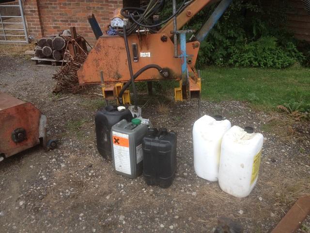

I want to remove the pump from it's umbilical pipes so that I can install it on the tractor and see how much room I need to leave for it. So I started off by draining the tank:
First assemble enough empty oil drums - this necessitated a trip to the local recycling dump where I could loose the old oil that I replaced in the tractor back axle escapade - this provided two empty x 25 litre drums. A quick hunt round found another 25 and two 20 litre drums

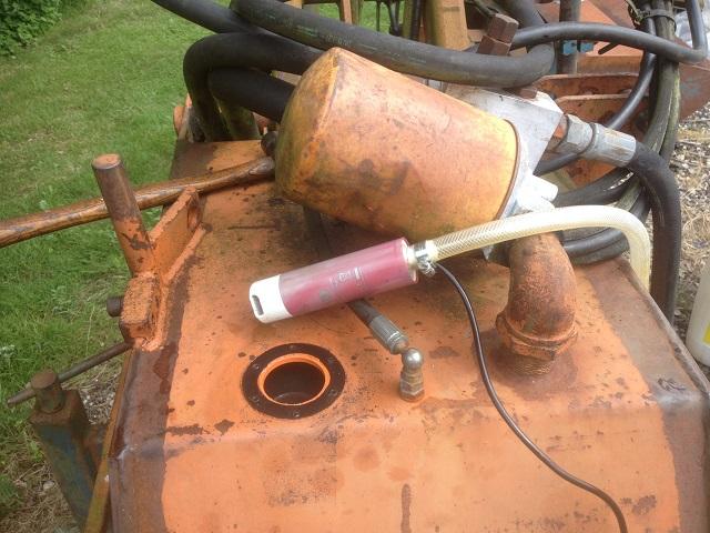

Now the pamphlet that I have on this flail says that the tank holds 25 UK gallons - so that is  about 114 litres. we have 115 litres total capacity so we should be ok - shouldn't we  :scratch:
The filler cap and filter are too small for my transfer pump, so take them off:

Hook it up to a convenient tractor standing close by and off we go.
Only a little bit of spillage - honest gov'  :bugeye:
So the level is now below the output tapping, so I've been able to remove the plumbing and measure pipe sizes (1 1/4" BSP  out of the tank - 1" BSP to the pump, 3/4" BSP out of the pump)
I've decided to use two 1 1/4" gate valves with a union between them to allow full bore out of the tank in such a way as the only oil spilled on disconnect will be the volume of the union. The output of the pump will retain an umbilical pipe, which as it is at a high level can be disconnected and stoppered without oil loss.
Order for pipe fittings placed . . . . next I can put the pump on the tractor for measurements.

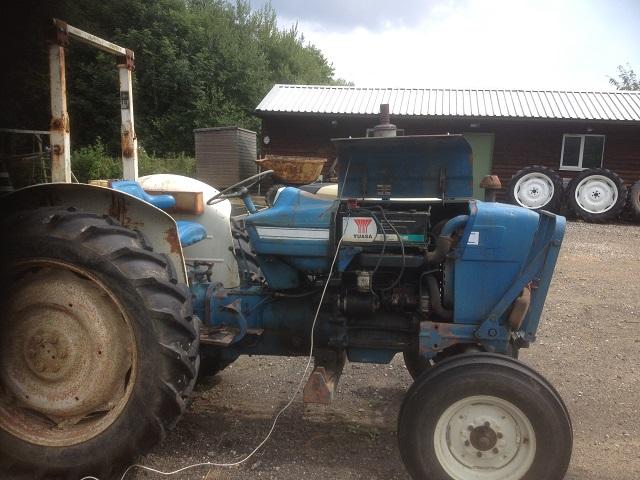

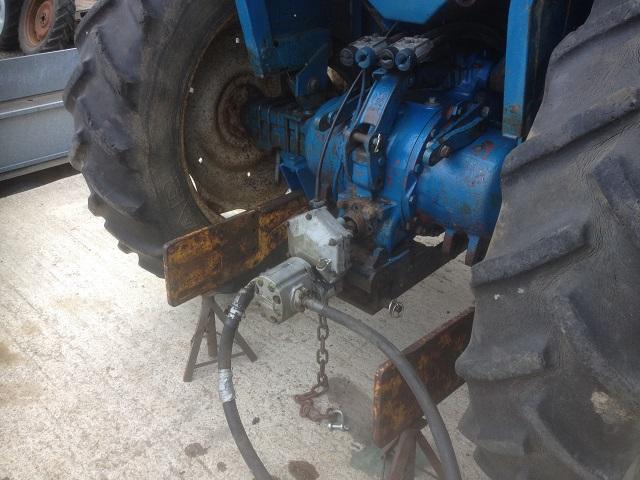

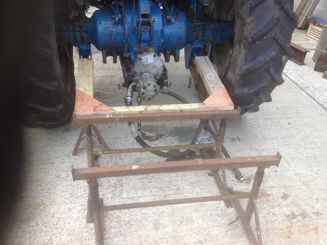

Now that the tank is pretty well empty I could remove the hydraulic pump and put it on the back of the tractor to help in measurements. Needless to say the hoses are in an atrocious condition having had the pump swinging on them every time the flail was disconnected from its host tractor. Another reason for making it detachable. The hoses are not in fact under any significant pressure but they definitely need replacing.
I had one little oops when draining the oil - there is a little plastic cap on the lower end of my transfer pump that popped off and fell to the bottom of the tank  :bang: Need somehow to rescue it so it doesn't get dragged through the gear pump.
So here is the pump mounted on the PTO shaft of the tractor:

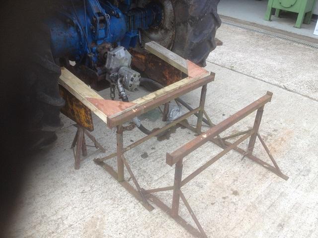

« Reply #16 on: July 22, 2014, 04:39:26 AM »

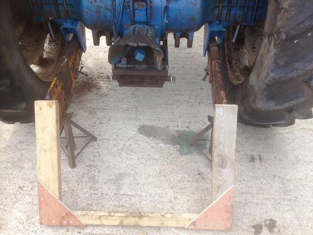

This then allowed me to make a mock up of the tank position, which is represented in these pictures by the 'builders trestles'
They are positioned in the photos as close as is possible to the back of the tractor, but I think in practise I will move the tank structure back 3" to make access a bit easier and make more room for the bracket that holds the 'control standard'. This is a 1" vertical rod, cranked like a starting handle, with the hydraulic levers mounted on it - they project about 4 foot forwards and need to 'arrive' poking through the rear window and comfortably close to the drivers seat. The crank in the standard allows some adjustment, but I suspect that it will be 'suck it and see' when it comes to mounting it.
Anyway, a bit more of the mock up. The timbers represent the new spars, and will be slotted to fit round the 'jaw plates' and welded in place - and yes I know they aren't level - hopefully the real thing will be  :ddb:

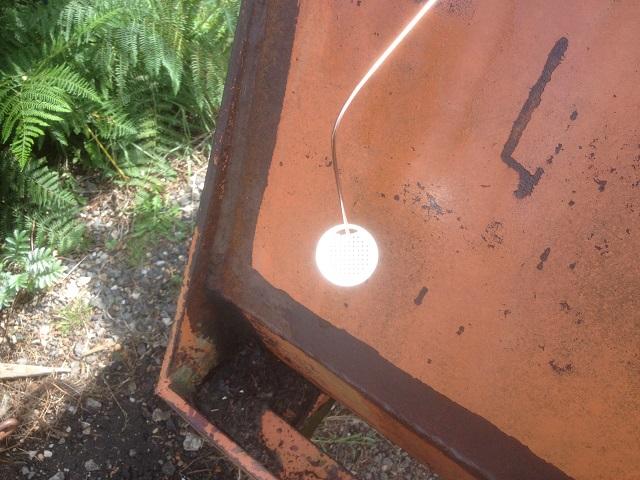

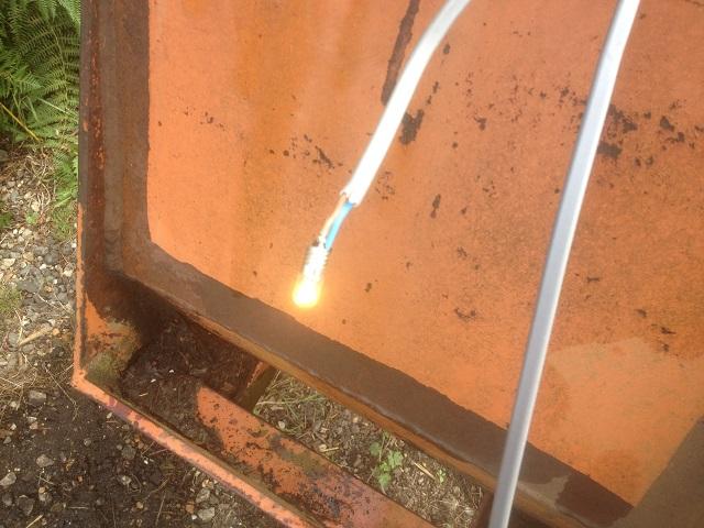

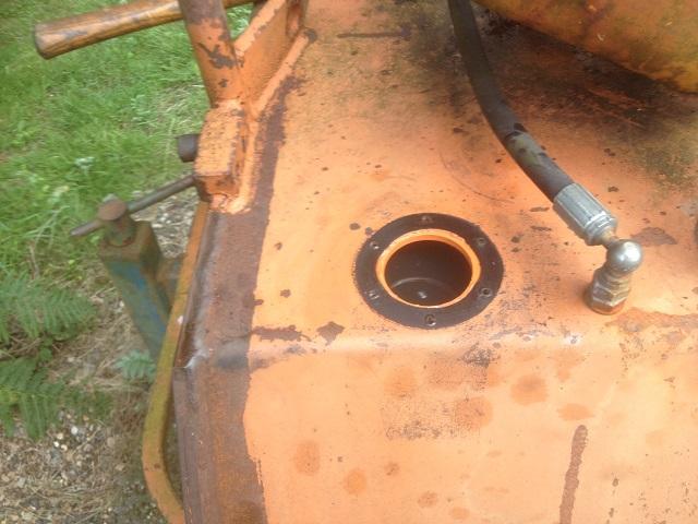

Managed to retrieve the lost plastic cap from the hydraulic tank. A torch showed nothing through the filler as it was always in the way, so I soldered a 12v torch bulb to the end of some stiff 'twin and earth' wire, poked it into the tank, and lo and behold there it was.
Harpooning with a sharpened 2.5 mm welding rod, and then hooking it up saved the day. All this is really putting off the time when I have to crawl under the tank and unbolt the original spars - just not decided how to support it yet - the legs it stands on are integral with the spars  :bugeye:

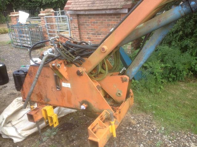

Today has been a superb morning as far as progress is concerned  :ddb:
I started by removing the 'standard' that holds the hydraulic controls - I had previously removed it so bolts were not seized. Bit awkward in that a 1" bar with a lot of weight on top slots into a pair of holes - you can fairly easily lift it out of the lower holes, then it starts wanting to twist - brought in the heavy guns, used the fork lift to take the weight, and laid it all still connected to its plumbing across the tank

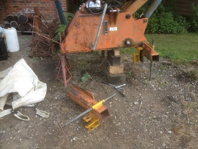

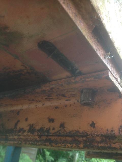

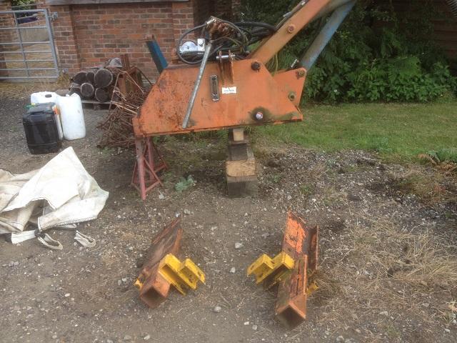

Then I started loosening all the various bolts that hold the two spars on. They were all amazingly quite easy to undo - I've been spraying 'Plus Gas' on them for the last few weeks.
But while underneath I made a VERY useful discovery. The right hand spar is mounted on a sliding 'Tee nut' arrangement, meaning that the spacing of the spars is adjustable by up to 3" - so all my worrying about exact off sets for mounting the jaw plates onto the spars is irrelevant - they can be made symmetrical and adjusted to fit the brackets   :thumbup:
« Last Edit: December 06, 2015, 05:04:38 AM by awemawson »
  • Posts: 9051
« Reply #21 on: July 23, 2014, 05:43:58 AM »

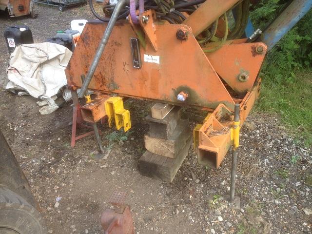

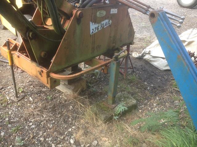

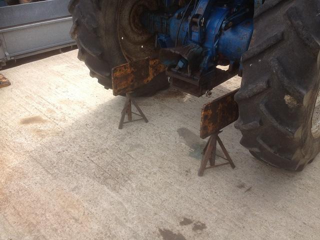

So now to support the tank so that the spars can be removed safely.
I ended up placing axle stands under the right hand side, and matching the integral jack that is at the rear with a pile of timber baulks - gently lifting with the fork lift it to take the weight off the legs that are part of the spars, and transfering it to the new arrangement.
Took a bit of fiddling, as it is now balanced on five points (the four mentioned and the flail head itself)
  • Posts: 9051
« Reply #22 on: July 23, 2014, 05:46:27 AM »

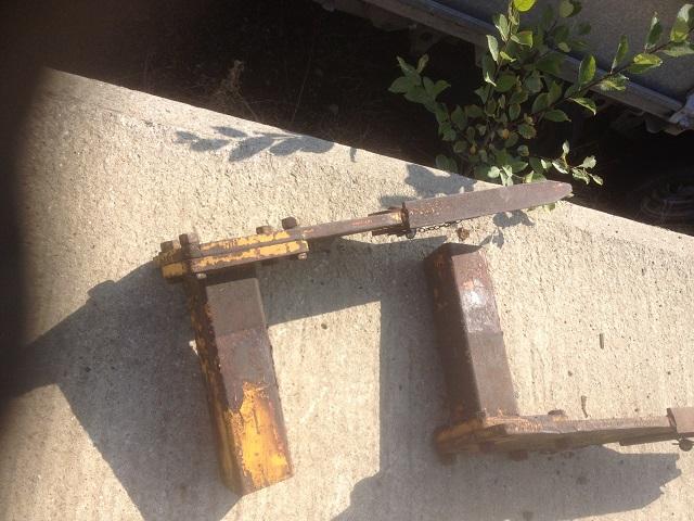

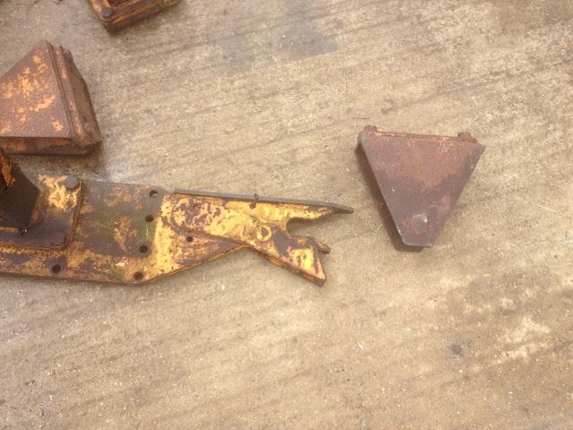

So get on with it and remove those spars  :lol:
OK here you go then:

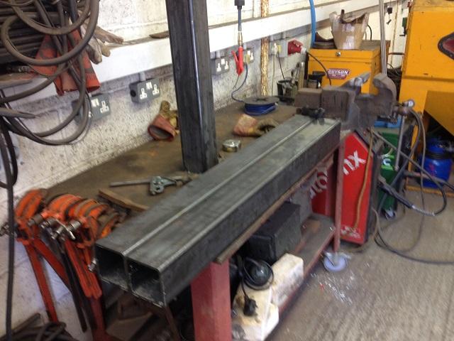

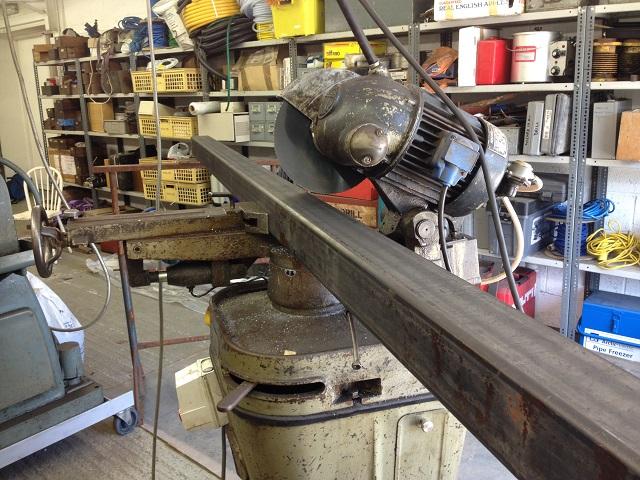

So take a 3 metre length of 100 x 100 x 6 mm box section and cut it to length. Shame the chop saw won't quite cut 100 mm so we had to do a quick rotation of the box half way !
