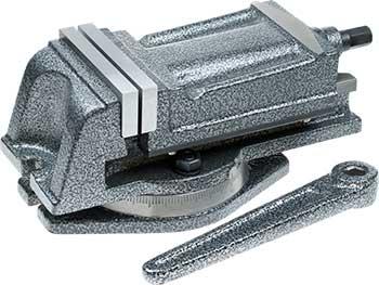

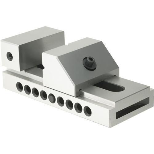

I am in the process of upgrading my SX2 milling machine to a SX3 milling machine, i need a new vice for the SX3 machine and am considering one of the screwless vices (See attached image). Does anyone here use one of these vices with their SX3 machine? If so, what size do you have 3" or 4"? Im not sure what size is best suited to the machine.

Hi, I have one like shown above, except mine has slots in the side for toe clamps to hold it down, I got it from ARC and its seems to be good quality for the money. I think mines is the 5" or 6" so cant say how it would be suited to your machine but I find it a pain in the backside to use at times due to the way the tightening mechanism works, so if I was to buy again Id got for a conventional type mill vice.

Thanks for your reply. After reading around the Internet I actually agree that it may be a mistake if I were to purchase one of these screwless vices. Many others have stated that they are awkward to tighten due to the mechanism and do not hold all that well. I think I will look around at standard milling vices. Probably 4" will be best suited to my machine.

I have two of these vices, I have found that they hold very well but that they need a small modification to make them easier to set up.
On the left, the original nut, on the right rectangular replacement.
The rectangular section stops the nut turning in the slot which means that it always engages properly. I find two 2" vices (2" width) very useful, allowing work to be held in between.  I do have another no name 4" inch vice, but I don't use it as much as the screw-less. two vices are a lot cheaper than a Kurt!!

ARC included one of these in the price when I got my SX3, along with a load of other useful goodies.
Gary
edit: It's 100mm jaw width and has done everything I've asked of it so far. If I was buying again I might consider the tilting version instead.

I have a 4" vice from Chronos which opens to 4". It is less than £100. See http://chronos.ltd.uk/acatalog/Engineering_Menu_TWV_Swivel_Milling_Vices_93.html (More details at: http://www.shobha-india.com/precision-machine-vises/precision-machine-vices-p3.html#1 )
I did a paying job for a company a few years ago and they bought me the vice in lieu of payment which suited both of us.
It's not as good as my 4" Abwood but is useful on the occasions when I need to hold a big lump of metal which is wider than 70mm. I do have a couple of 6" Abwoods but they are really too big for my mill (and too heavy for me). (If AdeV is reading this he still has to collect one!)
