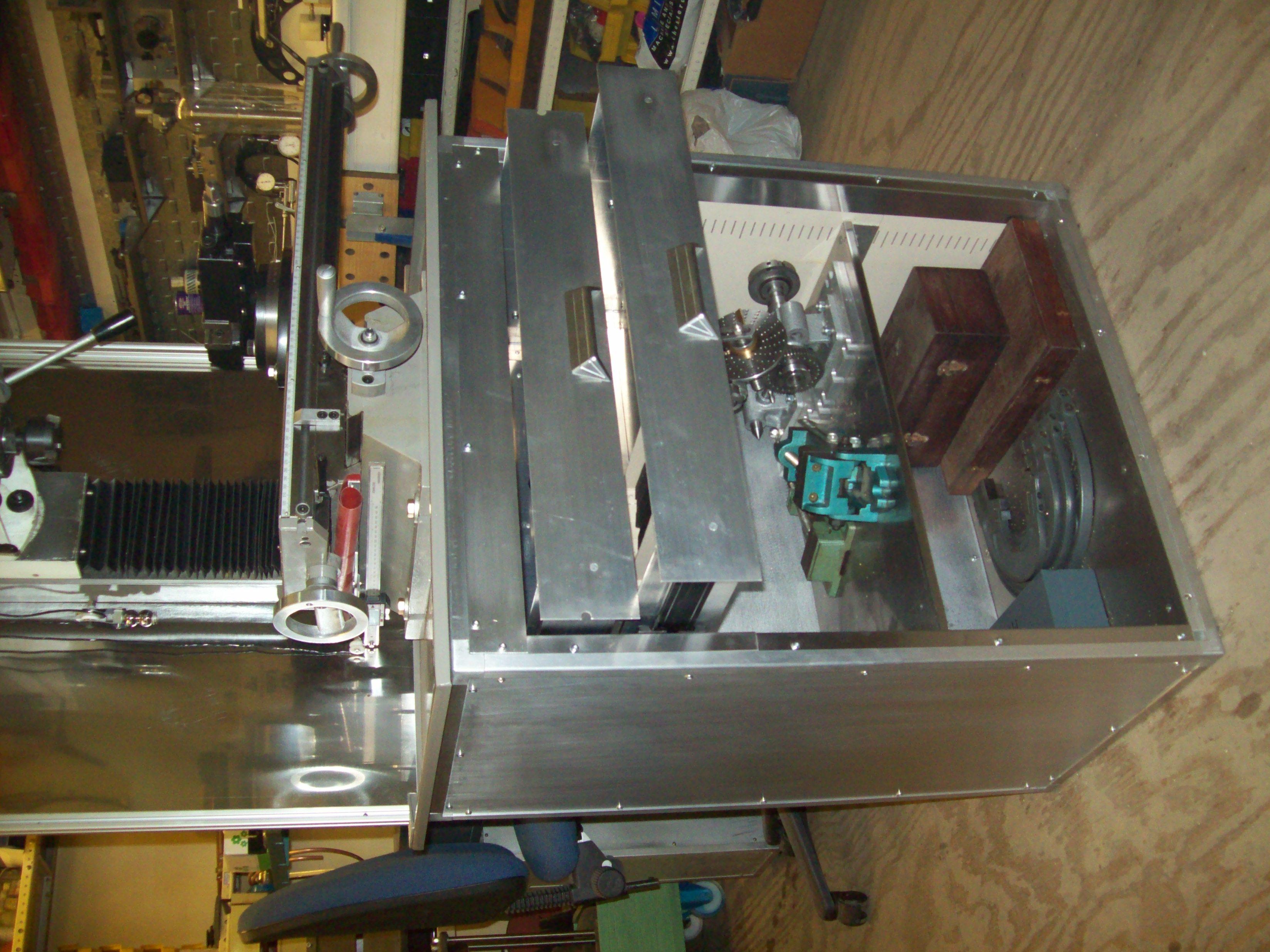

I am 6 feet tall and like to do some of my work while sitting on a stool. My milling table is 41 inches above the floor. At that height I can stand without bending and sit without reaching to high. I do have to stand to change the "Z" axis but only briefly. My mill is the same as yours except for the name. Mine is a Grizzly. It came with the stand that is optional with the Chester mill. I had to raise it 3 inches to get to the height I needed. Here is how I did it.
Joe
Re: Milling machine stand
« Reply #8 on: June 29, 2014, 11:48:57 PM »
Looks good I want to raise mine the same as what you have done.

I bought my mill and lathe at the same time and both came with a stand. The mill stand was a danger to life and limb, much too narrow to give ANY stability at all, so I made my own from scrap (as usual).
Height is 32" to the top of the stand, but like Joe it is a compromise as I also often sit down whilst milling
or turning.  The stand has two draws and a shelf under the draws. The photo only shows the top bit of the stand but I am sure you get the idea. :scratch:
Cheers Dek. :med:

P.P.s   Different Photo, this one shows the whole stand

Ooops !  Photo a bit on the big side. Should have resized first.  Calling moderators HELP!

Deko, that stand is a work of art and pretty much exactly what I'm aiming at.
At 32" it's around 4" shorter than I'm planning. Do you think that would be to high? (I'm 5'11" tall btw)

Hi BBB,   Same height as me, and if I were to just stand at the mill, rather than sitting down most of the time, I would have made mine the same height as you are intending.  Gravity has already robbed me of an inch over the last ten years (I was once 6ft) and I also have emphysema so I can't stand for very long. :(
