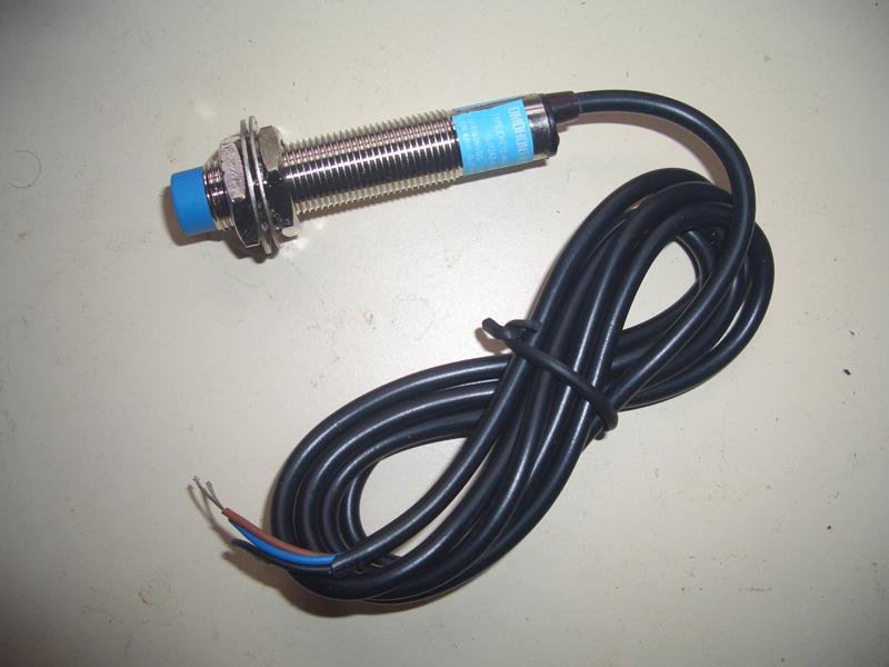

I wish to fit a tachometer to the milling machine that I am building, I have bought one but the sensor is too large to fit in the available space. I have almost no knowledge of electronics, could anyone suggest a smaller replacement for the sensor that I have, it measures 62mm long x 12mm dia. The diameter is not the problem, it is the length.
Here is the data from the sensor that I have.
Thanks, Norman

Hi John, thank you for your speedy reply.
This is the sensor that I have.
It is completely enclosed, and safe from debris. I was hoping that there might exist a similar product but in a smaller package.

Offline BaronJ
  • Posts: 244
  • Grumpy Old Git !
Re: Hall Effect Sensor
« Reply #5 on: June 25, 2014, 04:43:05 PM »
Hello Norman,
what you have there is an "Inductive Proximity Sensor".  You can get them as small as 6 mm diameter and 20 mm long.  As far as "Hall devices" are concerned RS Components will sell you one over the counter or by post.  They are not very expensive !  The last time I bought some they were much less than £1.00p.   Now if you want to play around and salvage some, any computer case cooling fan will have at least one and usually two in it.  An old floppy drive motor will have upto four in there.
You should also be aware that there are several types of hall devices.  Some are simple sensors that will give you a variable output that depends upon the magnetic field strength, others are switches that will give a digital output, positive or negative going depending upon how they are wired and the magnetic polarity.  Some of the switch ones require one magnetic pole to turn them on and the opposite pole to turn them off.
