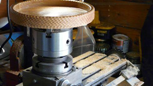

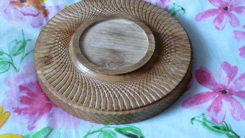

I watched a demo of ornamental turning at Sandown Park model engineering show last year , I liked the look of it but the lathes are out of my budget , had a go with a rotary table and some router cutters and a fly mill , this is a first attempt .

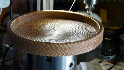

I guess this took a long time. Did you have to lift the cutter, index the rotary table, drop the cutter etc etc?
Another thing to try on my CNC I think.
Re: Ornamental Milling
« Reply #2 on: June 21, 2014, 03:14:17 PM »
Indexed every 5 degrees it's a mill drill set the depth and pull the handel gives me another 1.5 mm , the sides just used the y axsis and my DRO , the clearing up took longer than making the bowl the sawdust floated every where .

Jeff is that a router bit with a pilot that you used?
I was also wondering about burning since mill cranks move things slowly by comparison with a router in hand -- but quickly realized that a mill wouldn't run anywhere near the RPM of a router, so probably burning wouldn't be an issue?

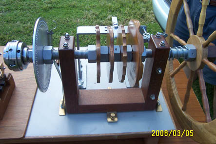

I spent a few years with the Ornamental Turners Group of Australia OTGA for short saw them at the Sydney Wood show in 2005 joined up 2 years latter. Totally enjoy it, have yet to build my Rose Engine not expensive to build at all. Similar to this.
Mind you I couldn't afford an OT lathe
http://www.ebay.com/sch/sis.html?_kw=Antique+Holtzapffel+Ornamental+Turning+Lathe+1860s
Love the cuts you have done I count 3 different types. ??
What was the wood?
« Reply #7 on: June 26, 2014, 03:16:35 AM »
The wood was an off cut from an Oak kitchen worktop , I have an idea for a Rose head for the mill on slides but it's just a sketch at the moment , I missed the bottom photo on the first post , definetly tacktile .

Old Biker Mark built this unit http://myweb.tiscali.co.uk/remark/pages/hobbies/ornamental/ornamental.html

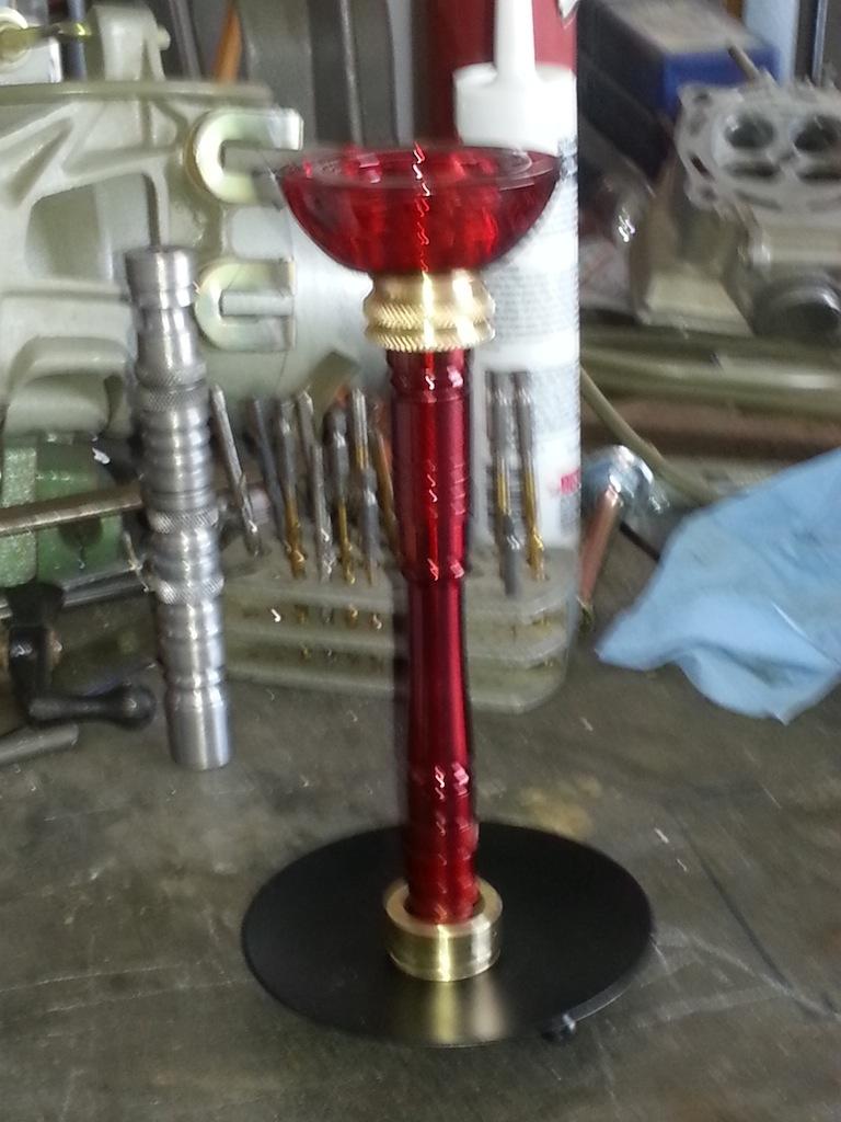

last Christmas My wife asked if I could come up with some sort of Candlestick for her women's club dinner  , the Dinner was on the 21st , she asked on the 19th  :doh: This is what I came up with , made from 1" hot roll stock , I spent a few hours on this with a few different tools and very little imagination . A constant reminder of the number of things one can find to do , in a pinch ...... :D

Almost looks like glass
