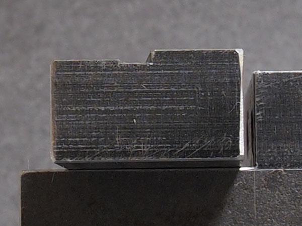

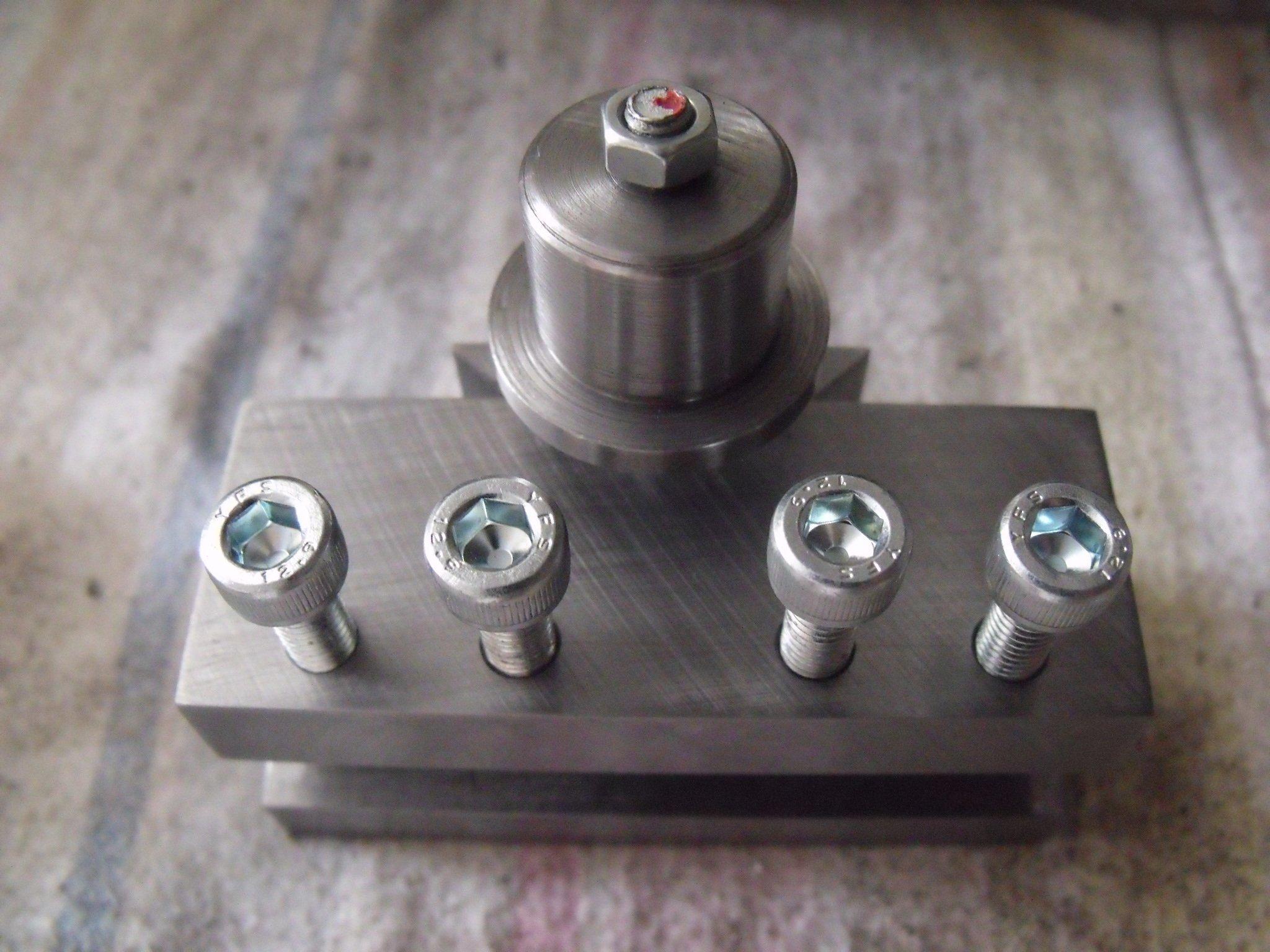

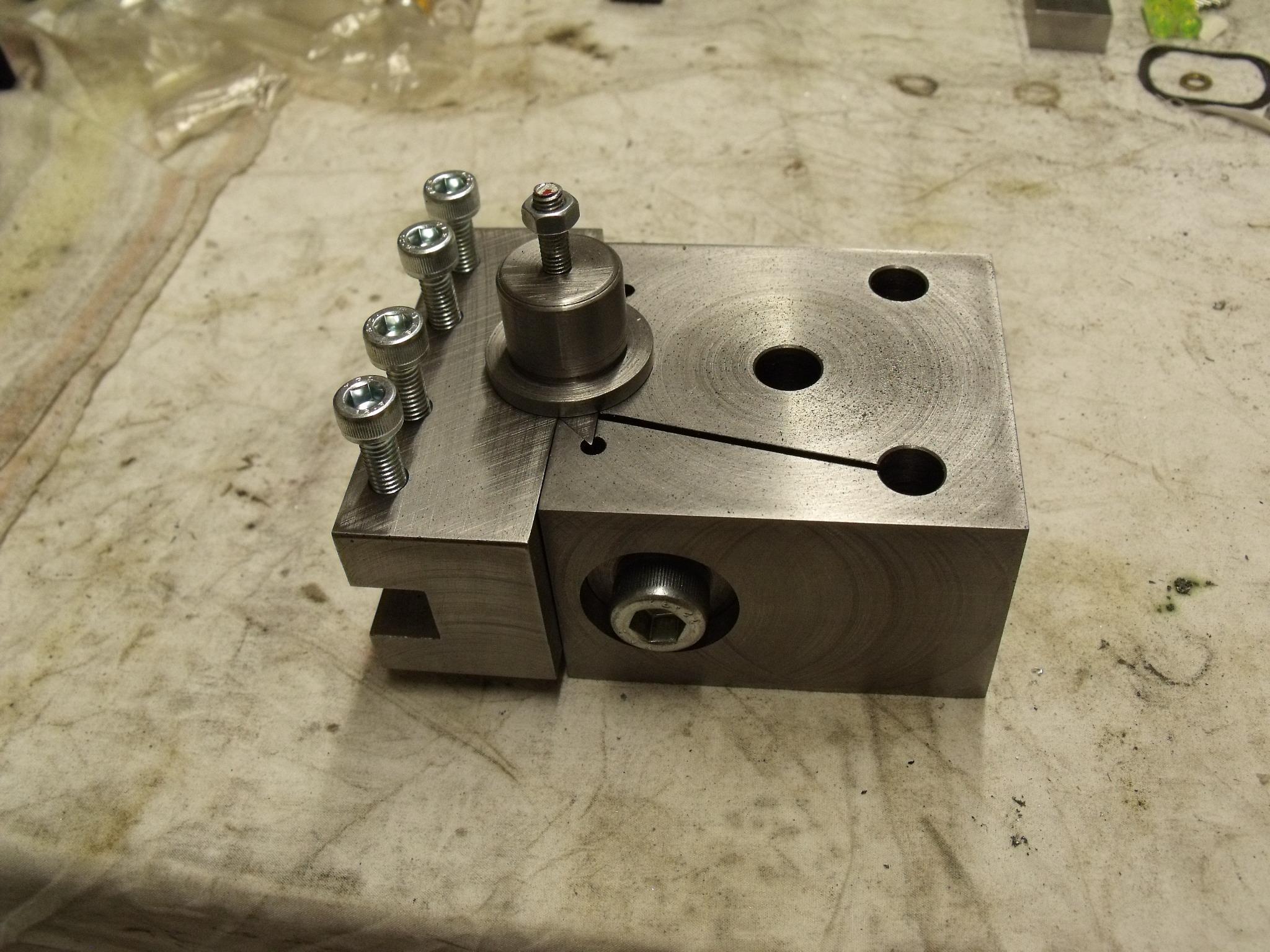

Hi there,
I've been through this  conundrum a couple of times.  Having had a good look at what was around, both commercial and home brew, I decided to go down the home brew path.  I have a Myford lathe so I needed something of a suitable size.  I was given a copy of the plans for this one, which is quite straight forward to make and if you wished you could modify the dovetail dimensions slightly to use commercial tool holders.
Modify the drawing to suit your lathe.
Best Regards:
                     Baron

Hi there,
Thanks for the info and pics Baron.  I may try to figure out a design for my specific lathe that will work better for me and see if ol Chuck in E TN is up to some milling, drilling and slicing :).

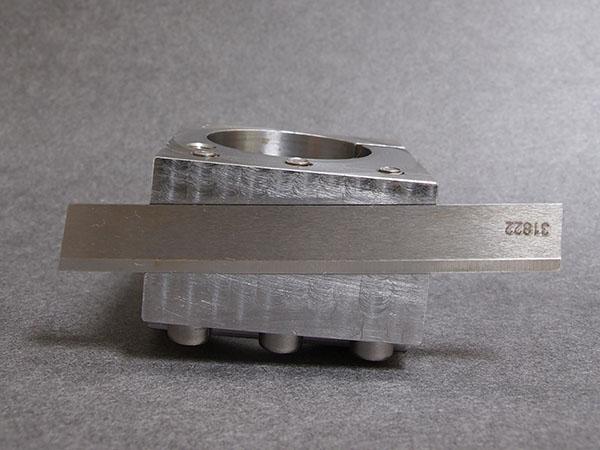

Here's how I made mine, they work with both my Craftsman 12" and my homemade Gingery lathe. You just need to have a post the same size that bolts to a lathe carriage. I'm even thinking of making a post for the milling machine -- since I recently turned and faced a homemade flycutter to make it true with the R8 spindle on that machine.
http://madmodder.net/index.php/topic,8415.0.html

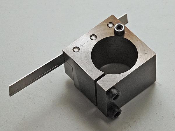

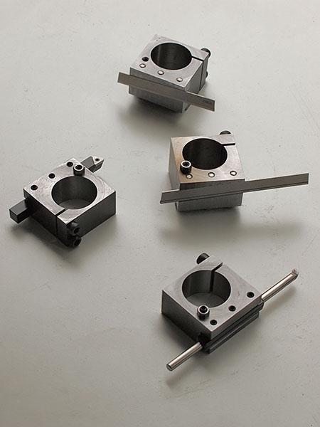

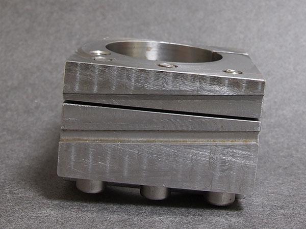

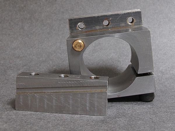

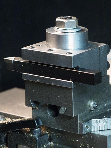

I'm with vtsteam.  I have a Sieg C3, like your 7 x 10, only 7 x 13ish.  I used a 35mm diameter post, to keep things as stiff as possible, bought the 50mm x 50mm free machining bar as 25 mm slices off the square bar.  Then spent a fair bit of time making all the toolholders, I'm now up to about 20.
The 35mm bore in each toolholder was done carefully to minimise the amount of deflection when clamping, this increases the area in contact between the post and toolholder.  Which in turn makes the whole set up stiffer.  Two clamping screws were used to make sure, on reflection they could probably have used only one.
The main aim of all this was to reduce chatter and make parting off easier.  Chatter has certainly been reduced considerably, and parting off is now a piece of cake.  This morning I was parting off 20mm diameter cast iron at 200rpm, al. alloy is regularly parted off at up to 700rpm depending on diameter.  The big advantage of a 7 x ?? machine is that paring off can be done with the spindle running backwards, with the p/o tool upside down.

Hey that two piece parting tool holder is neat!!  :clap:

Not the traditional industrial design, but the parting off blade comes as close the center of tool post as possible. Very good.
Here is pretty standard case, you can see parting off tool hanging outside of cross slide:
http://www.mini-lathe.com/Mini_lathe/Reviews/a2z_qctp/pt03.jpg
You wonder why he rather uses band saw?
I have seen sometimes parting off blade on offset mount:
http://littlemachineshop.com/Products/Images/480/480.1701.jpg
Which is hung on standard QC tool holder.
Which is mounted on top slide, that is allready very close to leftmost part of the cross slide....therefore bit too much overhang and a lot of speculation why paring off is so much easier on centrally mounted rear tool holder - which ever way.
