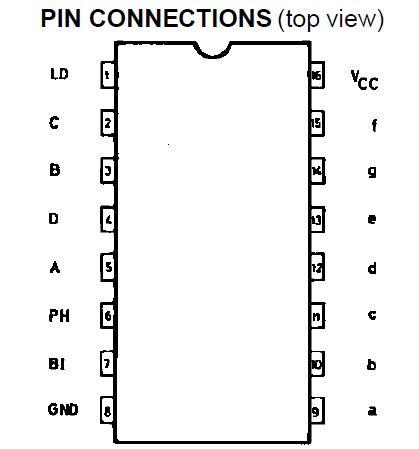

You only need 4 pins for the cathodes with a 74HCF4543 chip ..  :thumbup:
Dave BC
Ermmm how so?
Whether CA or CC, will still need 11 pins.....( I only had 3 digits..... :doh:)
Don't interrupt your lunch explaining to me...... :lol:

OK. 4 Data Bit pins then .... A,B,C,D ...
Depending on the LD pin polarity, it drives either CA or CC LED displays.
Pinout [ hopefully ] att.

Ahh I see what you mean, takes a 4 bit code in and drives the segs...
I was thinking of the Maxim offering that does something similar..

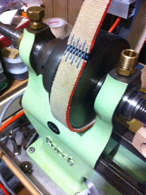

Emma...I got my tach in yesterday that I ordered Friday from ebay and I put my magnet (actually 4 6mm x 3mm neodymium magnets behind the chuck plate on my spindle and made a bracket for the sensor and mounted it to the back of the lathe.  The tach itself I glued 3 of the magnets to the bottom and there is a nice bevel on the too of my headstock that it fits perfectly on.  I may end up moving it to the other end of the spindle if the magnets collect shavings since they are near the cutting area and open (and very strong lol ).  I will post some pictures in a little while.

« Reply #19 on: June 10, 2014, 08:37:15 PM »
Awesome! This is what I want to fit it to. Still debating..
