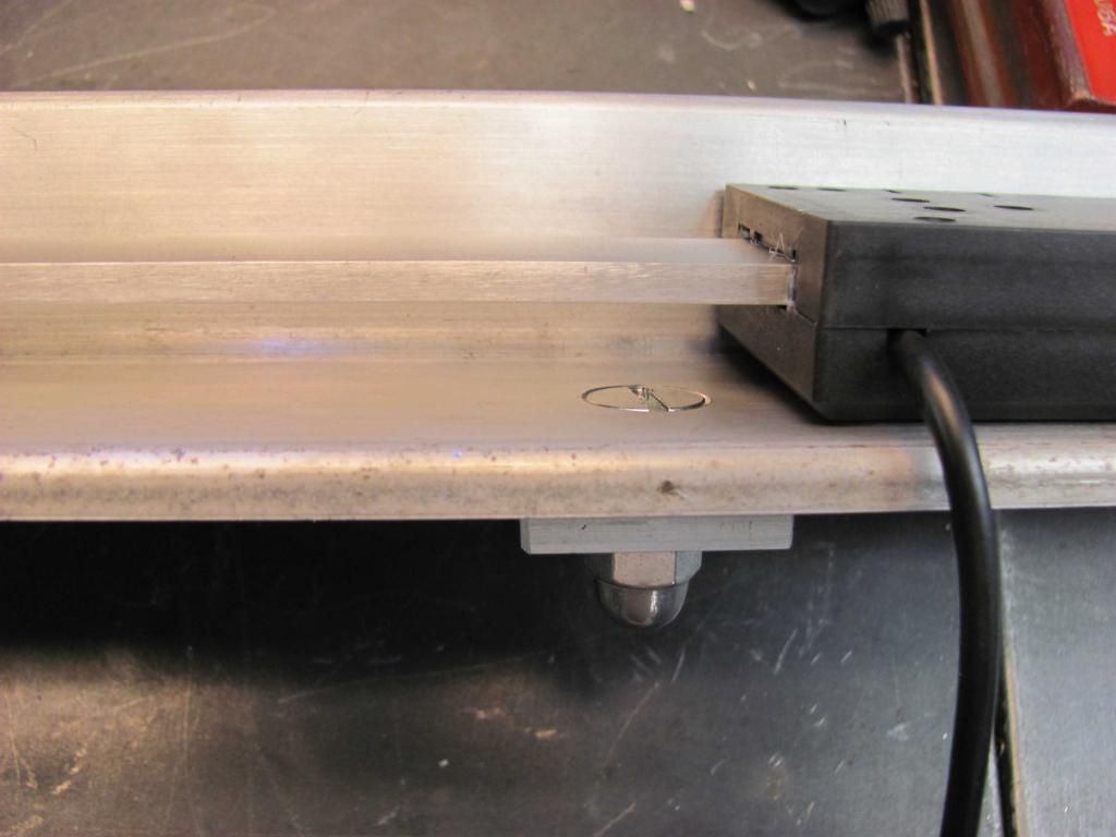

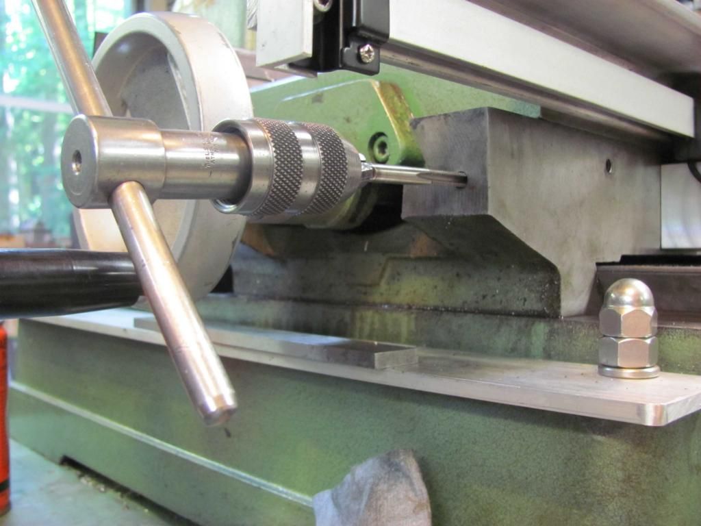

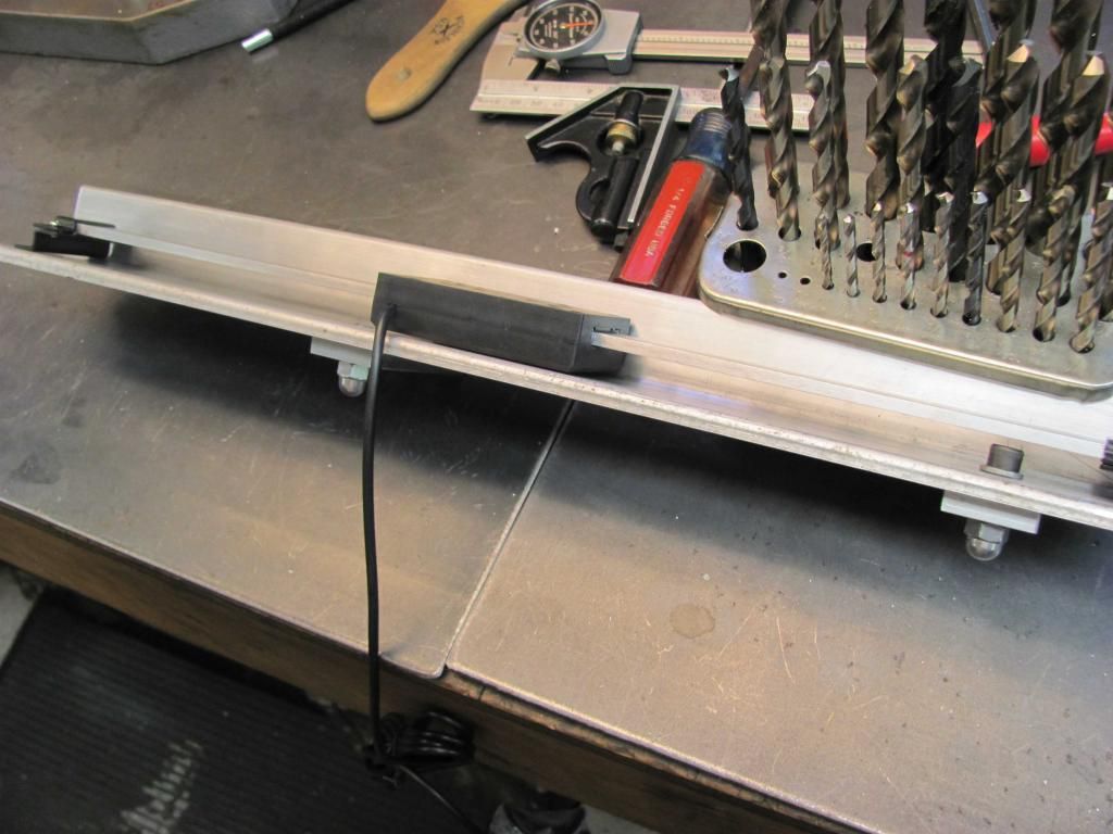

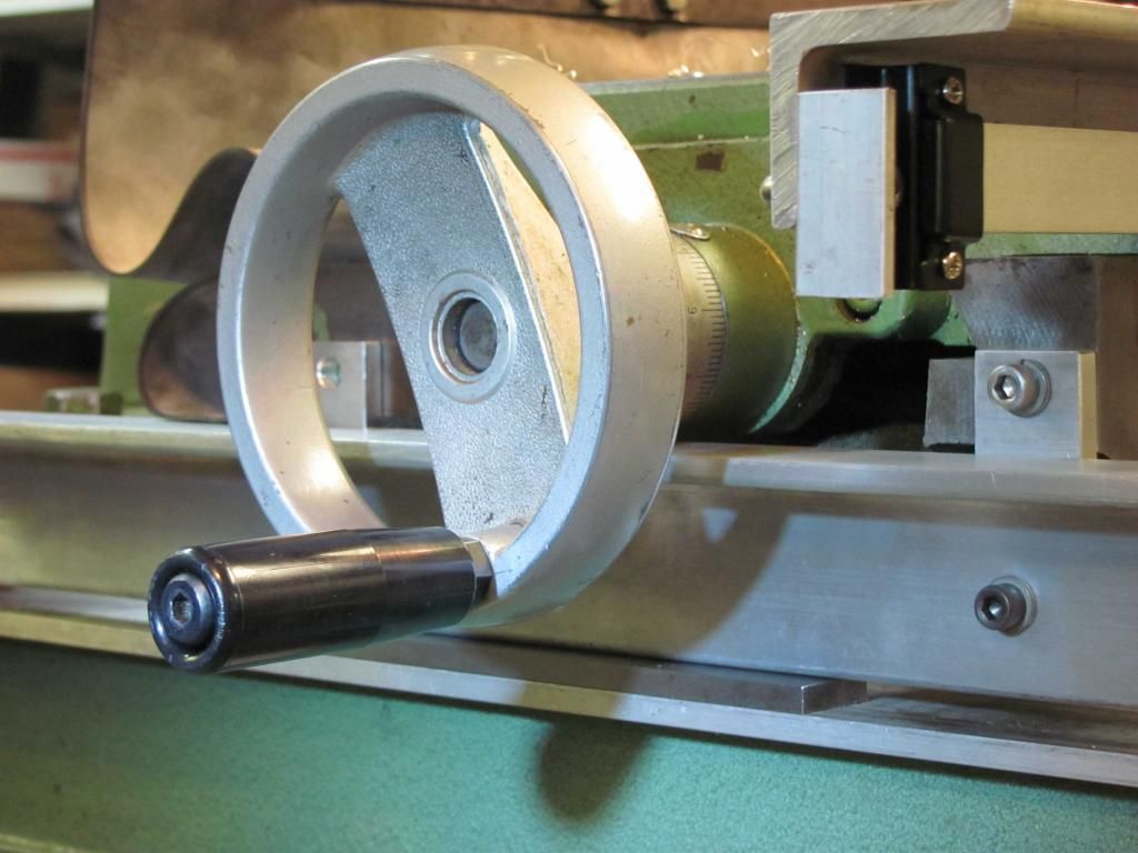

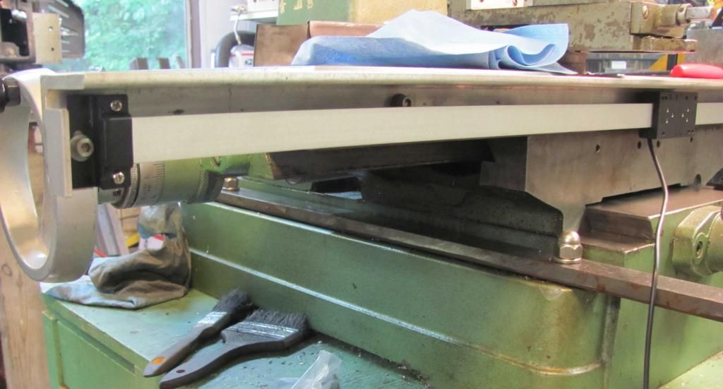

  I had some aluminum angle handy and decided to hang it on the side rail slot, this takes away the function of using the slide table stops but the benefit of using this real-estate outweighs that function
A top shot to give you a general view from a working perspective.
All I did was drill two holes in the angle and affix it by the taper nuts into the slot on the side of the table, then with the hardware supplied I drilled the holes for that, if you notice the top of the angle is not quite flush with the surface plane of the table, that because I used thin parallels to set down the angle elevation but still have it level with it, plus I did not want any work pieces touching that angle surface in case it moved it which might affect the reading of it. The slide elevation was made by inserting a parallel on top of the beam and touching the underneath of the angle at both ends to make it level with the table, all the hardware and holes drilled into the angle were oversized because I wanted this movement for alignment. Now the reader will be static and the slide will travel, no wire movement or bunching, an added bonus of this idea is it will naturally protect the beam and reader from dirt and oil.

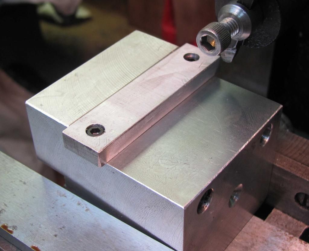

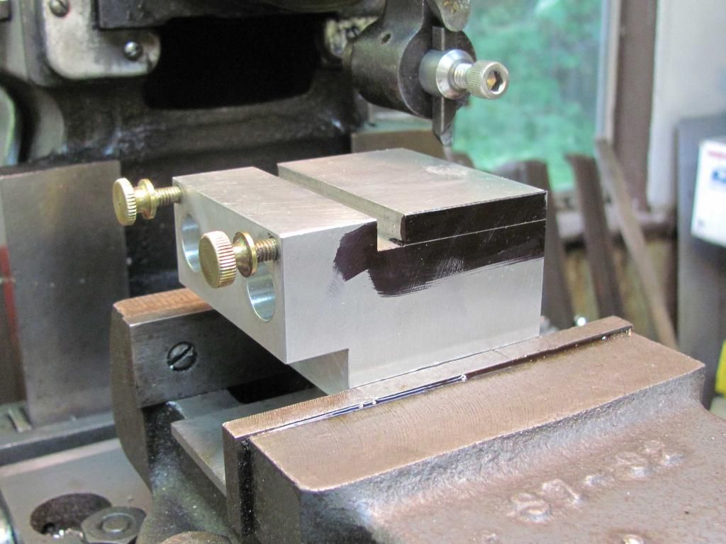

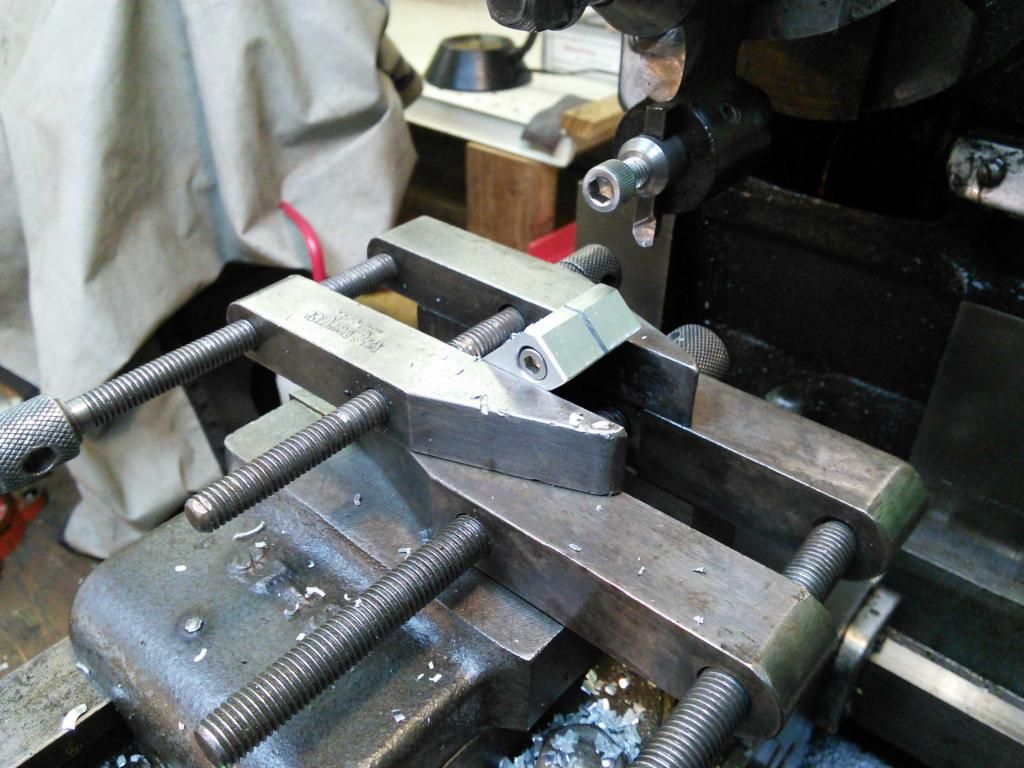

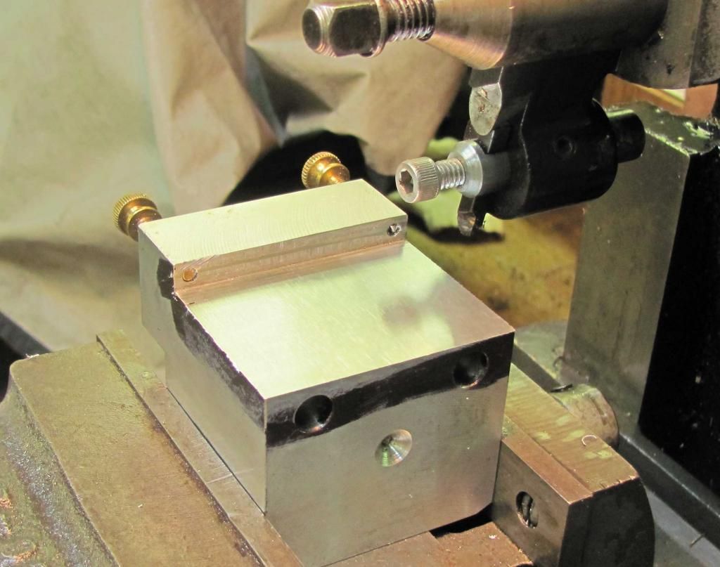

This aluminum block was made to be affixed to the table base and was a mount for indicators and such but now i can use it for the Head reader mount with a little tweaking i can make it work for this job
Ready for a little scraping from the shaper to remove some material to lower the elevation so it sits just underneath the Reader Head, There is a slot in it already and i need that to be raised up so i am taking off material and adding later, the pictures will tell the story.
All done and here is the finish.
Here is the piece with the added block installed and will be machined to to blend in all contours.

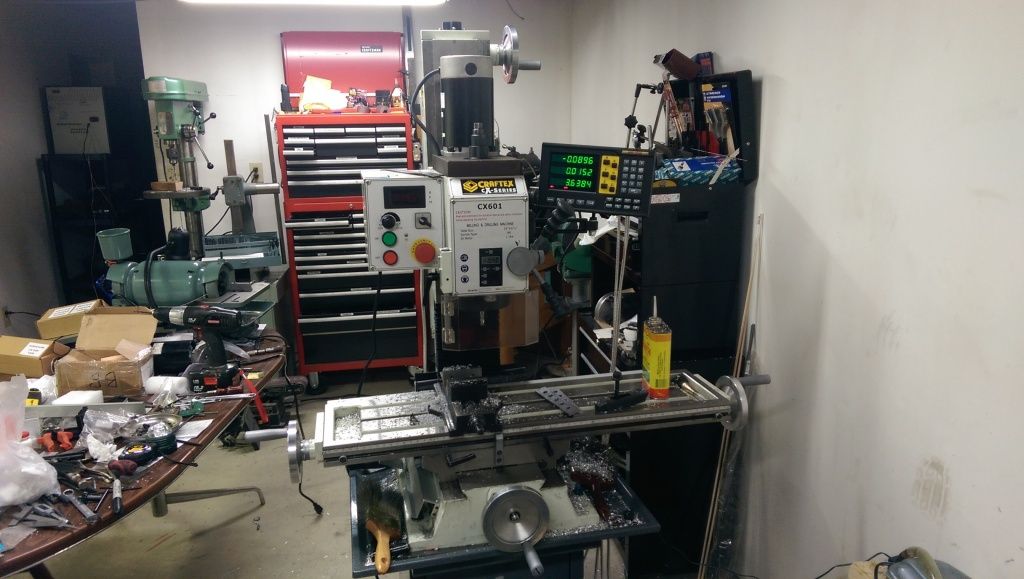

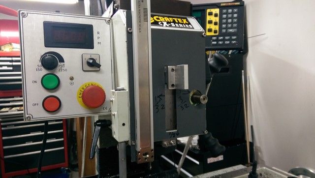

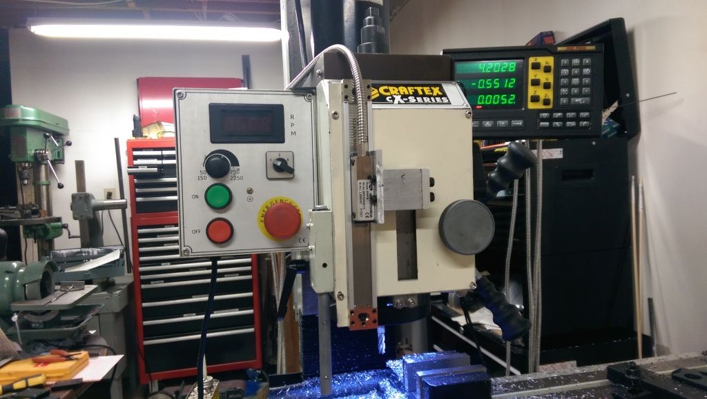

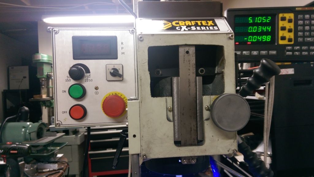

I have just put a dro on my craftex 601.  I went with the DroPro's 4 axis the x and z went fine but I had to reengineer the quill and y and like you had to make another faceplate for the front. I had enough room to use the existing hole from the sliding scale it came with originally using the same arm that moves with the quill. I have to go to a bbq this afternoon but I will put up some pics tonight.

Done similar with overhanging angle on last mill except it was mounted outboard for access to T slots and needed stops.
Coolant and debris will find its way in rest assured. Probably get away with it once but second time scales scrap, had two of mine pack up  when they were dear over 14 years ago.
The dodgy spindle one mounted off a cylindrical collar round quill replacing the original with coolant tap inbuilt. Reader part screwed from rear to an angle and fixed at front right hand side. You will have to make a decent good fitting screw to go in slot in the quill to take up the rotational play.
Are you going to cut the X axis angle and scale down.
Plan that cabling, its flimsy and prone to breaking along with distorting the contacts. Main prob I had was the Warco 3 axis readout draining the SR44 batteries between 3 to 6 days.
Reader brackets that come with these scales are near on usless having compared to dear magnetic, glass and the cheapies all in situ on same axis. Make your own as angle mentioned above and they will be accurate. There can be as much as 0.145mm flex in one direction before the scales starts moving.

Jonny… got ya on the reverse of the angle, I thought about it but went the way I did, I just thought it would be just as easy to make a stop from the horizontal top in the future than to worry about engineering the bracket the other way. I have a feeling the slide or scale will be damaged by dirt and oil but I will remedy this as best I can only time will tell.
I am not going to cut the X axis down I will live with it the way it is. Your right the cabling is flimsy and I am going to protect it with that flexi-shell stuff you can buy at an auto store, the one with a split in it, I realized by doing this the wires need to be protected as best as possible.
The bracket hardware is trash, the holes don’t really meet up and are not sufficient for the job, I am using them just to get going as I can spend time in the future making sturdier brackets, I have found through this install that alignment is key, whoever wants to do this work will need to pay attention to alignment, when the slide and reader move it needs to be  in a straight line and no bowing allowed,  by making my brackets I  allowed movement in the holes so you can position the unit so to limit the distortion while the reader is sliding down the slide rail. The 0.14 thou has been noted, thanks.

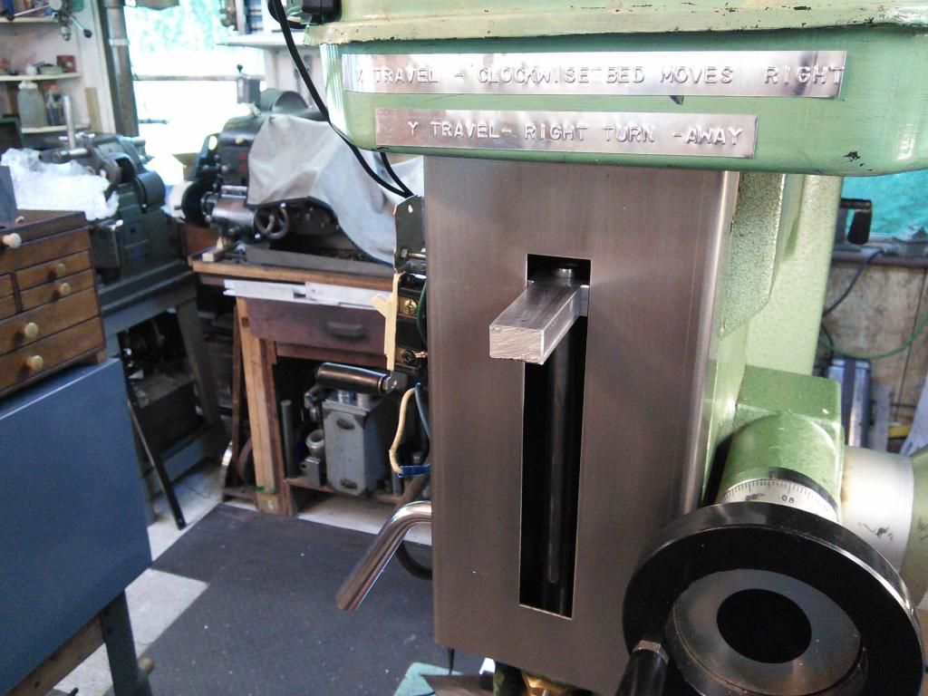

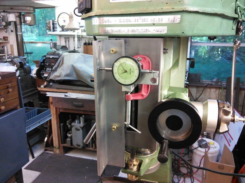

Well this is the original face and the slide it came with
As you can see there is lots of room under the cover I milled a slot for the sliding bar that fit in the existing hole for the previous scale keeping it as long as possible to make sure there was enough in the down position.
I fitted a plate using the existing holes and cut out the center portion leaving maybe 1/8 inch overhang for support although it doesn't touch, the screws are counterbored so the new faceplate will lay flat.
This shows the riser from the slide and the new faceplate as you can see there is no screws holding the scale I can thank " DroPro's " for that, when fitting everything together use 3m outdoor doublesided tape it works great and saves a lot of time 1" on each end holds great.
And a shot put together there was only one problem here, when I put the crossbar in place it sloped inward, I never thought to check the slide bar to see if it was parallel with the faceplate so the riser was removed and was ground to fit with my new grinder  :D all that remains to do now is paint and mount the scale.
I got this a couple months ago thinking mill bit sharpening
 All in all it wasn't that bad a build.

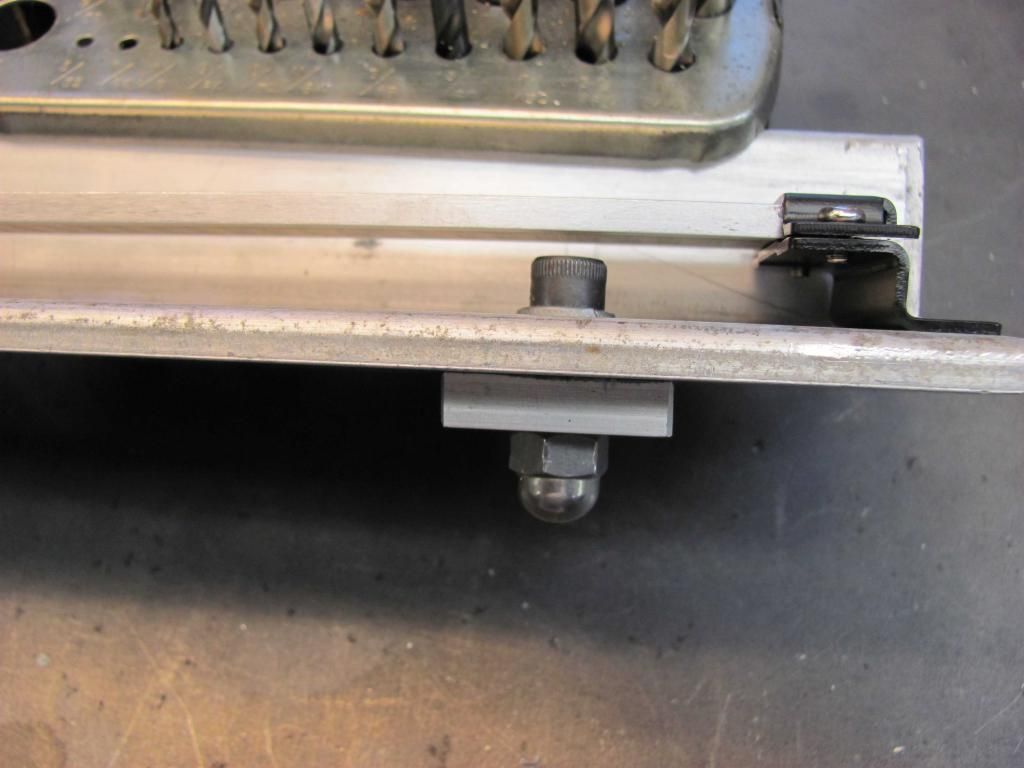

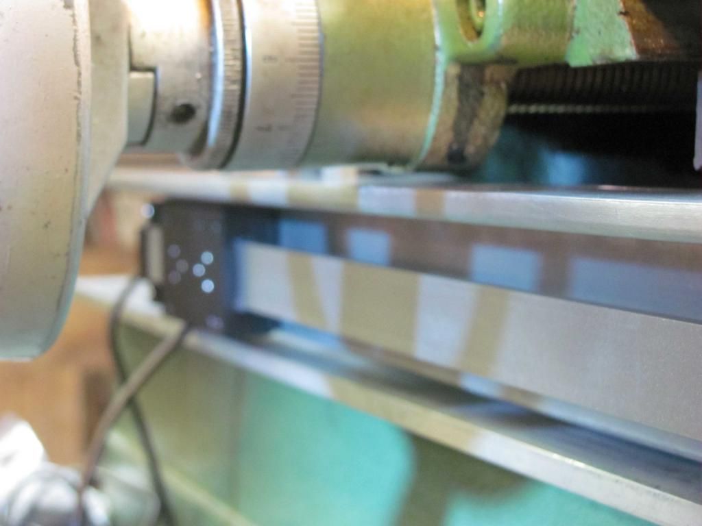

Here are some pics on where I am with this install.

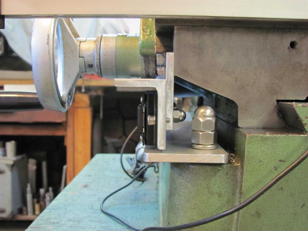

the space i desired between the rail and the reader.
this is the close tolerance i have applied to keep it compact.

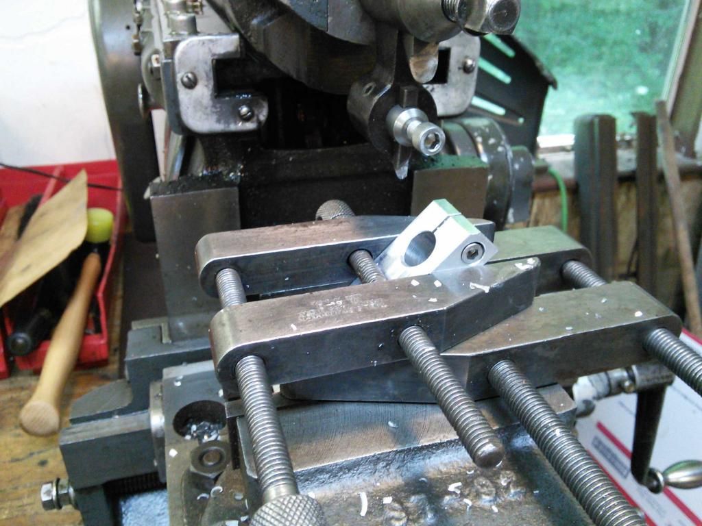

how i made the back bracket..
and this tool is worth its weight in gold......if you dont have one get one. a tapping stand...

Here we are so far.
I have noticed some slight bowing to the rails and i am wondering if this will turn out to be an issue only time is going to tell and i figure when i start to use this for the first time i will pay close attention to my measurements I will be getting, i may just apply an indicator and have some reference to what happens.
dust and dirt have been playing on my mind and through reading other peoples posts and builds i am going take advice and will cover all the rails with a stainless shields which will have end caps on.

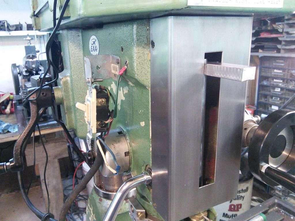

my quill face plate has been made and i will be installing that this week end, its elaborate and fancy but should do the job, i have modified my quill too, i have yet to see another approach on this machine like on how i will be doing it piccies will come for sure.
alright then my progress so far....
i have kept the tolerances tight.
side shot...
My spacer to keep the rail parallel, the flat bar is very close with being parallel with the table so i am using this as a datum point.... we shall see
making sure there is no interference....
Be back later..

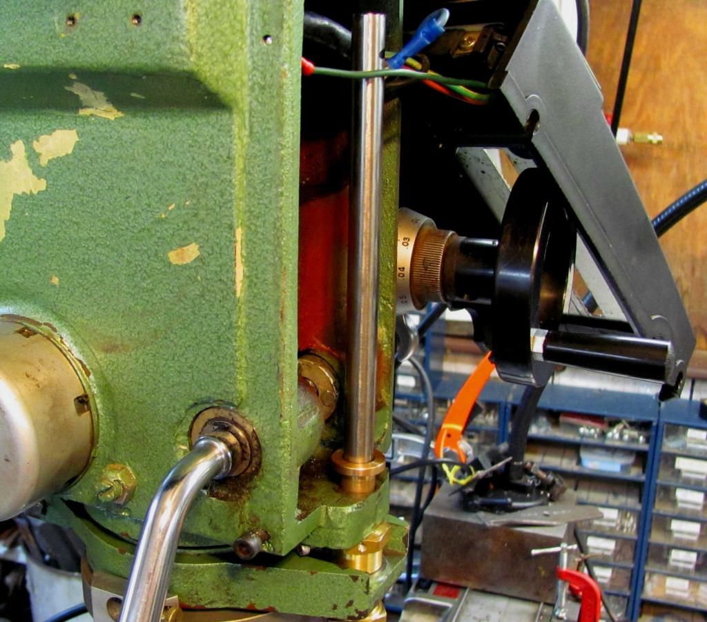

The quill needs looking at. on this machine it has a slight twist or rotation because of slack in the headstock, it annoying to say the least but the Chinese in there wisdom made it the way kay=sera. I eliminated as it much as i could by using the existing depth gage rod hole and slipping in a brass bushing with a nice bearing bushing to suck up the slack, the rail i used it a length of 1/2'' stainless instrument tubing which is dead on size OD so tolerances can be held.
even though i just started to do this build i installed the quill rail two months before, its starting to get oil dry marks on it which tells me its still out, very hard problem to over come!!!...
the bearing fix in the heastock..
close up of the headstock bushing design..

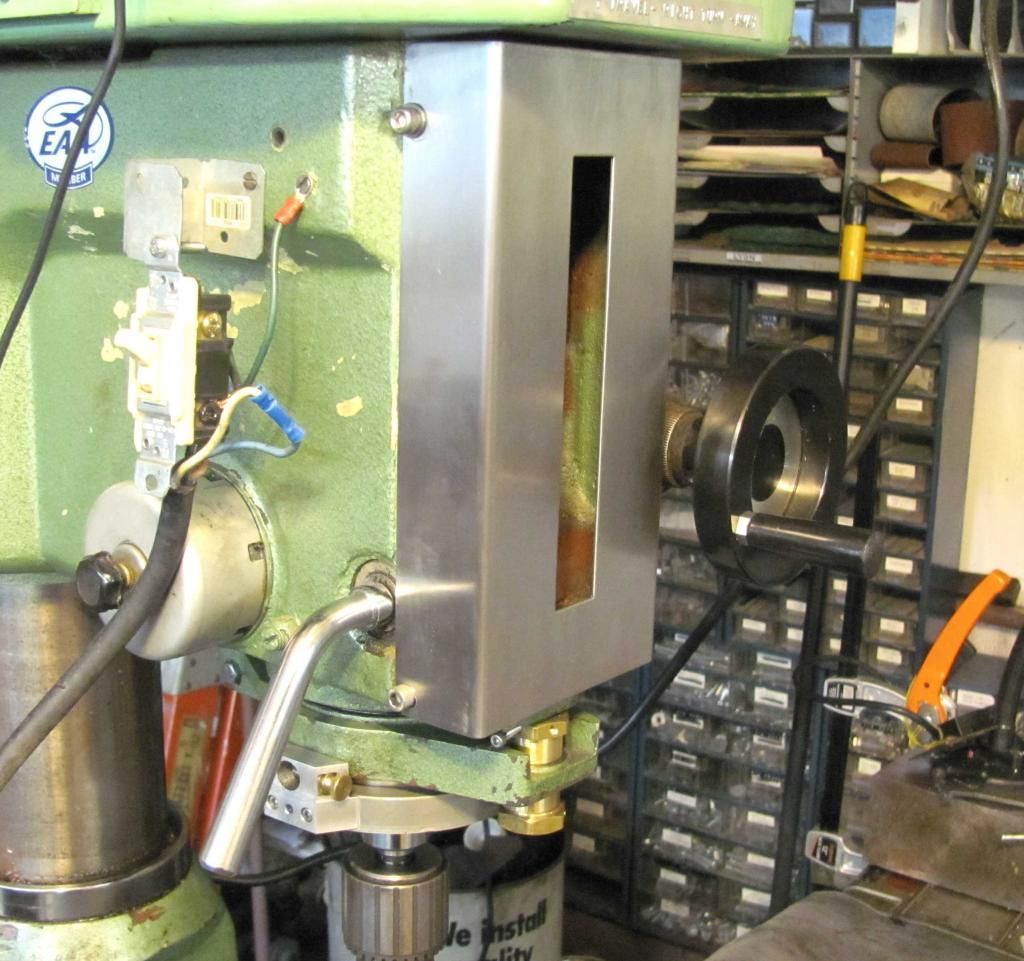

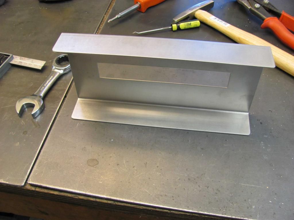

here is the plate i have made to cover the quill headstock that will allow me to have a bracket directly mounted to the rail to aid the z axis ..
thanks for looking..  anthony

well... i only got a little done this weekend, i concentrated on the quill face plate. I made it out of 16 gage stainless which is balls hard to drill trough, im stupid really i always revert to stainless because i like the look and feel but curse every time i have to machine it.
this is going to end up as a bracket support for the rail on the quill, all brackets will be made to make sure all is in line with the rail.
here is the view..
front view where the brackets will be installed.
Not far away now from having a dro system on the mill, im very much looking forward to it..
All the best..
Anthony.

That cover was nicely made! Clean sheet metal work -- dresses up the mill, in my opinion,  :thumbup:
They all do and what I said earlier with the grub screw riding in the slot.
Is the brass a new depth stop or mounting for scale, if so you always have movement. Far better off the bottom aluminium quill plate.

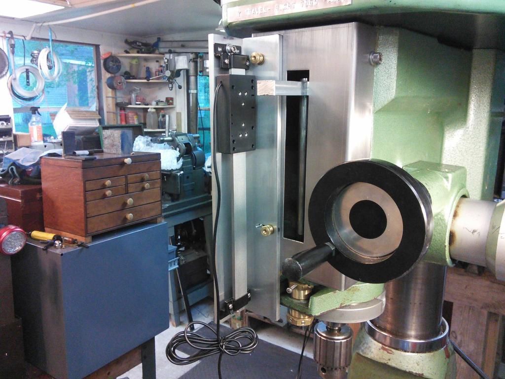

« Reply #18 on: June 17, 2014, 07:46:21 PM »
Well....
I got started on the Quill install, my attachment that's sitting on the stainless rod, when it gets to the bottom it interferes with the head casting so i had to mill off the corners for it to seat right, could have filed it but decided to get the shaper into action.
After i milled the edges down here it is protruding through the face plate, its all free from touching the face plate and the internal casting.
next was to install the fixing hardware for the bracket that holds the scale, i could have welded nuts through on the back but i took a chance on tapping the 16 gage stainless 8-32 and installing a thumb screw with lock washer and washer from the back for the thread to accept an knurled head nut to lock it down from the front. It worked.
Next was to install what i have, this done i drilled and slotted the aluminium angle with the positioning of the scale to be flexible,  i tight drilled the top screw and the lower milled a slot so i could swing the bracket over to align it parallel to the quill moving up and down,
this all done i stuck an indicator to check for parallel. Results were .002 over 6'' distance.
All well that ends well.

This thread shows the encoder side of the scales.  http://madmodder.net/index.php/topic,6512.msg69127.html#msg69127

The mill looks identical to my Warco Major so it gives me a good idea how to fit a DRO to mine.
Thanks,

well.... i have completed the install. the z axis was by far the most complicated. The slide bar i installed worked, its runout is about .005 overall length both ways, the bushing i put into the quill plate holds the tolerance for what this set up can handle, granted i have not used it allot yet, but i have run it up and down at least 40 times, also milled a slot to depth and it showed dead on, saying that it may gradually loose tolerance.
Here is the bracket from the slide rod.
Here it is installed.
All i have to do now is make a cover plate for it.
It from the picture dont look square but it is.
If anyone is going to do this install make sure all your fixture holes can be tweaked, slots and wide hole clearance are a must, all fasteners can have washers which will take up the width. My Bushing arrangement worked, the key was the straight piece of instrumentation tubing i used, a straight piece of drill rod will do the same, there is slight play but the closer it gets to the bushing it closes in. My tolerances on the rod are less than .005 on both directions.
I will use this set up for a while and report what  find, all in all i am happy with it.
