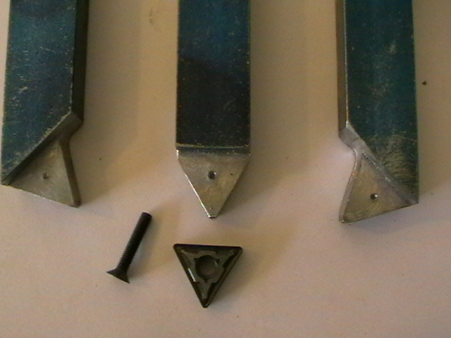

Up until recently I have been using ordinary tool steel and grinding various tips as required for the jobs to be done on my lathe.
I decided to step it up a notch and go carbide. Shopping around I soon found out that the tips and tool holders are rather pricey.
A bit of surfing cyber space uncovered this: http://bedair.org/Carbide/tool.html
My thanks to Steve Bedair whom I have never met or spoken to for the idea.
So I decided to have a go at making my own set of tool holders.
Machine:
A 3in1 of Chinese origin with a decent collet holder, chuck and some end mills, 4 and 14mm.
A 120mm rotary table.
Materials:
A scrap length of 16mm square bar, ordinary mild steel I think, milled down to 12 x 16mm in order to fit into my toolpost.
A few M3 countersunk machine screws.
The all important carbide tips, this type can be rotated and flipped over a total of 6 times each so should see me through to retirement before they are completely worn out!
The process was documented with photos, sorry, some were taken at night and are a little dark.
Here goes.

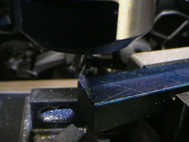

After milling the 16mm stock down to 12mm, blue and trace out the carbide tip.

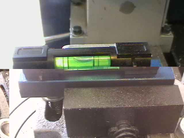

I carefully leveled the work piece (I know the bubble is not centered, but it corresponds to the level of the bed!) Note to self: I must level my bench some time  :offtopic:

« Reply #3 on: April 01, 2009, 07:20:03 AM »
The fun part!
Mill, rotate mill some more.
These were taken at night so apologies for the picture quality.

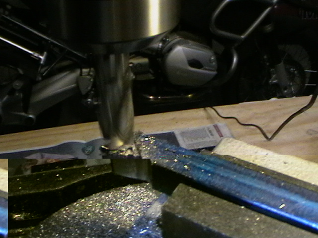

« Reply #4 on: April 01, 2009, 07:24:17 AM »
Another one.

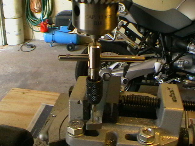

Tap to M3
I used the drill chuck with a center in it to keep that little tap straight.

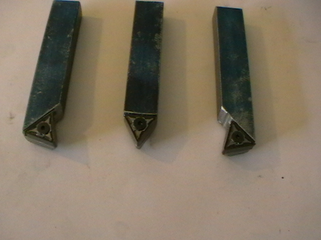

« Reply #7 on: April 01, 2009, 07:33:13 AM »
Result!
Just a note: When I tried the tool, I found that there was not enough relief angle on the carbide tip when offered up to the job. The M3 screw was slackened off and a .4mm shim made out of old crate strapping inserted, giving just the right relief.
A little cleaning up with a file and the end result is a sturdy set of tool holders.
Over all, a very satisfying exercise!  :thumbup:

« Reply #10 on: April 01, 2009, 10:03:58 AM »
Nice Mogas.
Another option would be to grind the clearence angle on the side of the carbide tool with a green wheel or diamond wheel. You'll then only have 3 useful position to use instead of 6. It'll will also eliminate the use of a shim.
