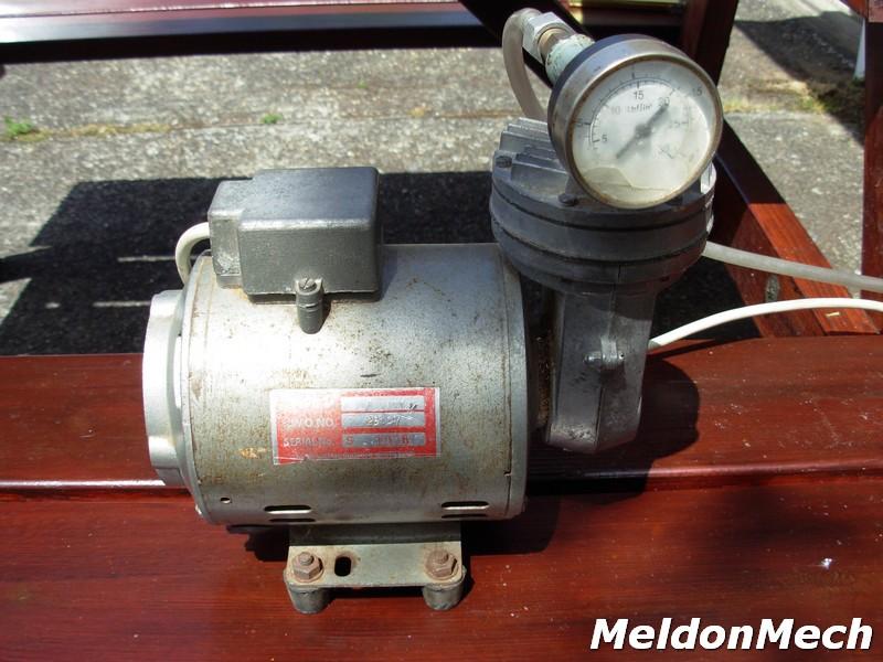

Hi Guys

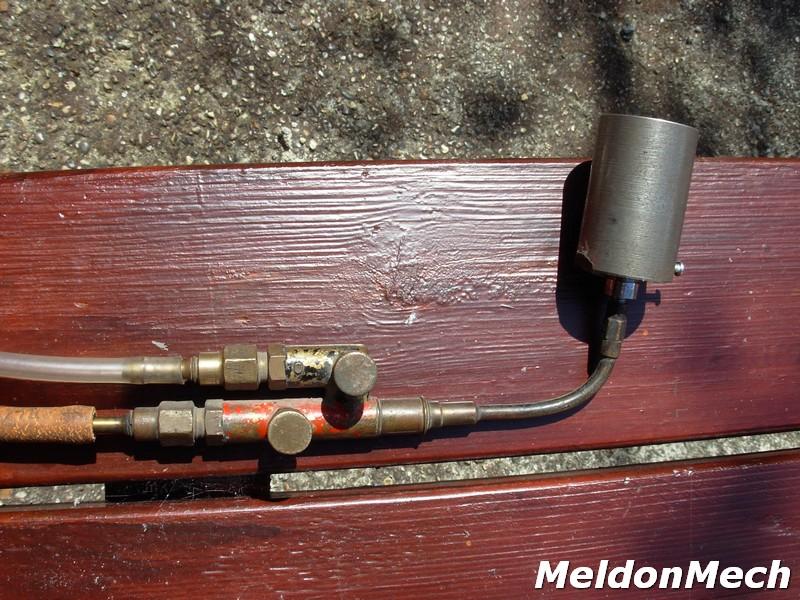

               I was impressed with Ironman's propane burner, back in his October post. I decided that this burner was something I must have. I had aquired a small compressor a couple of years ago and never really used it. Rated at 2bar it would probably been capable of running a small engine.
Re: Compressed Air/ Propane Burner
« Reply #1 on: May 23, 2014, 09:11:45 AM »
I next needed an old oxy/acetylene torch to modify, and had to wait some time before  one became available on ebay at the right price, not wanting to spend too much on some thing experimental.

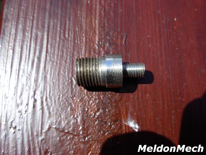

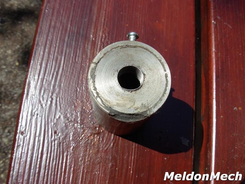

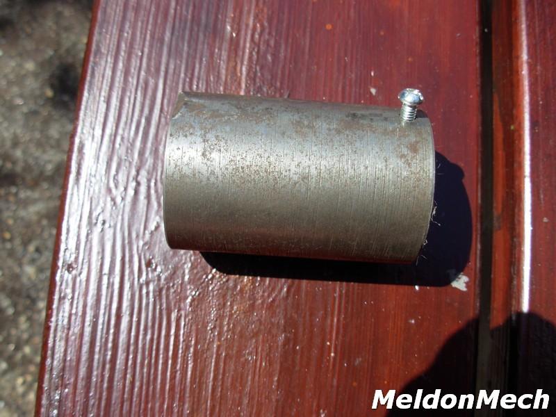

I started to look for some tubing and managed to find some 35mm diameter.  A small billet was then turned to fit in the back, this was threaded 1/2 inch BSF.

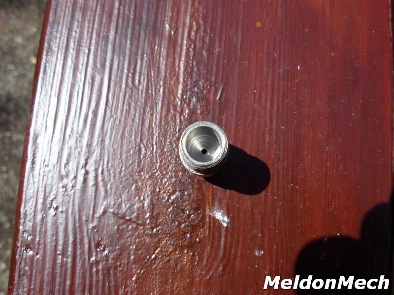

A nozzle was made to screw into the torch 1/4 inch BSF, and  1/2inch BSF into the flame tube. A 1.5 mm hole was drilled for the jet.

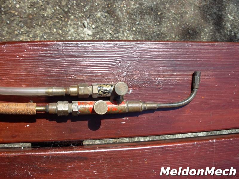

The torch was then assembled

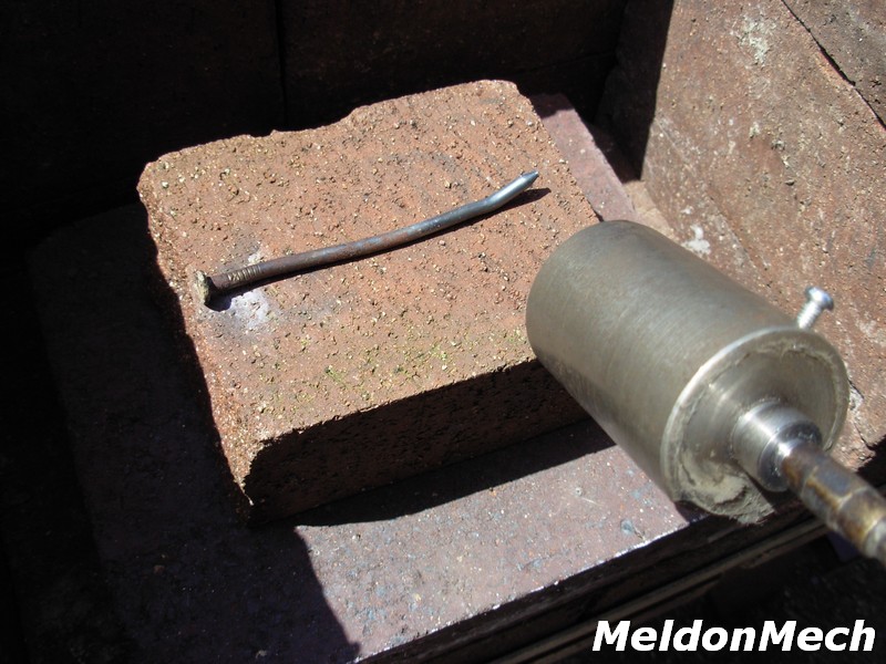

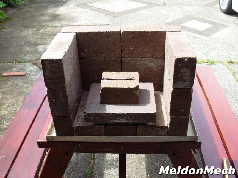

A temporary hearth was assembled on my picnic table to enable the experiments to proceed.  A 4inch nail was to be heated up. I connected the propane and set it at 0.7bar, and the air at 2bar. I switched on the gas, and started the compressor, lit the gas and turned to full, turned the air on very slowly, and was amazed and surprised at the power of the jet. The nail heated up to bright red in a matter of seconds. What a difference that compressed air makes. As to the jet size, diameter of flame tube and gas and air pressure settings they were perfect. I really cannot believe what I achieved it has given me a real boost.

Hi Guys
                I have now included a pic, of the firebrick hearth I temporarily built on my picnic table. Can anyone suggest any improvements?
                                                           Cheers  David
« Reply #13 on: May 24, 2014, 03:23:28 AM »
Weld up an angle iron framework that the fire bricks sit in snugly to hold everything safely together. I did a similar thing many years ago and it evolved into a blacksmiths hearth on 'supermarket trolley' casters with a blower mounted underneith. It's also been known to double up as a barbecue on several occasions  :ddb:

Your hearth looks ok David but you can get a lot more heat if you use insulating or refractive fire bricks.
http://kilnlinings.co.uk/insulation-bricks?zenid=60ca29a57806cde5fdf9065cc18d2cde
You can sit a hard fire brick in the bottom to work on.
