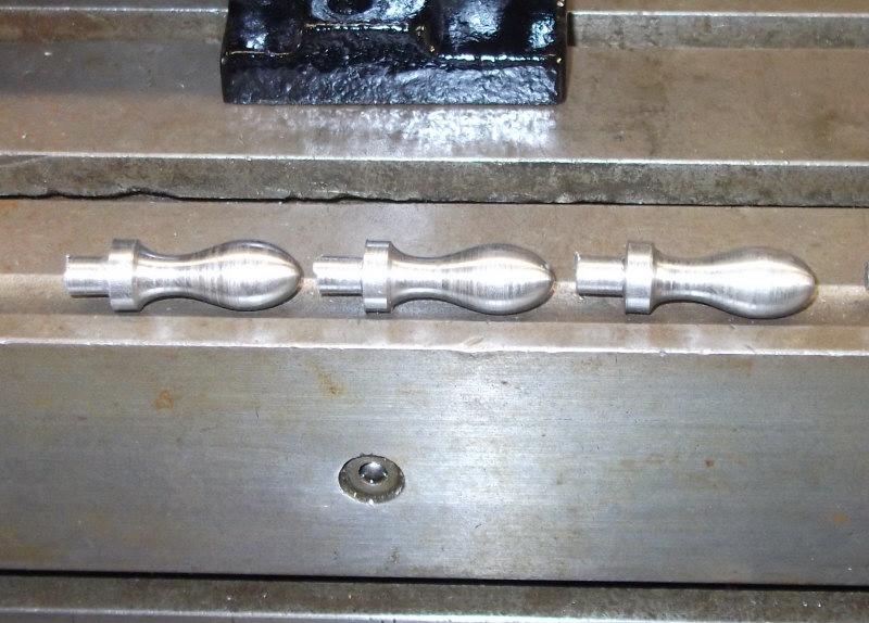

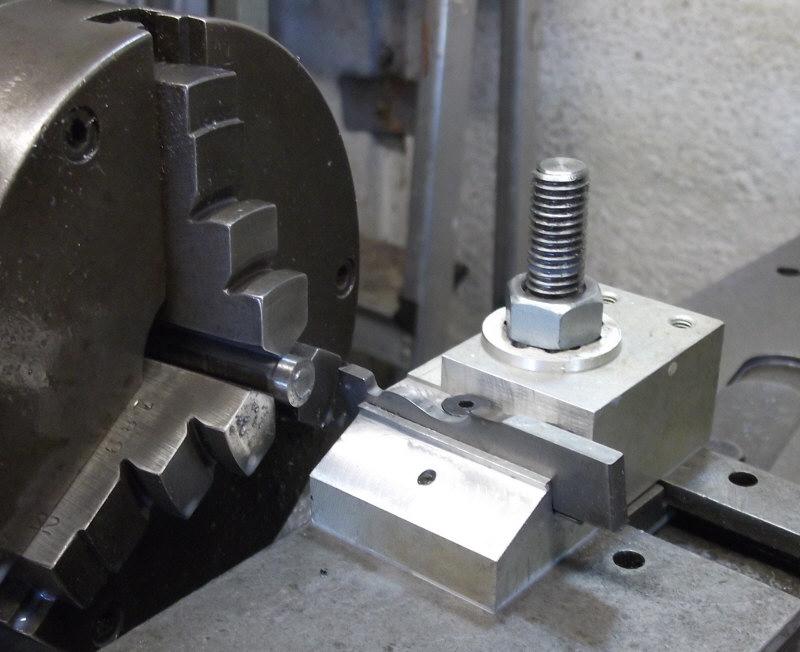

This is my experimental skiving tool in action making a tear drop handle.
Any expert skivers out there may suggest some improvements. ATM I think my rake angles are all too shallow and there appears to be a bit of rubbing, so my clearance angles are wrong somewhere.
« Last Edit: April 16, 2014, 02:00:38 PM by dsquire »

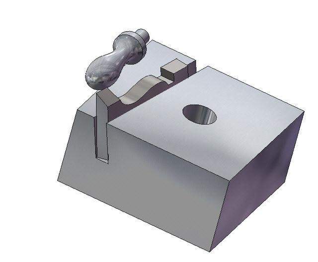

How do you go about designing and making the cutting tool?   :scratch:   :scratch:   :scratch:
The cutter was designed in a 3d CAD package. Essentially, the desired profile is projected on to the cutting tool . A picture of the tool is printed, transfered (with a felt-tip pen) to the HSS blade and then the blade is ground by hand to the profile.

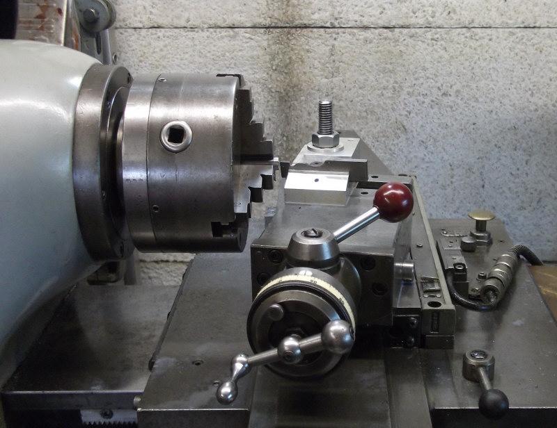

Is your lathe one of the larger, more massive models?  Could I use this technique on a Myford ML7?
The Hardinge is about as massive as a 6 x 18 comes. However, the skiving technique is a forming process that is engineered to reduce the forces on the work, so I don't see why a Myford would struggle.

The lathe turns in the conventional direction (forwards) .
The Top-slide is at an angle. I simply used it to set the correct angle for the blade.
How do you decide the angle?
All the angles are currently 'under review' for the MkII version. It should be more of a knife tool than it is ATM.
(There are a few bit on the web about skiving but very little practical guidance so I'm learning as I go)

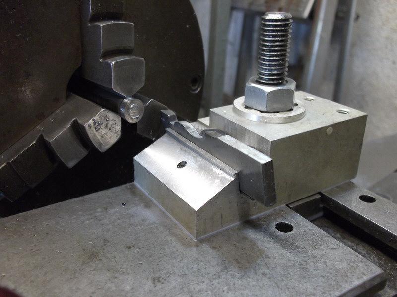

The slide movement looks fairly slow - was it operating on 'auto' or on manual traverse?  You seemed to have at least one hand free to apply cutting fluid.
The powered cross feed in the video is too slow , it actually works better at about twice that speed :)

Do I understand the process correctly if I interpret your tool  as 'progressive shear tool?
yes pretty much:)
The angle of the tool mounting makes it look like it starts at one end and finishes at the other. Is that right?
startst the piece farthest from the jaws so there's as much support in the work piece as possible.
The tool shape is the projection of half the finished workpiece contour at the angle the tool is mounted?
yes
What puzzles me as well is the clearance angles of the 'flange' part of the handles - the radial (mounting) cut.
not quite sure what you mean?  the tool clears the od of the flange completely simply because it didn't need to be cut
 the mounting spigot is cut by the same shearing procss
Still trying to get my head around why it loads the lathe so little as you say...
the cutting force is smaller because it is only cutting over a small area at a time , unlike a typical form tool .
bill

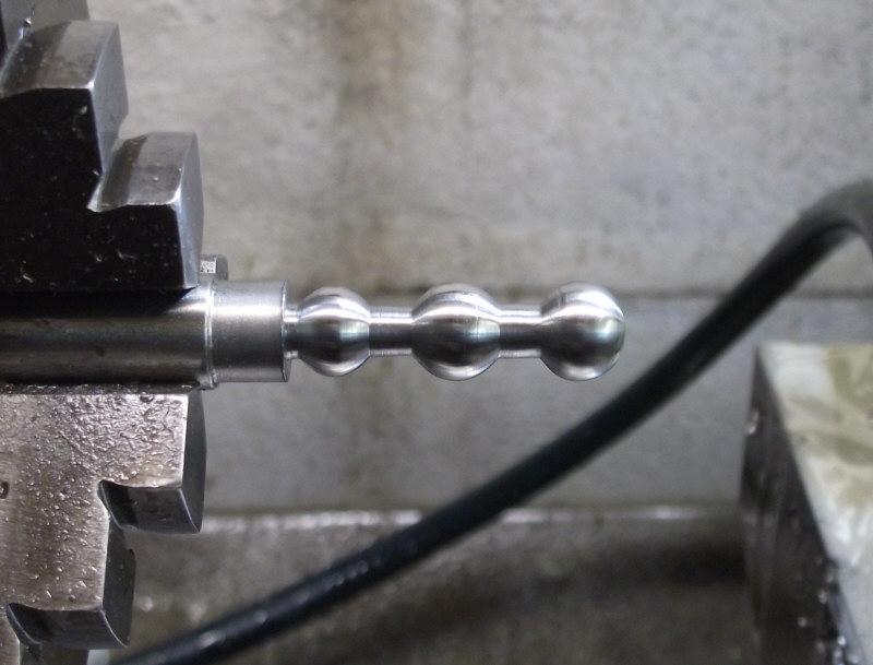

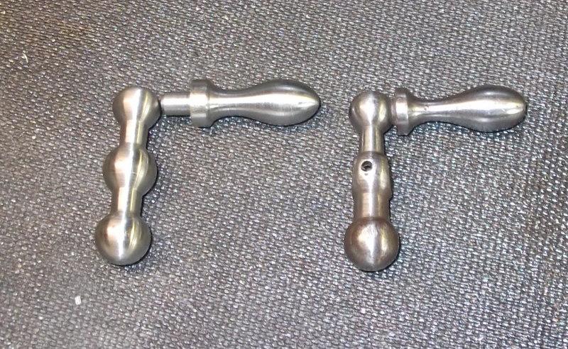

Here's the latest experiment : a tri-ball handle.
still some way to go, unlike the avant-garde shape of a tear drop, if a ball isn't round, it looks odd.

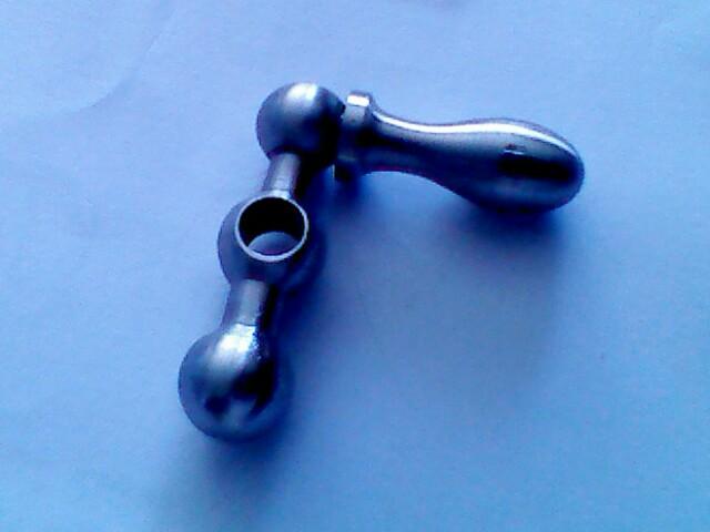

And the final part in stainless steel:

« Reply #23 on: April 29, 2014, 03:39:04 PM »

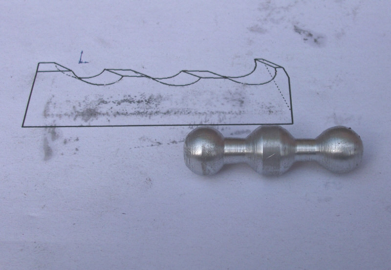

Pete,
the tool is just a blade from an old paper shear. I thought about using a parting blade. the blade holder is just a block of ally that ihad kicking about.
the shape is producd on a cad system by projecting the desired profile on to a plane at the angle of the blade.
the profile is printed at full scale and its outline tranfered to the blade for grinding (i cut out the shape and used a felttip pen to trace it for roughing out, then compared the blade to another print to fine tune the grind.
to assist getting the clearances right, i set up a grinding  rest at the appropriate angles.
most of the clearances were just ground by eye and fine tuned after test cuts.
the angles used on the tri-ball were 25° rake, about 5° clearance and 40° skive (the top slide was angled to match the skive but is not used while cutting)
the skiving technique is only really suited to multiple parts production (unlesscyou have a complex part and are very good at tool grinding!)

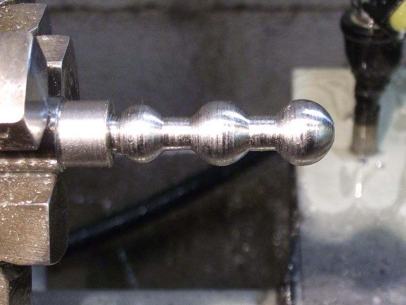

« Reply #24 on: May 04, 2014, 11:33:23 AM »
You know when you've had enough for the day when....

Re: Experimental Skiving tool
« Reply #26 on: May 04, 2014, 12:28:24 PM »
Looks good thanks for showing.
:)  you might want to look again ;-)

  • Posts: 1179
« Reply #28 on: May 04, 2014, 01:55:23 PM »
Someone we all know and love is going to be along soon and say :
CLUMSY BASTARD
....now if those balls had screwed on you could rotate them ...   :lol:
nothing clumsy about it !  you wouldn't believe the care I used getting it exactly 90° wrong:D

« Reply #31 on: May 05, 2014, 11:50:43 AM »
got it right this time...

Well I didn't notice that!! Well you could always machine it down and slip another ball on.

Or drill another hole (in the right place), fill the old one with brass or the like and make a feature out of it :))
