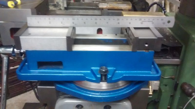

This is the large one positioned on the table to match the fixed jaw on a 6" Abwood and fitted with an alternative set of jaws with vee grooves in [ at present not in stock, this is one of the prototype vises ]

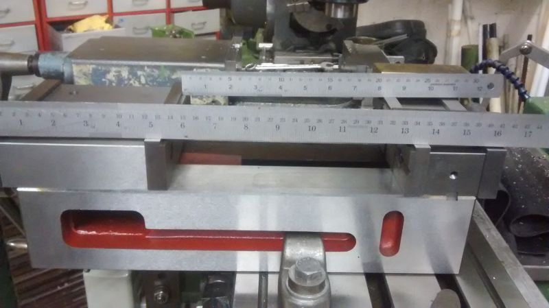

Bit of a shaky camera phone pic but this one shows the small 100mm swivel with extended jaw openings.
Actually down there today picking a couple more of the 100mm ones up and they are nearly sold out.

As is pointed out you wouldn't want to do any heavy milling in the alternative positions.
A question - I like the idea that the moving jaw is forced downwards but are both ends of the screw anchored? I would think that there would be a tendency to lift the screw. (Or does the nut run in a guide which prevents lift?)
Cheers.

Phil,
No problems, not having a punt.
The nut runs in two long slots, one on either side to stop lift and the nut on the 100mm ones is about 50mm long without going to look. Personally I think the factory has made a good job and not just saying this as i have seen and bought some crap in my time.
