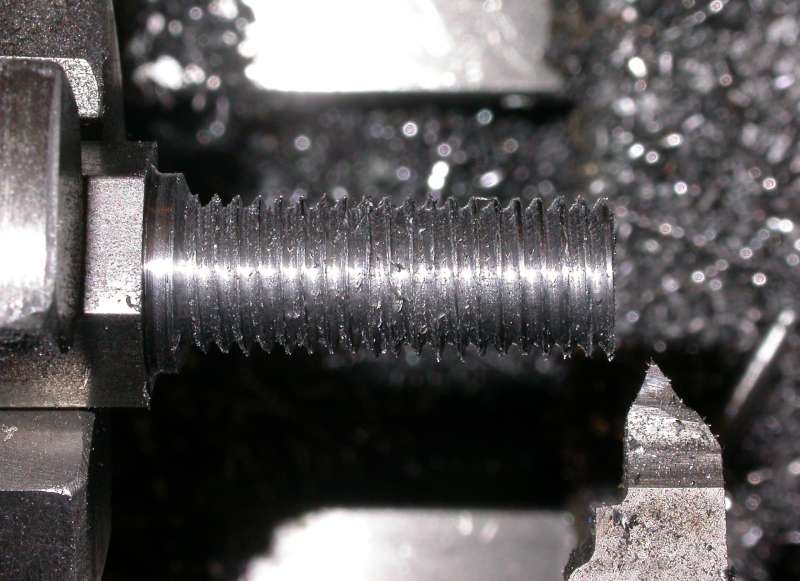

The one pulse per rev works but with limitations.
The limitation is that the spindle has to be stable and that means a big motor / chuck combination where the flywheel effect can cancel out any variation.
Where you have the mini lathes and the same ilk, that's when you have problems.
I can prove this in many ways.
One way is to run a threading cycle say 14mm x 2mm pitch and thread a length of bar about 50mm long.
Do 5 bars all on the exact same program but do one at 300 revs, one at 400 revs, 500 etc.
Then offer them up to one another and check the pitches. I can guarantee that on a mini lathe or low powered lathe, not will match.
Spent over 3 months running test with Art Fenerty when he was still in charge of Mach.
Even people who say it works don't recognise the errors. If you have access to Tony Jeffreys web site on converting the Myford lathe look at the picture he puts up on threading.
In fact i'll link to it here.
Look carefully at the start threads with a flat on the top and the end threads that are sharp because the pitch error has removed the lands.
Tony didn't realise this until I pointed it out to him.
IMHO using Mach or any system that relies on a single pulse encoder is not the way to go and believe me I'm a big fan of Mach.

John S. is right, but it is not the single index pulse that is the culprit.
Mach3 has several (waitfor, leadin, leadout, one more..) bugs in the threading cycle, that show up or not, in different ways (seeen 25.4 times easier with metric).
Also, probably all or almost all simple schemes have a *bad* index pulse. It is "fuzzy", and often not consistent, and thus leads to garbage-in, garbage out.
We conclusively proved this on my 12x lathe, with a 0.2 micron step size, running a servo with about 1000 kg lateral force on Z.
We did logging at 633Mhz with a centipede hw board, with nanosecond ! resolution pulses getting into a log file.
After this, Sergey K of Centipede did a new hw board, that gives a cleaned up, triggered, clean, single index pulse.
This is the index board on sale at his site.
This then enabled proving some of the Mach3 bugs, and eventually overcoming some/most of them.
A cold lathe, in the morning, ran at 530 rpm. A warm one about 540 rpm.
A single threaded groove would track within or inside 0.01 mm, in a cold lathe, when the groove was done on a warm one.
This proves that a single index pulse *can* perfectly track, in varying conditions, a single thread.
We used old copper on one test, where the groove was very bright, and a 0.01 mm variation out of groove was perfectly visible.
