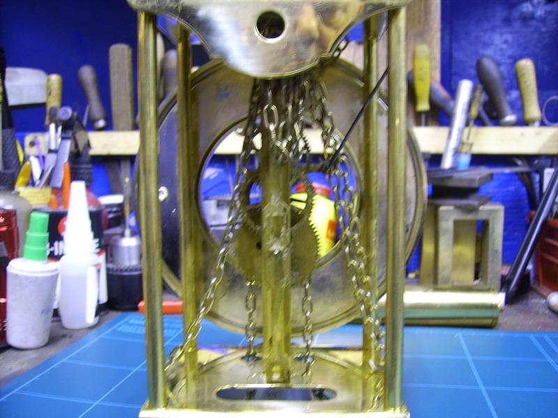

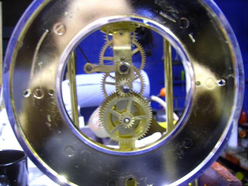

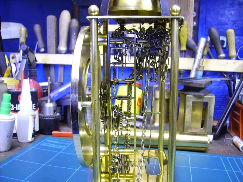

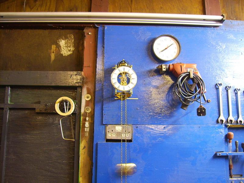

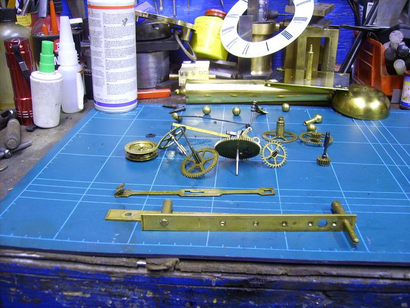

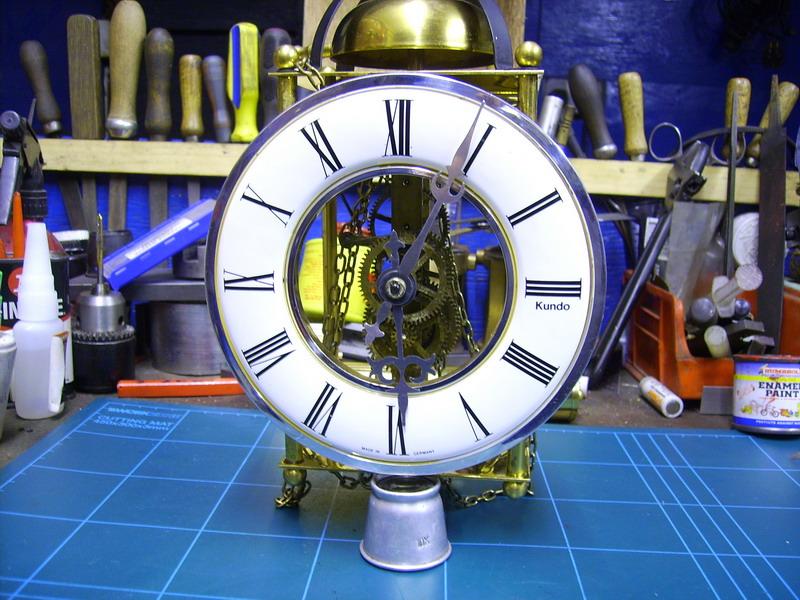

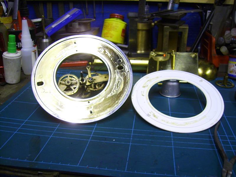

hi all well this kept me biz at the week end its a skeleton clock one of them cheep and nasty ones it had stopped working as the movement got gummed up with old oil and nigaten not a strait forward job to dismantle as the movement is held on to the dile backing plat witch is plastic and the dile is plastic to after sum cerfull levering i manged to remove the dile to get at the two screws to get the movement out gave it all a good scrub up put it back together this time using double sided tape to hold the dile back in place hung it up on the workshop wall and its ruining nice right pics

Your skillset always amazes me. :clap: nice repair and clever trick with the double sided tape  :proj:
