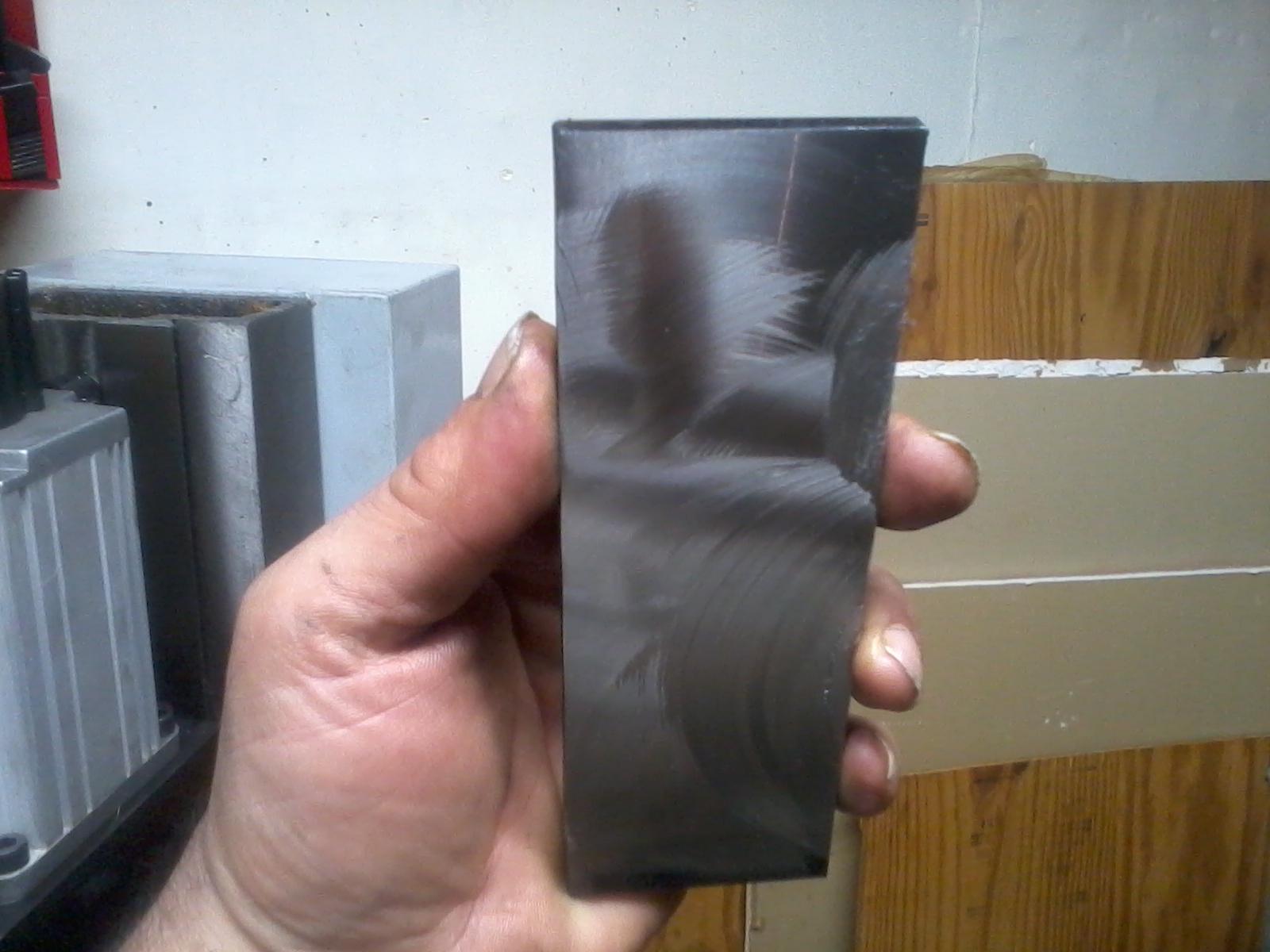

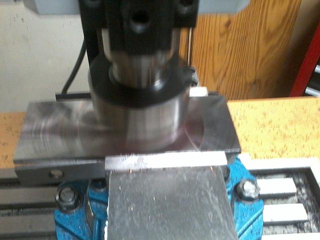

A couple of weeks ago in accordance with my plans to upgrade the column mount on my MicroMark SX2 I also ordered a dial indicator at a too good to be true price off Ebay.  It was indeed too good to be true.  The clamps that came with it were the wrong size.  I next obtained a fits all clamp from Sharf.  LoL, it did fit the indicator, but not the rods I had.  The vendor that sold me dial indicator has of course promised to replace all, but that was over a week ago and I am still waiting.  Meanwhile the project to epoxy the SX2 column completed.
I have a digital inclinometer and with that I can tell if my column and the spindle is 90 degrees or not, and it implies my table is also, but I didn't trust just that device.  Waiting for a mailman who may never come is frustrating.
Then I pondered it and I realized I still have a tilting column and the best indicator of a machine subtly out of tram is from examing the pattern produced by a fly cutter.  I had some 1/4 inch hot rolled steel stock scrap.
My thought was why not see set it up as best as you can with the inclinometer then run a fly cutter over the steel stock and check the pattern that results?  So I did.  A terrible pattern.  However this also gave me a chance to play some more with the modified mill.  Different speeds, different feed rates, etc.  It isn't like I had ever before successfully worked HR steel without problems before the column mod.  If nothing else I confirmed the inclinometer at least put me into the ball park, even if the fly pattern showed I was out of tram.

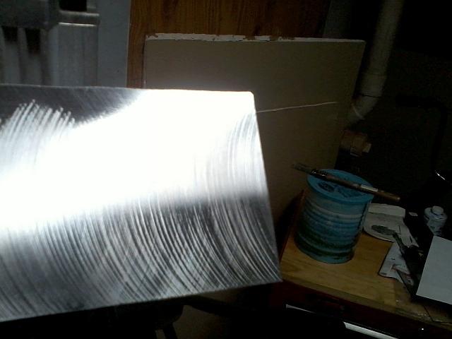

Tonight I hit upon a redneck solution involving a ballpeen hammer instead of the usual plastic mallet and multiple passes with the flycutter.
I ever so slightly loosened the column nut and ran the flycutter into the center of the piece, then gave the top of the side of the column that was cutting the most a tap with the ballpeen hammer then finished the pass and examined the finish.  This went on for awhile, left side, then right, etc.  The passes were shallow because the only goal was to create a flycutter pattern to examine.
After about 10 gentle but firm taps and passes I found a sweet spot that produced cutting on both sides of the single blade flycutter.
I then locked the column down tight and did an entire pass with that column setting.
A perfect flycutter pattern.  I believe my machine is now properly trammed on X axis.  Tomorrow I will spin the vise around with the other side of the plate and see what happens on my Y axis.  I will also make a cold chisel mark on the column and base so I can always quickly land near the sweet spot again if I have to move the column.  The finish of the experimental piece is probably about as close to mirror as a mill can make it.

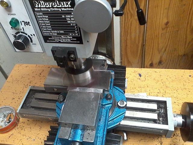

For those wondering, since hardly anyone just sells pre-cut 3/8 inch HSS fly cutter bits and all of my efforts to grind one of my own have failed, I used a store (Micro Mark) #4980L 8mm lathe bit.  Left hand bit tightened down upside down into the fly cutter.  It was loose of course.  So I tightened a single edge razor blade edge down into a workbench vise, then snapped the back off with a big hammer.  Snapped clean.  I took that piece of steel back and it fit perfectly alongside the lathe bit in the fly cutter.   :)
Hmm, it probably isn't the approved fly cutter shape, but I can report (as the photos show) the cheap 4980L mini lathe bits work perfectly in the Micromark fly cutter on hot rolled steel.  I may buy some more of them.
I have a tachometer for the mini lathe.  Hooked it up to the SX2, took readings, and then marked them on the rheostat box.  No need for a tach now 'cause that effectively gave me a speedometer.
I know, I was supposed to run it at about 430 RPM and 8 feet minute feed.  That worked, but in the real world so too did 6-800 RPM and about 5 feet a minute hand cranked.  Just slow and steady.
So will an SX2 with an epoxied column cut steel plate?  Oh heck yes.
Biggest problem I am encountering with the SX2 now is the small size of the work aperture.  That steel plate is about 6" by 2.75" and in order to fly cut it I had to take the big Sharf vise out of center position, insert the fly cutter (only 7" of Z room), then put the vise back.  Of course that business with moving the vise first wouldn't be needed on a full size machine.  Likewise I needed 3" on either end of the 6" steel plate for the fly cutter to fully exit the workpiece.  Unfortunately my SX2's bed travel is only 11" along the X axis.  One end suffered and did not experience the full fly cutter effect.  Likewise, although I was kicking around the idea of flycutting the piece along the Y axis to check that tram, since the bed travel is only 4 inches and I should have 3 inches on either side for the fly cutter to exit, I realize now that test can not be run on this machine as I will not have even one side clear enough for the flycutter to exit along the Y axis.  Even doing it sideways and with only one side fully exiting, I would need at least 6" of Y travel (probably more if you take the vise footprint into account).  Durn shame.  T'would have been a good easy test of Y axis Tram.
I have a faint suspicion that my mill head leans inward just a hair.  If you look at the plate you see the flycutting looks fainter along one long axis.  That was the side near the column.  I have read many webpages where folks found Y axis issues with their X2 heads.  Aluminum foil fixes and all that.  I had the head off yesterday morning while I was playing with the quill gear (shaft was very grungy and the fine adjustment had been sticking and no, it isn't necessary to remove the column to detach the head or remove the quill handle/gear) so I see where the shim would go, but sheesh, couldn't they have done that at the factory?  If they didn't want to put it together right (or polish out the tool marks on the gibs) why didn't they just drop the price a little and send us a box of loose parts as a kit (as Jinma did for my 8" wood chipper a few years ago, a 5' 3/4 ton crate of metal parts with instructions for assembly written in Chinese)?  Yeah okay, maybe a head shim is in my future too.  Don't know yet.  For 99% of anything I anticipate doing here the fact that the mill head is possibly the thickness of a cat fur off in angle at the bed really won't matter worth a durn.  Trust me, the lawn mower won't care.    :)
But anyway, the X2 work aperture is small, but I have no room (or funding, or electricity for a real machine (LoL let's crush the basement floor with a real machine, NOT).  Still for well less than a $1G it is a durn nice accessory for any work at home mechanic type.  There is just so much to learn with it.

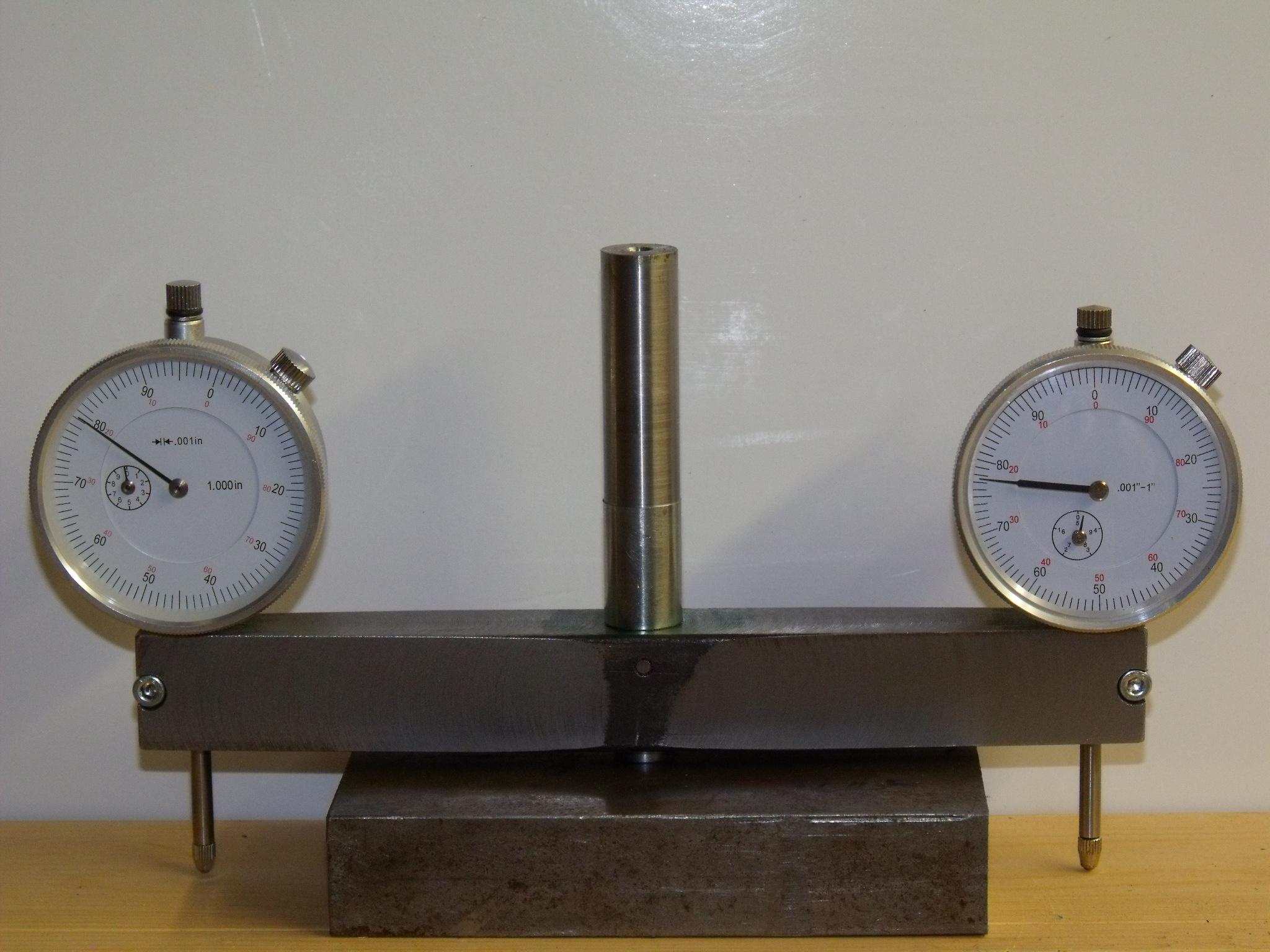

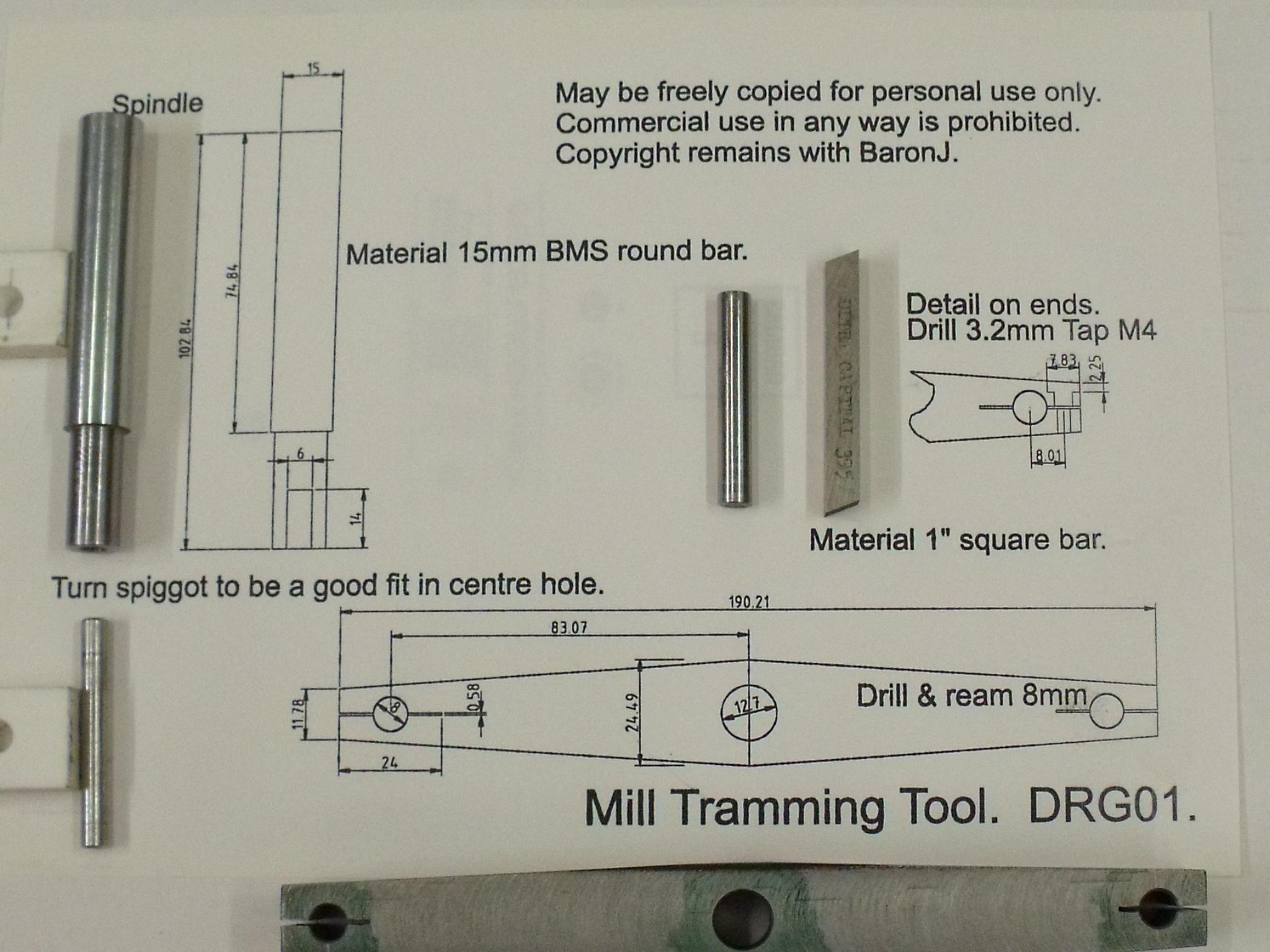

I'm one who set to and made my own !  It terms of money £20 plus some time.
In my case the supplier of the dial gauges sent two slightly different ones.  Apart from the differences that can be seen in the photos, the stem of one was 1/4" longer than the other.  It doesn't actually matter if they are not exactly the same stylus hight since you just rotate the scale to get a zero reference.  Obviously you have to calibrate each gauge but that is very easy.  Indeed all you need to do is pick a point on the machine table and set one gauge to zero. Rotate  the whole lot 180 degrees and zero the other gauge with the stylus at the same point.  From this point on any head tilt will be shown on the gauges.  One will be plus something and the other will be minus something.  Now all you have to do is move the head until both gauges read the same.
Best Regards:
Aha! I had not thought of the rotating method of calibration. And I see now that when you say "both say the same" they may or may not actually show "0". Somehow I was thinking they would both be zero'ed when the tram was done, and that is why I couldn't see how it would work. Thanks for the explanation. I now see this would indeed be handy, and if one had a pair of indicators of similar size rather easy to make. Faster than my method of rotating a back plunger indicator from side to side, for sure. And I presume the longer one would make the center bar the more accurate the tram would be.

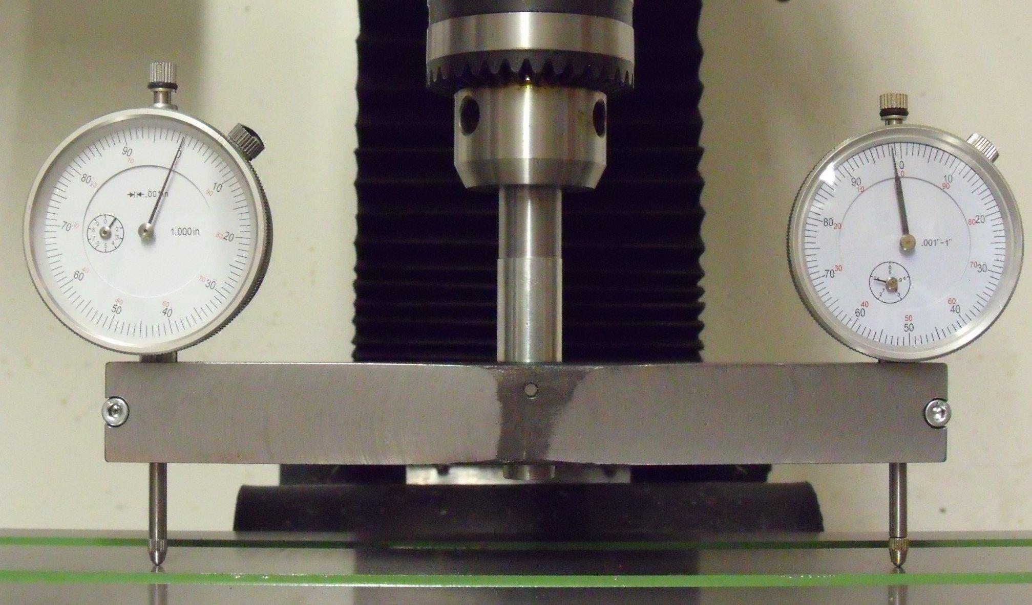

Its true that the longer the bar the more precise you can be !  But, there is always one" if you make the bar too long, you rapidly run into diminishing returns, because you are then trying to tram to fractions of a thou.  I chose 8" simply because I had a piece of 1" square black bar that length.  If I was doing it again I would have made the bar 6" in length because my mill table is 6" wide and it would have made checking for nodding easier.  As it is I take two readings with the bar set as far diagonally across the table as I can.  Then rotate it the other way and re check.  My mill nods about 1.5 to 2 thou forwards.
One other thing to note.  I originally drilled the ends for 8mm indicator spigots.  the ones supplied turned out to be 3/8".  I've since purchased another one.  0.01mm and this one is 10mm diameter spigot.  Which since its a metric gauge I suppose would be correct.
