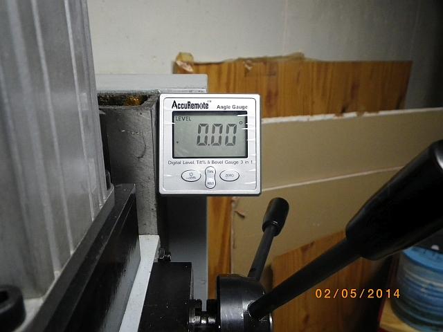

By the way, while waiting for the epoxy to cure an inclinometer I had previously ordered arrived in the mail.  Out of curiosity while tramming i brought it into play.  You can imagine my amusement to learn that the people who added the protractor to the column mount did not check the placement of the protractor scale.  Loosely summed up, the two differ by a full degree.
Inclinometer on the mill's spindle says
But the built on protractor scale says,

I looked at those on LMS.  I do like having the option of tilting the mill head even if I never do so.  So with both the epoxy fill, and or the T backplate I would keep the option your method would take away.  In the case of the T shape backplate simply removing the bolts on top would again allow the tilt if someday I had a job that needed that option.
BTW, regarding the angle of the spindle and the contradicting indicators one of the thoughts I considered was maybe the spindle head is canted on the column and that is why the column gave one reading but the built on scale gave another?
So I put the meter on the column top and from that experiment which produced identical results to the reading on the spindle I now know either the scale placement in the factory was a degree off or the column is curved, but my T square edge shows no evidence of that either.  Recall!     LoL  Nah, I don't care as long as I know about that.

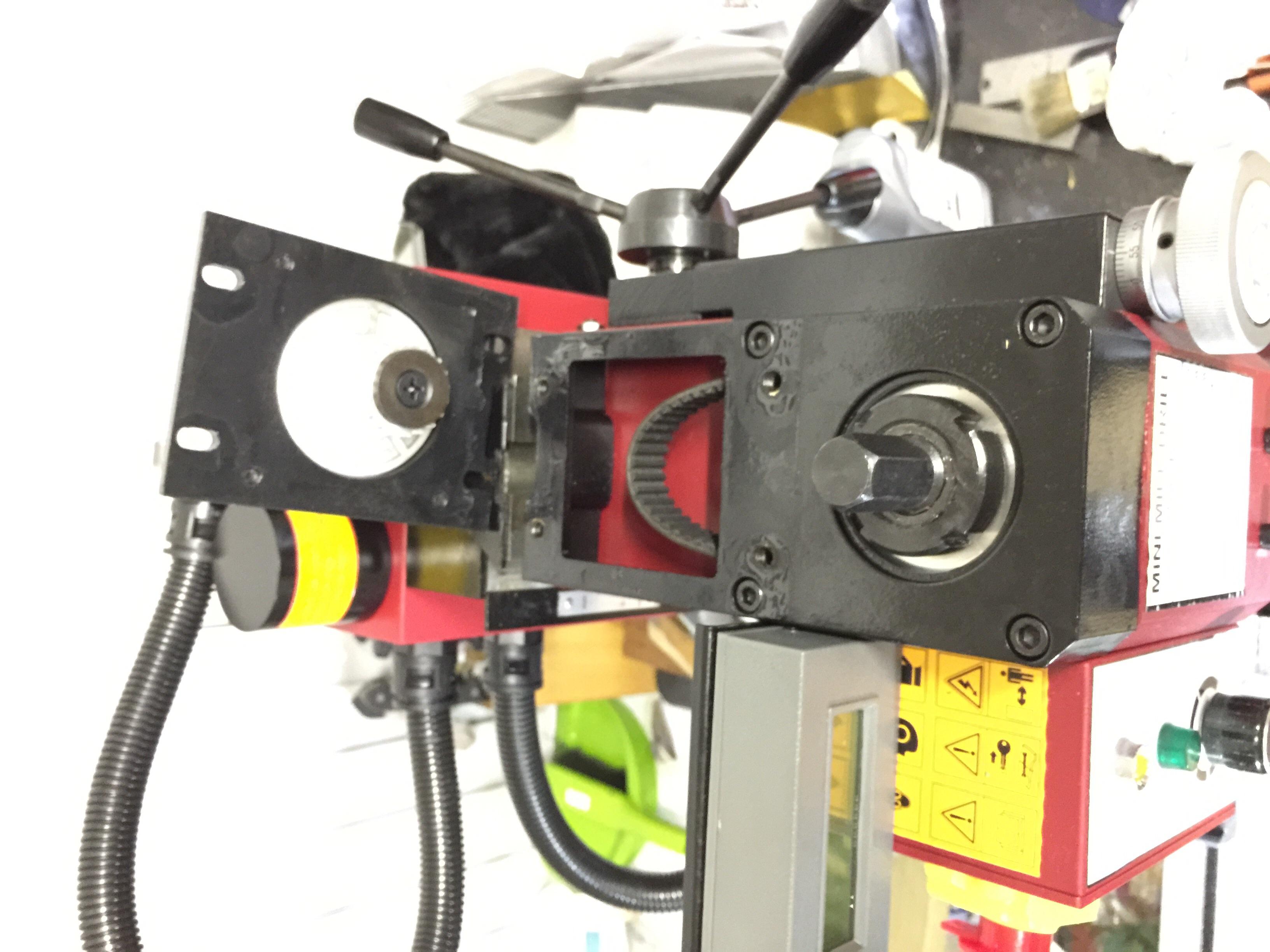

I bought my SX2 with the fixed column option (from Sieg factory, via local company here in Singapore). When taking heavy-ish cuts, it still is very loud. It sounds like it's vibration coming from the electronics box, but I'm not sure. I've been thinking about filling the column with epoxy and gravel too, though I have absolutely no idea if it will help any..
The other thing that is very annoying is the head drop issue, which I need to look at too.
Hi teegee
About the loud vibrating you talk about, i noticed that too, not sure of course it is about the same.
The noise seemed to come from the upper side.
While converting my sx2p with r8 spindle to tapered upper and lower bearing, i noticed a possible (likely) source.
The motor is attached to a plastic cap of the tooth-belt, and the cap itself is attached to the head with four bolts around the spindle pulley.
See photo's.
The motor side of the plastic cap is not bolted to the head and what i think while heavy cuts the motor will go up/down and slamming on the head causing very loud noise.
Offline teegee
  • Posts: 6
  • Country: sg
Re: Yet another guy tries to fix his Sieg SX2 looseness
« Reply #37 on: January 29, 2015, 02:37:32 AM »
See photo's.
Hah, I saw your comment by coincidence. Thanks, I will definitely keep an eye out for that the next time it happens. You may well be correct, in which case it should be possible to feel the vibration, and pushing on the motor should make some difference. I already ruled out the electronics box as the source.
Cheers, Rob
