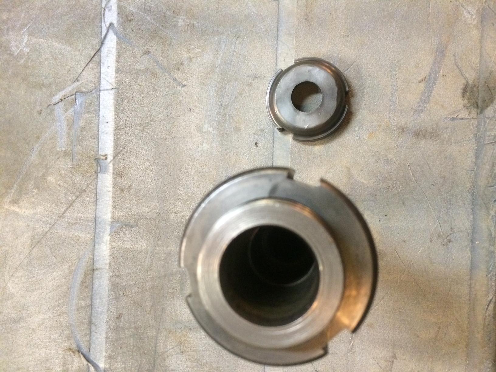

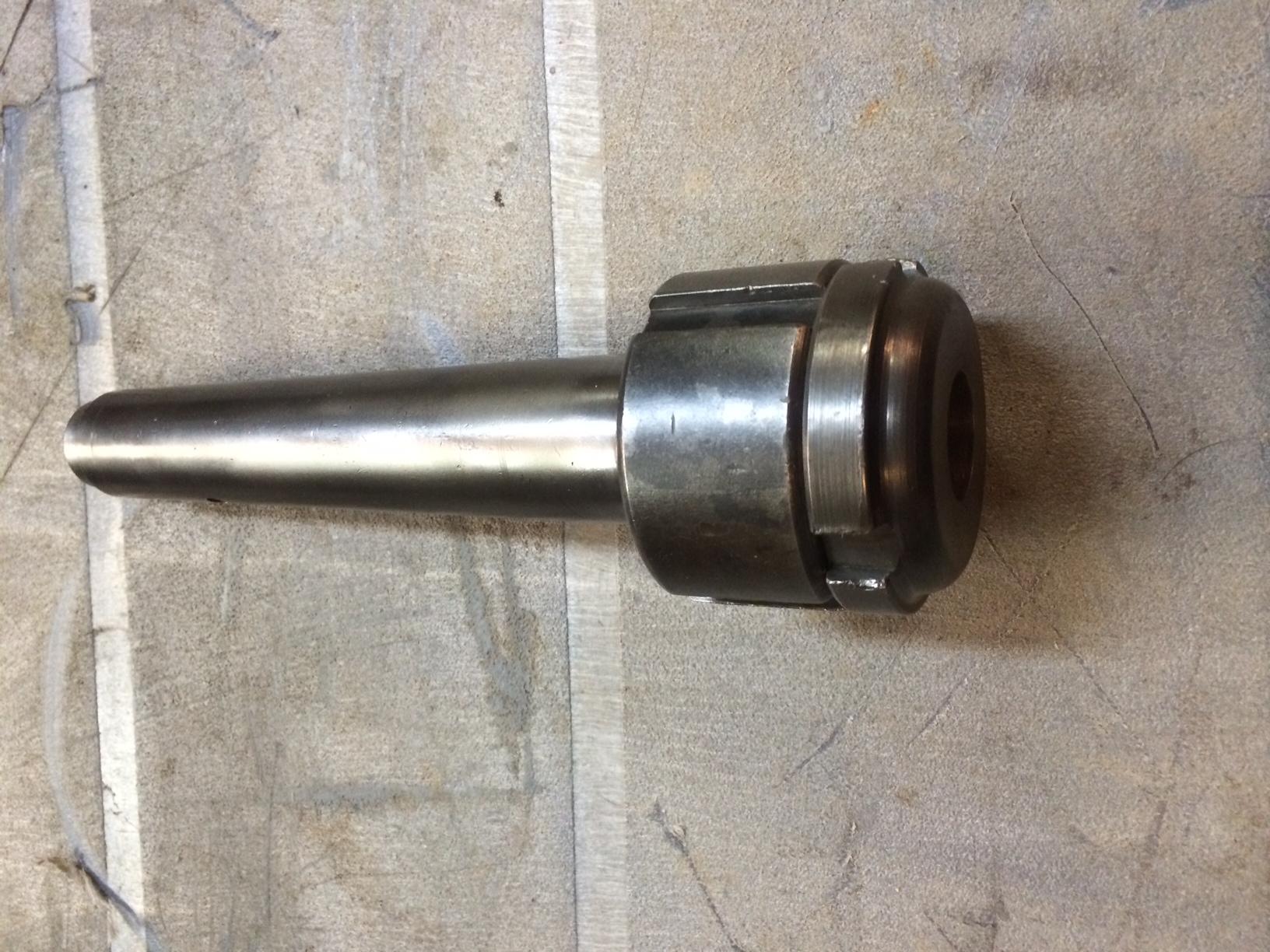

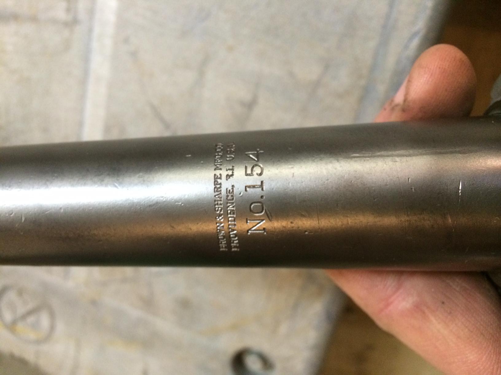

I picked up an old Inedx model 45 mill a few weeks ago it has #9 B&S taper and came with a few boxes of tooling. It came with a collet chuck that didnt have any collets its a B&S No. 154 and im wondering if someone could help me out as to what collets it takes.. Thanks much

There are quite a few collets on ebay . " Brown & Sharp Collets " . This might give you some idea of what collets you require.
Good luck David
Google Brown & Sharp Collets, comes under web results.

Dennis, I think the company is now called Wells-Index. You might try an email to them at
wellsindex@aol.com
. Their website is at
http://www.wells-index.com/
Regards,
Rudy
Logged
TLGriff
Jr. Member
Posts: 89
Country:
Re: Some info on the would be of great help!
Reply #6 on:
February 10, 2014, 06:10:00 PM »
Dennis,
Another option to consider is that Wells-Index will regrind that spindle to an R8 taper. There is a lot more tooling available for the R8 than the B&S #9. I think they charge about $250.
Tom
Logged
volcom7114
Jr. Member
Posts: 14
Reply #7 on:
February 11, 2014, 12:07:39 PM »
Thanks Tom and yes they will regrind the spindle for 285 plus 80 for a new draw bar and they also want it shipped to them in a hand made wood box and you have to pay shipping their and back of course so prob looking at around 5-600 bucks but on the good side to it is all your B&S tooling will still fit as they said their will still be some B&S taper left in the spindle but he said you wouldnt want to do have side milling as their would be some slop in the collet/tool holder around the bottom of the spindle so to me it really makes your B&S tooling useless for anything other than a drill press..
