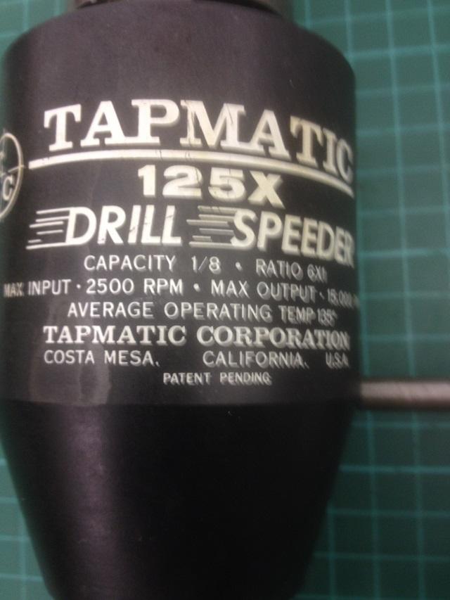

I have a Tapmatic X125 'Drill Speeder' - basically an axially mounted gear box that multiplies speed by six times up to a maximum of 15,000 rpm. I used to use it with my Bridgeport Interact to drill PCB's as the tiny drills need high speed. I also used it for engraving.
Recently I've dug it out of the cupboard to change the shank to CAT40 for use on the Partsmaster for the same applications and thought it'd be a good idea to re-lubricate it. However there seems no provision for this, nor is there any reference to the device on the Tapmatic web site that I could find (I've emailed them but totally unreasonably they are not working on New Years Day !)
Has anyone any knowledge of these devices?

I had a nice email exchange from a chap at Tapmatic today. He says he eventually found the device in their archives dating from the 1970's  :coffee: He reckons that after 500 hours use it needs stripping down, examining for wear and re-lubricating sparingly with a high melting point grease. It's certainly done nothing like 500 hours whilst in my tender loving care and in all honesty I can't remember where I got it from  :bang:
