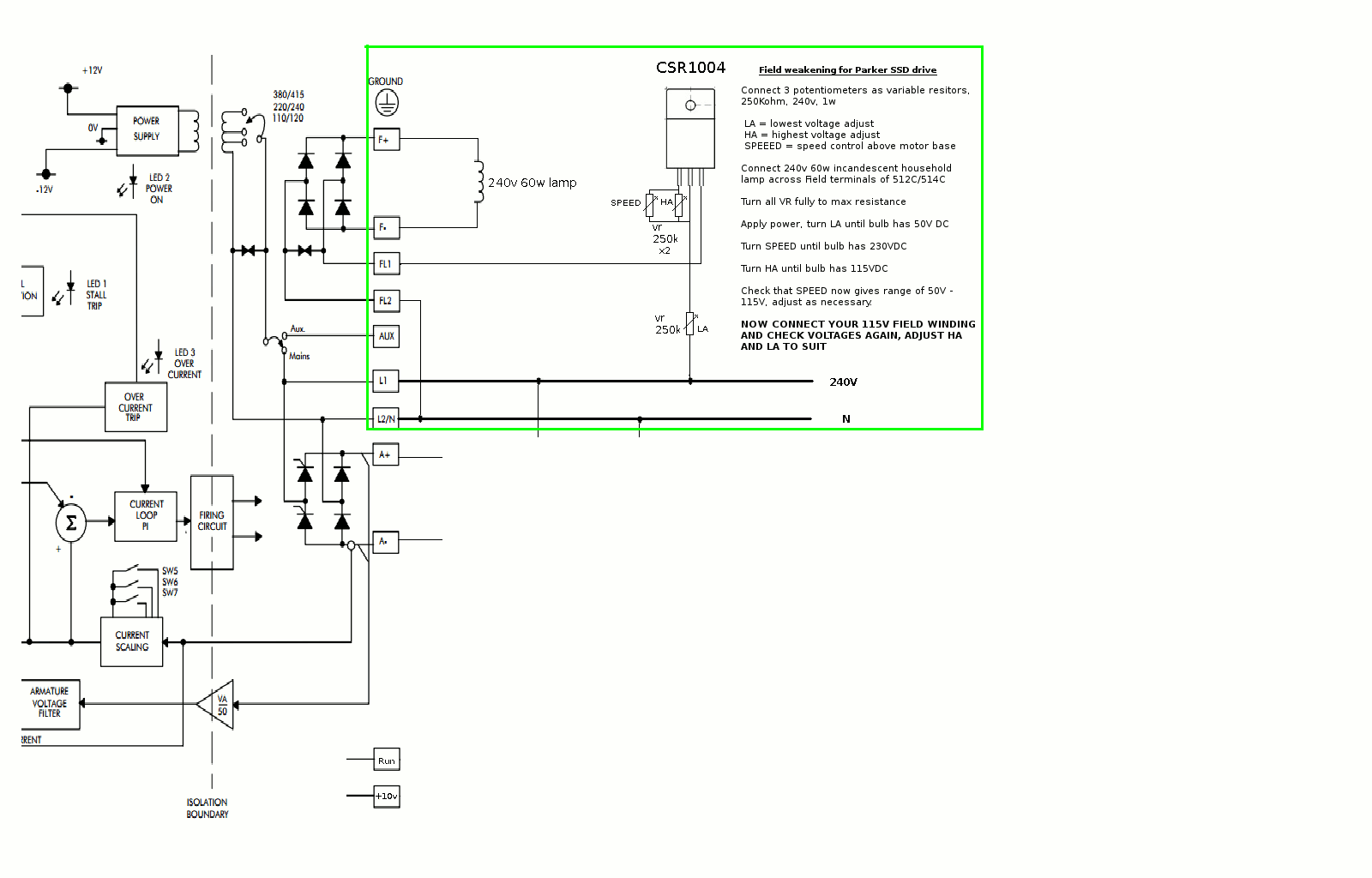

John you need a phase angle device and a rectifier. I use this to control the field voltage on my 3hp DC motor. You'll only get about 190VDC though.
The CSR1004 is the phase angle chip and will output 0-240VAC at 10 amps. You feed 240v into the middle leg and the right leg into a 10A bridge rectifier, other side of the rectifier to ground. Hook a 250k 1w variable resistor between the left and middle leg and this will give you zero to full speed control. You don't need the three pots as shown on my drawing, that's just for limiting the output from 50-115v on my lathe. A single control pot will do.
