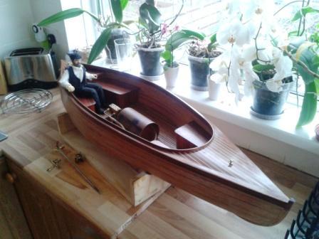

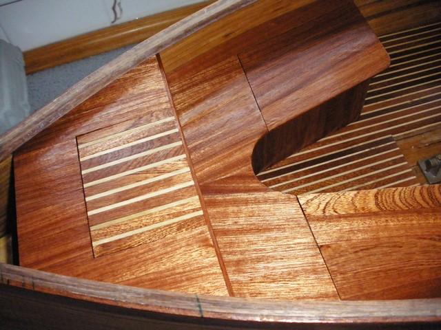

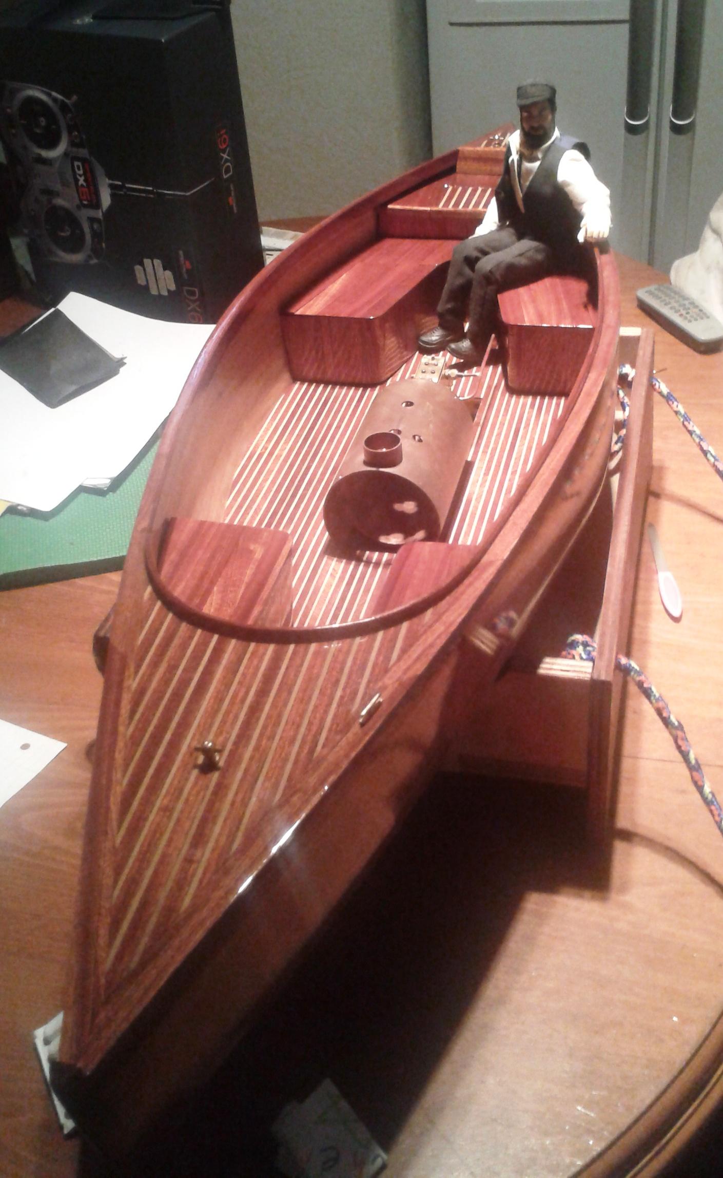

I enjoy both metal work and working with wood so this little project has allowed me to indulge.

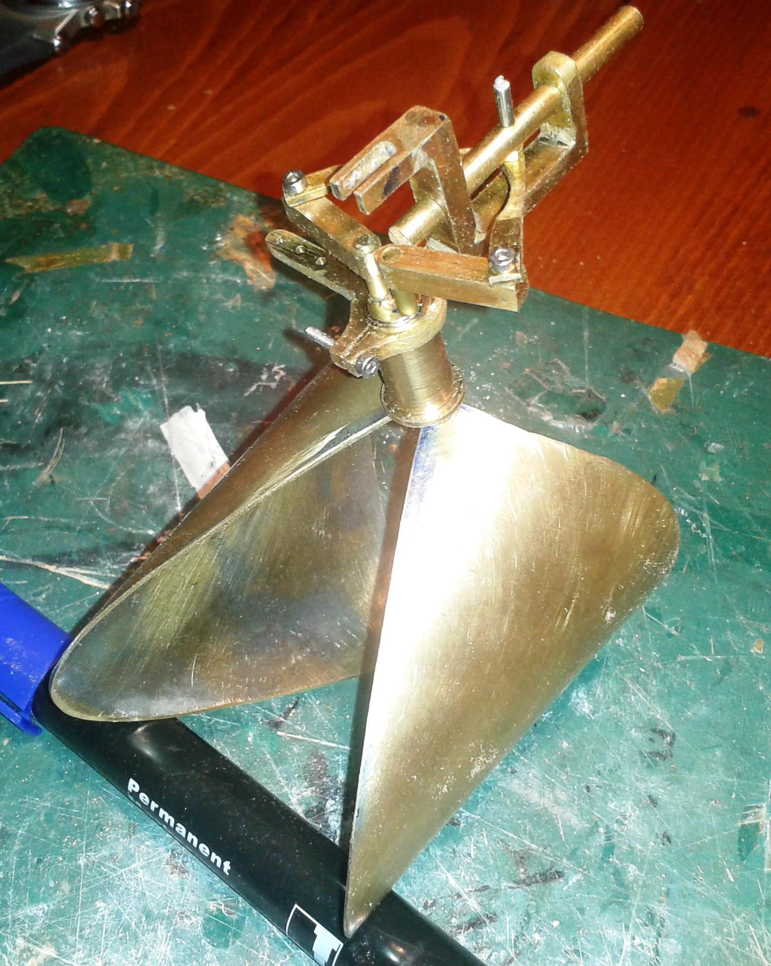

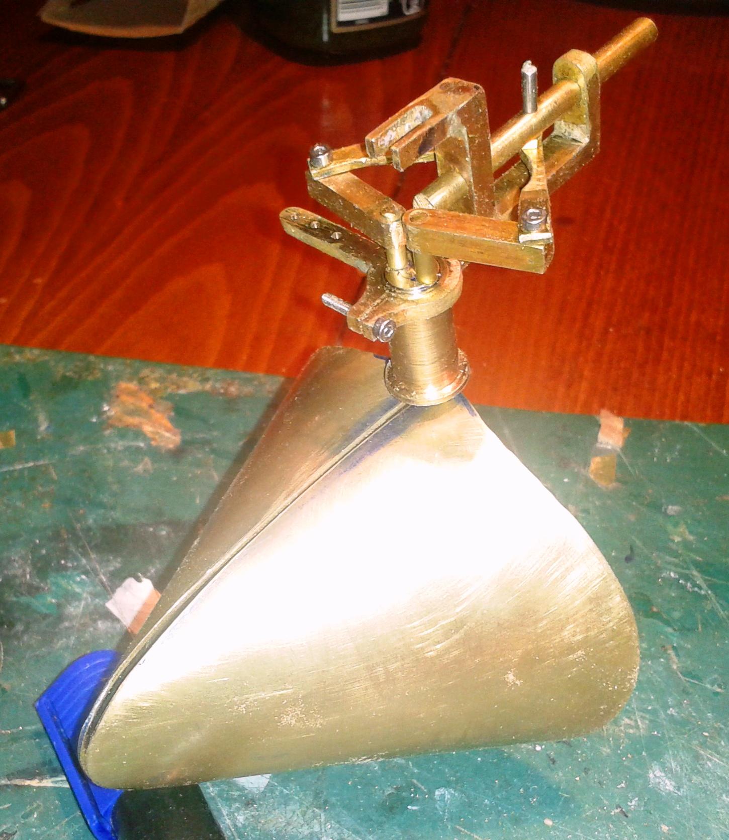

This is the Kitchen rudder I am working on at the moment. In the reverse and full ahead position.
Re: Model steam launch project
« Reply #4 on: December 15, 2013, 10:32:26 PM »
I am a neophyte... Can you explain how that rudder works?  :scratch:
« Reply #5 on: December 16, 2013, 02:12:40 AM »
That is a strange setup!  It looks to me like it runs in the open position being steered by the linkage on the left side as two seperate rudders that can be closed like a funnel that could provide some stopping power like a reverse thruster on a jet.  But what the h do I know! :scratch:
Offline steamup
  • Posts: 63
« Reply #6 on: December 16, 2013, 11:18:03 AM »
The rudder is not finished yet which might be causing some problems trying to work it out.
The cups provide forward and reverse control, if the cups are part opened the boat will in theory stand still in the water.
The whole mechanism rotates for direction control. I still need to add the leaver which operates the scissor levers,which in turn open and close the cups.
Hope this helps
Mark

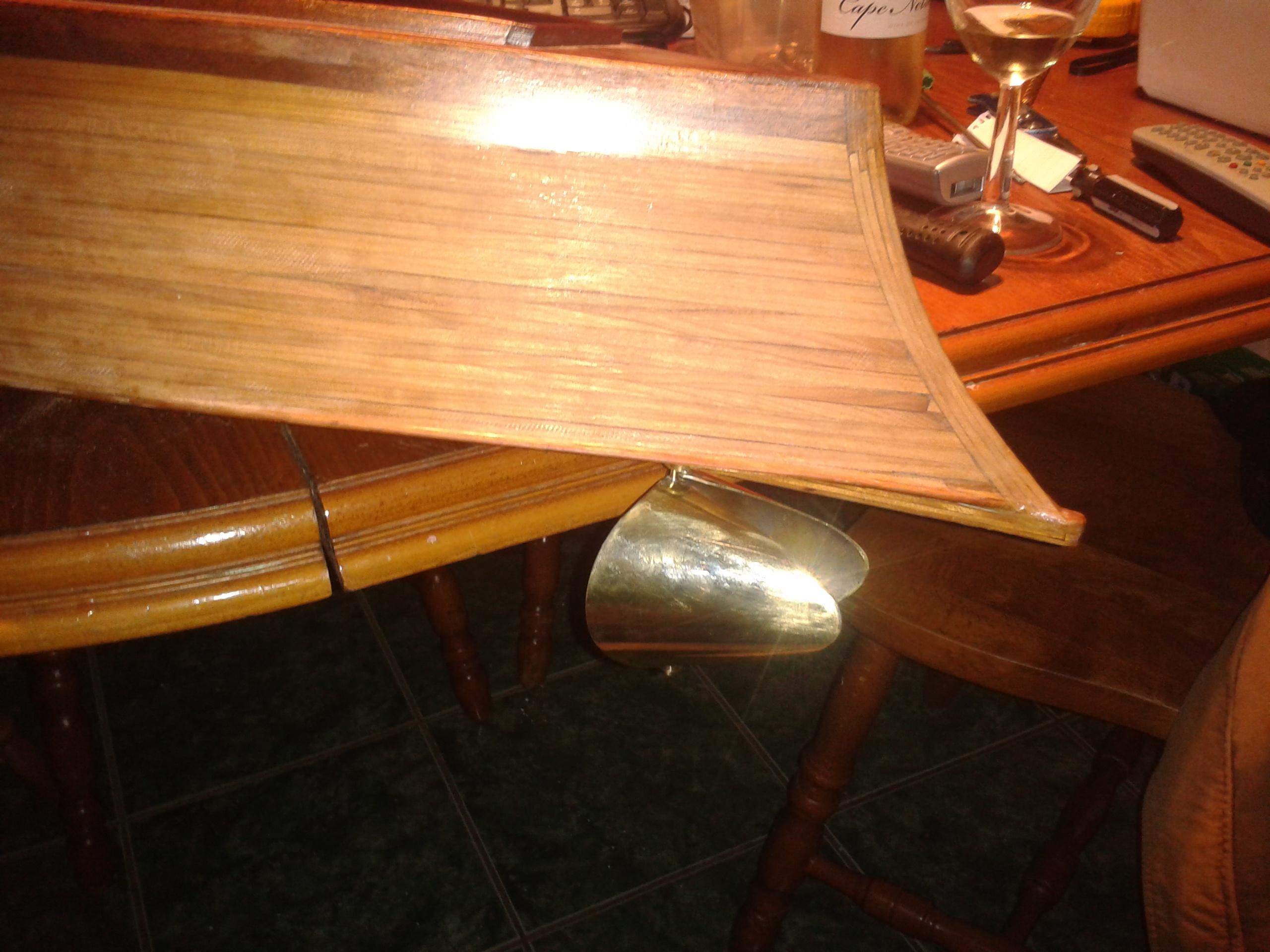

Just tried the rudder in the launch.
Next job is the A frame but the bottle of Cape Nelson stopped progress.
