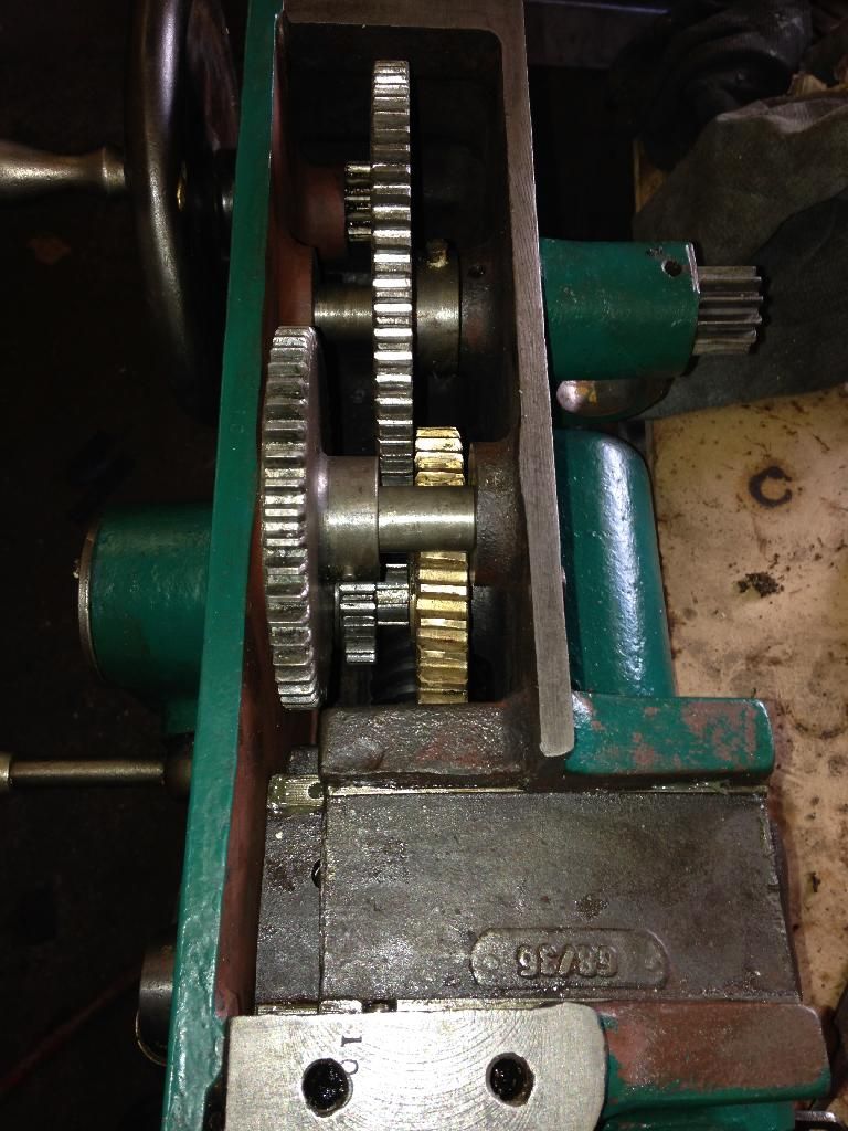

havent got pics of the apron before but needless to say it was the same story in there as the headstock. the apron is supposed to have oil in but some one had decided that grease was better  :Doh:
after a clean
http://i80.photobucket.com/albums/j183/dawesy_2006/lathe/E6F4658E-104F-47AF-942B-28E8662F762A_zpsvw195xun.jpgtidying up my churchill redman CM lathe
http://i80.photobucket.com/albums/j183/dawesy_2006/lathe/4E15EBBB-1A4B-4878-A0F9-0D7230309D8D_zpshpyxjiqr.jpgtidying up my churchill redman CM lathe

the carriage
