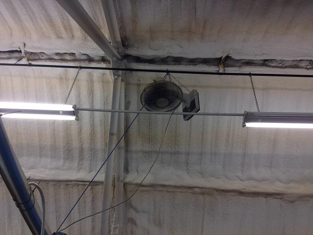

I have the luxury of central heating in my workshop. It's oil fired and runs three fan assisted radiators mounted at about eight foot high on convenient steel truss beams. However there is a further about eight foot to the apex of the roof. Recently climbing on top of my Traub lathe to stash some spares away I was amazed how much heat there was up there under the spray foam insulated corrugated fibre reinforced cement roof sheets.
In an ideal world the fan assisted radiators would have been up at the apex, but they are not, and I'm not moving them now so how about a 'downdraught fan' . Apparently these are called 'Destratification fans' in the industry, and the fancy name comes with a fancy price tag.
As an experiment I've rigged up an old 45 watt desk fan dangling from the apex, and initial findings are that it works. It's crude, it looks odd, but it may stay there for quite a while  :ddb:

Just done some measurements with an infra-red point type thermometer. Before the fan was turned on I was getting 26 degrees C on the roof insulation for a thermostat setting of 17 degrees C at 5'6". Now with the fan running the roof insulation temperature is 19 degrees C. That must be quite a large saving in heat losses through the 3" of sprayed insulation. Also I suspect that it is not fully airtight at the apex.

The boiler has only fired up once in the time since I fitted the fan and the workshop has stayed at the programmed 17 degrees C - ceiling temperature seems to be staying fairly constant at 19 degrees along the full length of the apex so the fan is obviously drawing warm air along the apex and then downwards.
Far more effective than I was expecting - I suppose really I should put a thermostat up in the gods and control the fan off that but access is a pain

you need a couple of the large Dia. slow speed fans that you have in these posh conservatories should be able to source some on the bay  get the biggest you can get run them slow as not to set up a circulation current

Andrew, you might check the power consumption as you look at the ceiling fans. Some models are extremely efficient. For example a 52 inch Hunter (the inventor of the ceiling fan BTW)  specs.
67 Watts HIGH, 26 Watts MED, 9 Watts LOW
Airflow Cubic Feet Per Minute (CFM): 4827 (High Rating)
Airflow Efficiency: 72 CFM Per Watt (High Rating)
Joe
